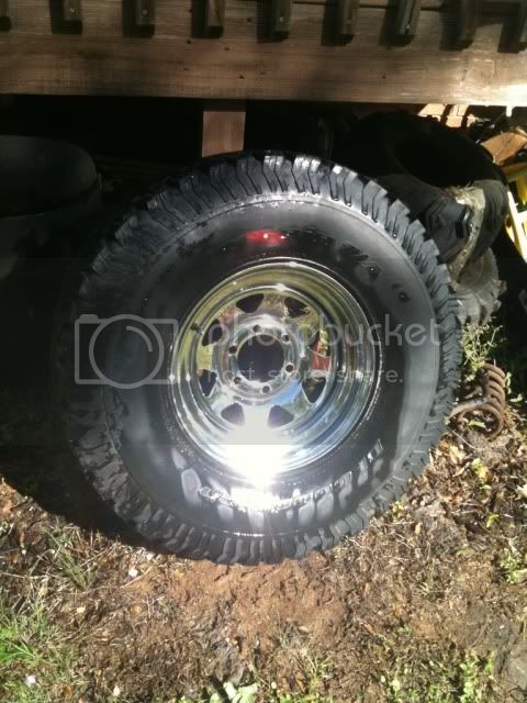

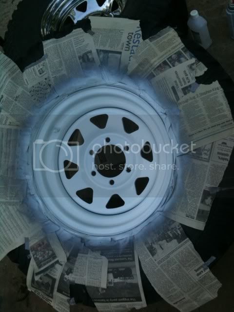

Found some 315/75/16 BFG ATs and some steel rims for a good deal so I went and picked them up last Monday.
I was able to clean them up over the weekend. Above pic is after some steel wool and a good wash.
I was able to swing by The Beacon Drive In Restaurant Spartanburg SC and get a "Hash a Plenty"
I had a little help cleaning them up...

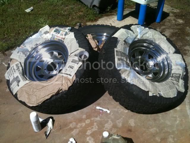

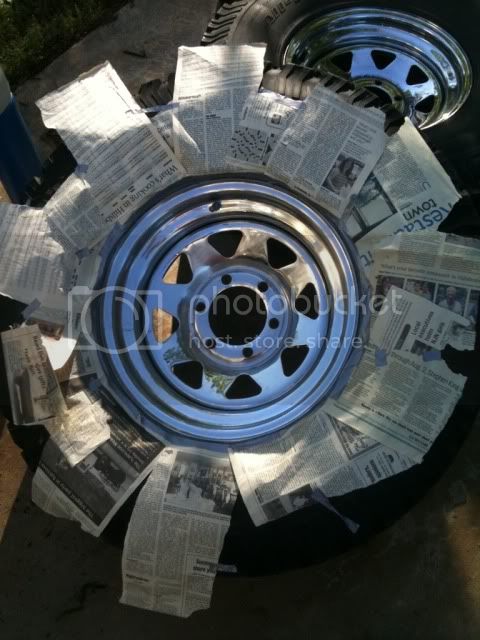

I didnt want chrome rims and really wanted to go white to match my truck, so....
I was out of Masking tape so duct tape did the job. :)

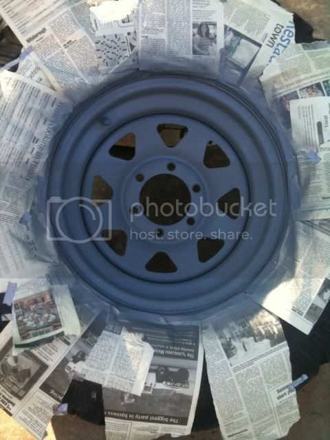

3 or so coats of primer after 220 sanding and alcohol wipe down.

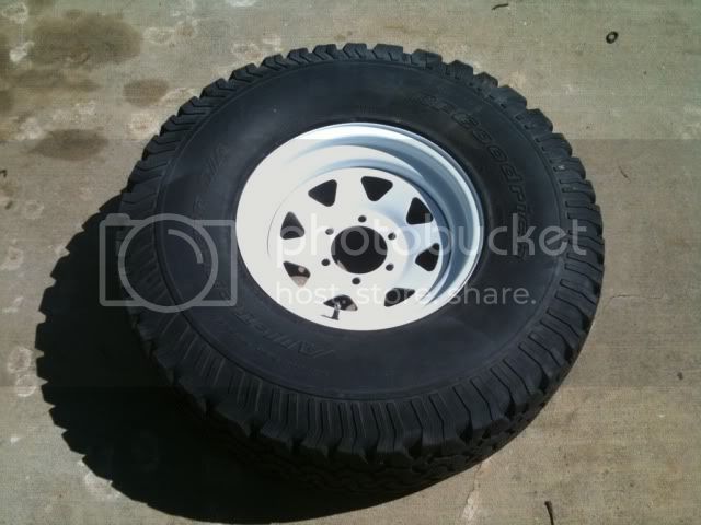

3 or so coats of white.
Working on the other 3 after I finished one.
Finished rim, turned out great, I did 3 coats of clear gloss too, so hopefully they will hold up, if not I can always touch them up.
Now I have to figure out how to get them to fit. :bounce:
