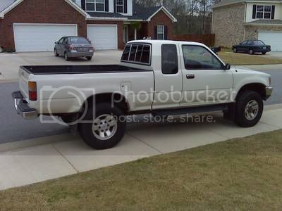

Well in the last 3 months I sold both my 1989 fj62 and my wife's 1997 4runner. I needed to sell one of them and then just decided to consolidate and get a cheaper vehicle. So the wife took my 80 this summer and I havent gotten it back. That meant I had to find something to DD and do a few little things to do wheel some mild trails and forest service roads and serve as a light camping rig. The sear began for me to get a pickup a month or 2 ago, but I had to get the 4runner sold before I could buy anything to replace it.
One great thing about pickups is that they are a dime a dozen. You have plenty available, unlike when your looking for a cruiser. Im looking forward to the same concept when it comes to looking for parts and them being much cheaper. I searched the web mostly and called to talk to a few owners, but after I finally decided what I wanted one kept sticking out.
I finally old our 4runner last sunday and then went this saturday to check out the 1989 pickup with 199K miles. The price was right, and from what I could tell the guy wasnt advertising it much. (Something I learned is a no no in my selling 2 vehicles lately.) Ad as follows:
Summary:
Used 1989 Toyota Pickup 199,000 miles
Location: Grovetown, GA
Body Type: Truck
Transmission: Manual Transmission
Features:
Power Steering, Running Boards
Description

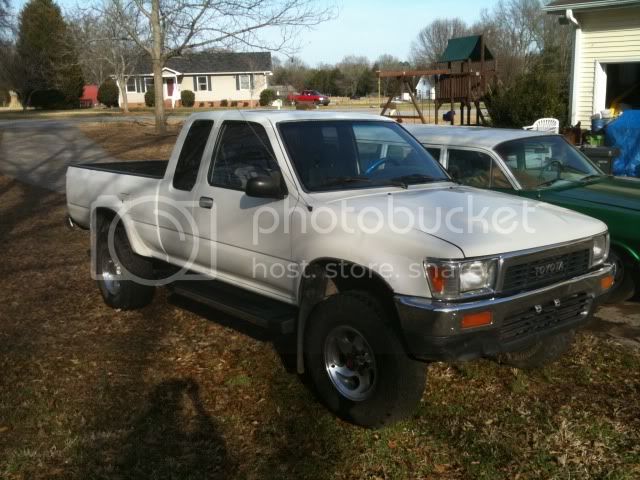

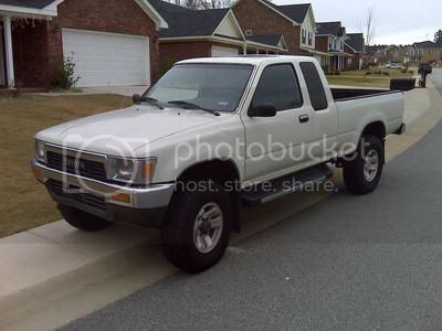

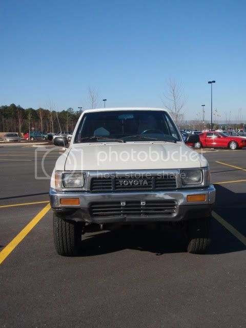

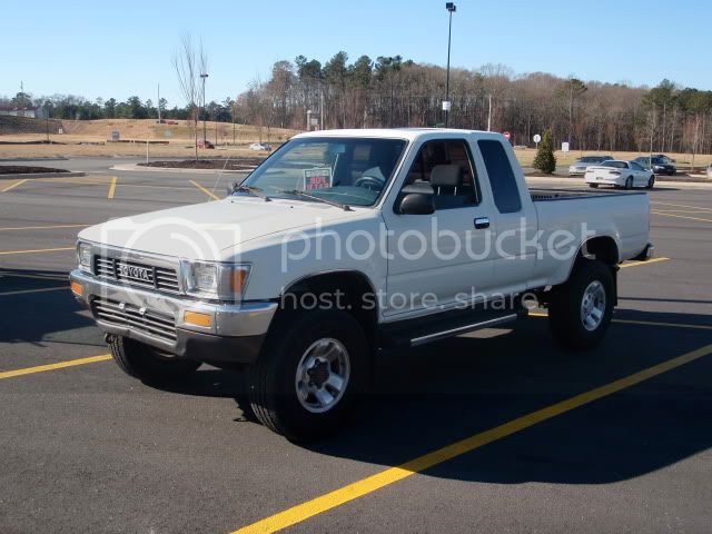

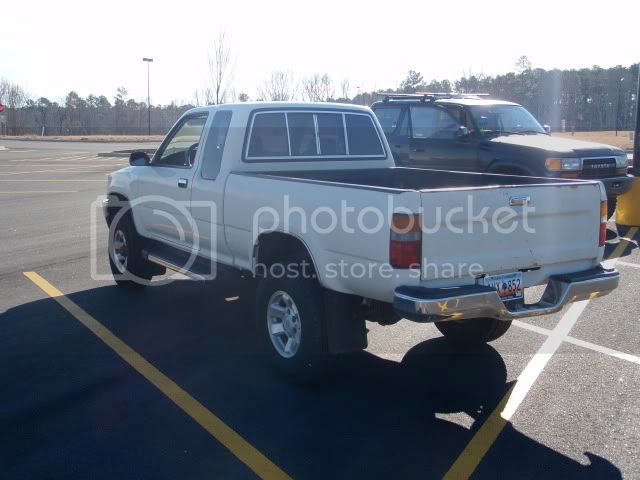

1989 Toyota Pickup extended cab. 4 cylinder gasoline engine. 5 speed manual transmission. 4 wheel drive. White exterior with blue cloth interior. Body has some slight dents and rust. Interior is slightly worn on driver side. Power steering, A/C, Sony radio with MP3 outlet, bed liner, running boards, 31" tires in great condition, slight body lift. Runs well. Contact Marcus @ ###-###-#### for more information.

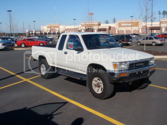

So after talking to the guy and not being able to set up a time to look at it in daylight until a Saturday (I live about 1.5 hrs north) I was finally able to go check it out. Middle of the week I got paranoid as his ad expired an it said no longer active. Apparently the listing he used only stays active for 4 weeks.
So I get there and its freezing cold (for SC anyway) wind blowing trying to check it out. Truck was originally from UT and he had it shipped over last year. Owner before him used it as a hunting truck and commuted from UT to MT on hunting trips, he also had the engine rebuilt at some point.
While looking it over, I see its got a little rust. Which I knew, but hey for $2K I knew it wasnt going to be perfect. I just didnt want something that was as rusty as my 62 was (it was from MN and made trips to ND for hunting trips). Looking ti over it looked good, few small places I will probably clean up and paint over, but noting that should be a problem for a long while.
I ran an Autocheck before I headed down and noticed it was an sr5 which wasnt in the ad, I thought that was sweet as it has more bells and whistles. I notice it has the sunroof option, again, not listed, but I think its really cool. After driving the wrong way on I20 thanks to swampyCU ;) we return after a 15 mile trip on the interstate, it did fine. Got back and after checking the 4wd I came back and looked it over a little more. Then asked the owner, take $1500 CASH? :bounce: While I am pulling the cash out right in front of him. :) So after what seemed like forever he says yeah Ill do that. Sweet!!! That was how much I was hoping to get it for, gives me a few extra hundred to do a few small things.
Anyways enough typing, enjoy the pics. ;)

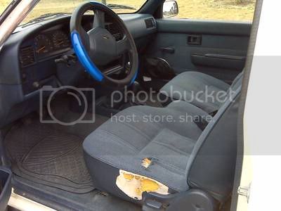

-Still researching options on seating after looking back over the pics. Obviously covers would be the cheapest, but if I can get sweet seats from pull a part for $50 a pair, then I think that will fit in the budget. Especially if they are heated ;)

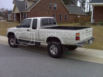

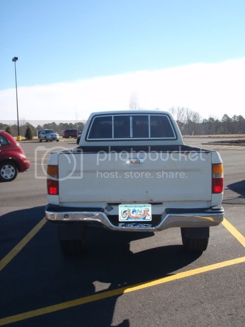

I forgot to post pics from the ad so here they are:
Please feel free to shoot more advice at me.

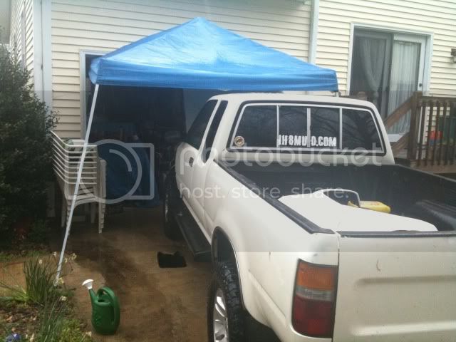

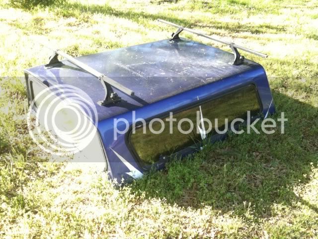

While I was in Florence I picked up a Topper with Thule load bars and a tool box that mounts inside the rails so I can use it with the topper. Saw it on Craigslist a few weeks back and finally decided to go ahead and get it. No clamps so I had to tie it down and drive back. :) Cost: $100 for both!
Pics to come still have to get the clamps, any recommendations?

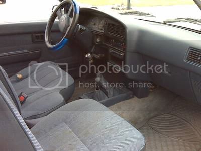

I also have been looking around for interior upgrades. I have had a line or two on 4runner seats and consoles, but the seats were either the wrong color or rough condition. So I decided to check out other seating options. So....

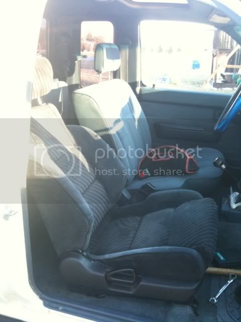

I installed 91 Prelude Si seats today. Oh so nice! Still have 1 bolt on each side that I need to make a mount for and also going to make up a spacer to make the rear sit higher. Scored them for $75 off CL. I almost bought some 89 Preludes out of Augusta pull a part last week for $45, but they had some foam breakdown on the drivers side. I am so glad I waited, the Si ones have many more adjustments and these are almost perfect condition. It got too dark on me so I only got pics of the passenger installed.
The seats are from the Prelude Grey interior. However they have blue threads throughout the pattern and it meshes really well. I may try to find some similar material and use it on the rear seats and maybe the door panels to bring it all together. We shall see what I can find.

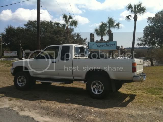

I ended up getting all kinds of plans changed this week with work stuff. I ended up having to make a trip to Charleston for work.....great now I can pick up the rims and tires within a work trip. However since I did not know until late Monday evening that I was going on Tuesday I was going to have to take my personal vehicle. I cant leave my wife at home with the pickup as she is due really soon. So I set out at 6:30 am Tuesday morning in the truck headed for Savannah to pick up the rims. Made the trip down there fine arriving early (10:45) to meet with the guy. I loaded them up chatted with the guy a short while and then debated on what to do. Tried to meet up with some family friends for lunch, but they were too busy. So since I was only 10 min from Tybee Island, GA and the weather was great I decided to go to the beach for a little while.
Started to head back to the truck and it would not crank. :( Urggghh Thought I had taken care of that with the new battery install. One guy helped push to try and drop the clutch, but we couldn't get enough speed. So we tried to jump it, to no avail. At this point I am starting to worry. Remember this is now a business trip, I have to be in Charleston changed into coat and tie by 5pm for work. Got another guy to help push and still couldn't get it to start. After what seemed like a thousand times i pulled my battery out thinking about switching them with another guy, in the midst of that flagging down a lady in a Dodge to possibly push me, while doing that the main power wire falls out the back of the battery connector. After being flustered that I had been there for close to an hour dealing with this and then finding out it was a battery cable. Well I was at least comforted that I found the issue and would not have to figure out how to restart it at the HS program. I then left Tybee and headed toward Charleston to drop the rims off to get the tires mounted on them. 5 - 255-75-17 BFG MTs For once I actually got the rims and tires I wanted ad not just whatever I could find cheap.
So enough typing a few pics.
Headed out of Tybee:
On my way to Charleston:
Check out the fog rolling in. You could only see the tips of the Cooper River Bridge when headed from 26.
Overall it was a great trip, eventful, but the truck did fine overall around 600 miles in 18 hours and the odometer clicked over 200,000 miles. I made it home around 12:30am. And even did a little work as well. ;) :bounce:

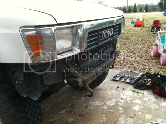

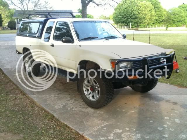

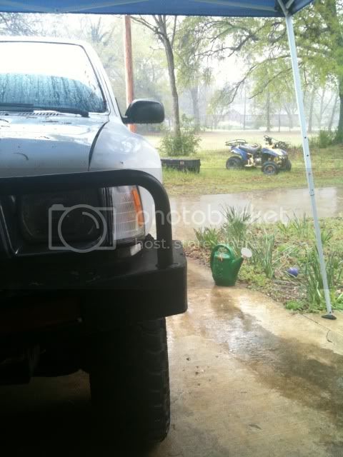

Saw a post for an ARB on CL right before I got sick and the guy said he still had it, but that he had 4 people saying they were coming Saturday to get it. I was helping at work for a few days after our baby was born so I did not get off till almost 8pm. I called and got up there around 9 and bought it. I am not sure if its an ARB as the bars are different than any ARB I have seen but it mounts up fine and seems to fit fine, so who knows. Not a bad score :)
I got the bumper installed and it sits a little bent down in the front as the guy said he flipped his truck with it on. I think I can get it fixed when I figure out what I am doing in regard to lift. (BL or not, etc.) I also have to figure out what I am going to do to mount up lights on this thing. I have 4 Lightforce 240 blitz in my garage and 2 are supposed to go on the truck and the other 2 on the 80 when I find an ARB for it. We shall see what I can muster. No winch install yet. its still in the garage. I hope to get some better pics of the bumper installed over the weekend.
The drivers side is not bolted up in these pics, so it looks very tweaked it is not that bad at all. (You have to think of interesting ways to mount up a heavy bumper when all you have is yourself. Thank goodness for jack stands, blocks of wood, and cement blocks. :) )

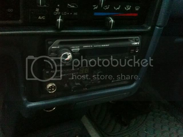

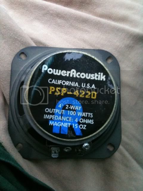

I also wanted to upgrade my stereo. It came with a newer Sony HU and it will do for now, I am not a huge fan of Sony, but its already installed and is a decent little unit, HD ready, Aux in ont he front, etc. I had these speakers in the truck and they sounded OK, but I wanted something a little nicer.
I was having issues with the drivers side speaker going in and out so I took care of that last night as well as installing these:
Polk Audio ex402a 4" Coaxial speakers Picked them up on ebay for $21.20 shipped. I have Polk speakers in my home theater and they sound great so I figured I would give them a shot.
I also picked up a Polk ex10 off of eBay: http://www.polkaudio.com/downloads/manuals/car/EXIISubManual.pdf Its a 10" sub and I got it for $21 shipped. I plan to install it under the rear seat in the drivers side storage compartment. That way I loose no seating and gain some lower range. I thought about using the side storage panels for some 6.5's but I am going to hold off for now. I have 2 amps that I have to figure where to put one of them as the Prelude seats sit a bit lower and neither amp will fit under them as they are installed now, so we shall see. (Orion 225 HCCA and a Kicker 240zr, both from previous vehicles.)
I also got some sound deadening foam about 40 sqft. ($23.50 shipped) and I am on the lookout for some second skin or dynamat. Keep finding some but man that stuff is expensive! I can only imagine how much better the truck will be to ride in with a little extra sound deadening though. The MTs arent too loud, but you can def hear them. I haven't done sound deadening in the past, but figured with the size of the truck, why not.
I also had a CB that was originally for the 80, but when my wife took it over last summer I figured she would not need it. So it went in the truck.
I dont have the antenna mounted and stuff yet, so its not working yet but with a little trimming of the surround it fit in perfectly! I have a 3' firestick and hood mount in the garage that came off of my fj62, but not sure if that is what I want to do on this truck. Then again, with trying to make this a budget truck it probably will make its way on to it.

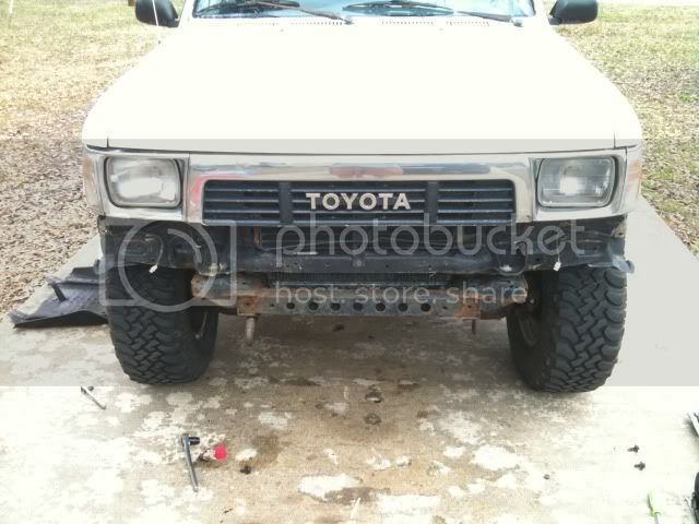

Long overdue update:

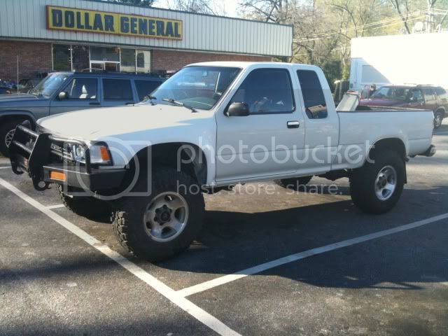

Finished the Bumper install, I have basically determined its not an ARB, maybe a Warn?
Its been an interesting year not only for me and my family but also for the pickup.
I ended up getting my clutch replaced with the Marlin HD and all new slave and master as well as rubber boot and OEM rear main. The clutch got so bad that the truck would barely go up a hill without slipping and my mechanic buddy said that the rear main leak was one of the worst he has ever seen, that it was probably the only thing that kept the flywheel from being trashed was all the oil!

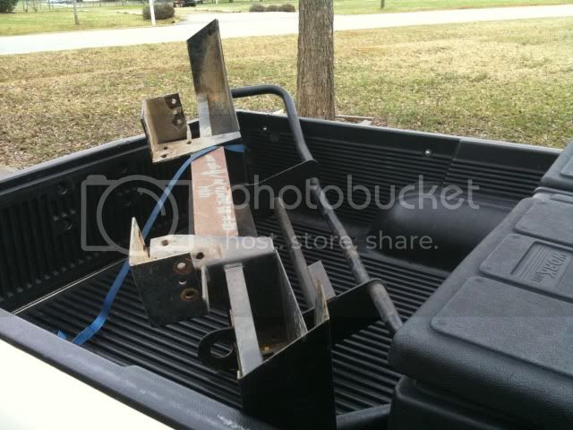

And then used the $ to go get some stuff, I left out Friday and headed on the other side of Athens and picked up a set of fiberglass fenders its been raining here almost everyday so I had to get a little creative with my install:
I got the driver side installed with little aggravation and I tried to get the passenger side on Tuesday night it was taking a little more time and I ended up running out of daylight and having to run in to help with the kids. SO I ran fenderless to work 2 days, even had to run to a school today with no fender. :) But I was able to wrap it all up today. Here are a few picks of the drivers side install I hope to get up new pics of everything soon.

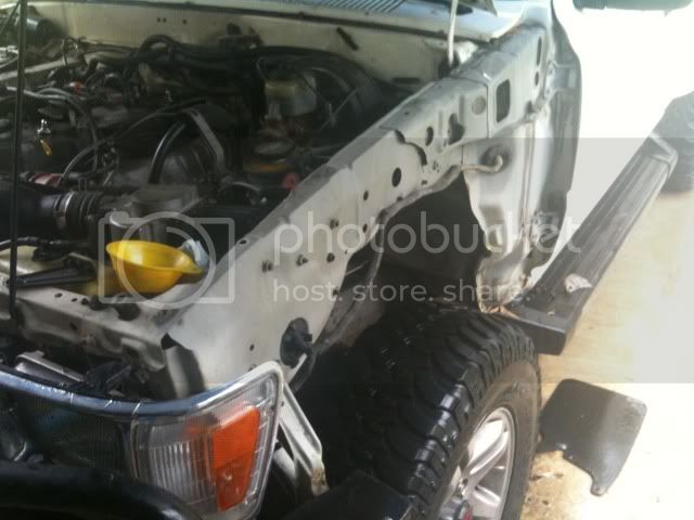

Got out and took some pics and it was nice out so I figured I would do a little to the truck today.

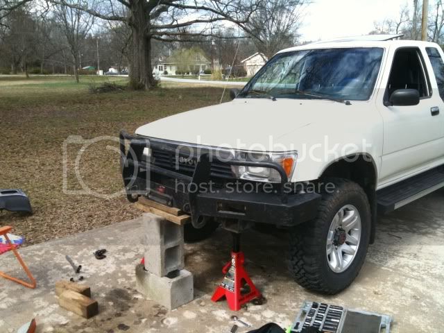

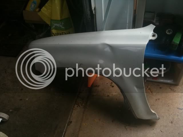

I had gotten the passenger fender on and had been thinking about taking off the OEM running boards. SO I finally went ahead and did it, sure makes it look taller.

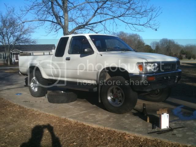

I needed to rotate tires on my wife's 80 and my pickup so I took the opportnity to do that. Then I started thinking, what would it look like and how would the fit be if I swapped rims and tires with the 80. SO....
I had to trim a little in the front on the cab side and bashed a little of the seam at the cab as it and part of the fenders were about 1" from the tires after the trimming I have about 2"+ of clearance. (While turning) Hopefully with BJ spacers and shackles I will clear enough to wheel. BL will certainly be needed to clear 35s.
And then I took it for a drive and tried it out. Definitely makes a difference. I have to get my ball joints swapped as the larger tires make it clunk even more. I am going to ride on these for awhile and see how I like it before I go up to 35's or so.
