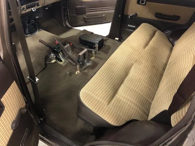

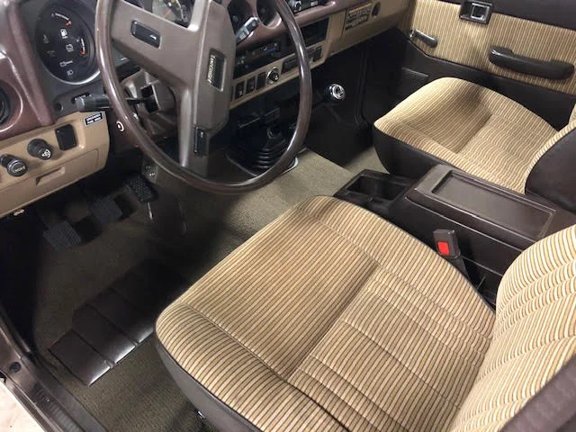

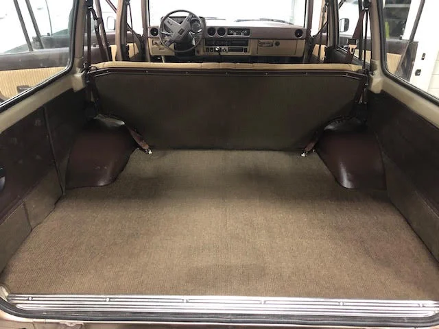

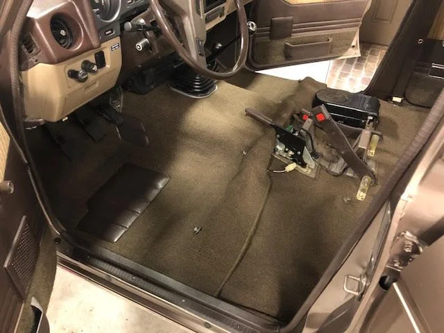

Just wanted to post an update on the carpet kit and my experience with it. DNP was very helpful with ordering and tips for install. It went pretty smooth. Rear was easy. Refinished my rear seat edges while it was out. The middle section was a bit harder but the front was by far the hardest. The soldering iron was essential. I had a lot of trouble with the shift boot covers, as things are tighter with the new carpet and padding. I wanted the carpet to be screwed down and not just slipped over the boots. Finally i got the bolts to line up by running a few bolts from underneath and using them as a temporary guide then doing one at a time from the top. Anyway, here's some pics. The quality is high. The fit is great. padding attached is very nice feature. Heelpad feels solid. Overall I'm glad i went with this product. message me if you have any questions on my install.

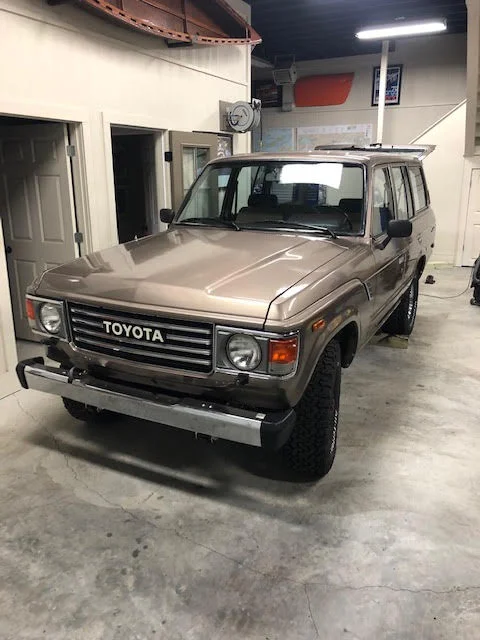

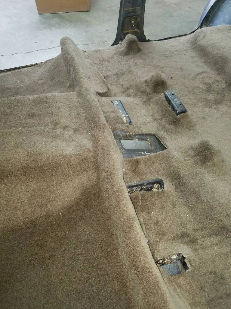

And here's a pic of the rear carpet I forgot to add. Also one of the exterior now that I got the body back on the frame. I need to post some pics of my dolly so it might help someone. Took a while to measure but was easy to build. Saved me the cost of buying a body dolly.
Looks great....just like mine when I finished. I would say the hardest part was getting that darn ring around the shifter lined up and screwed over the carpet. If I ever have to take mine apart or if I was going to do it again I would take one of those screws out and go source one that was about an inch or so longer. Would of made that last part sooo much easier.
From the factory, the metal ring would have been below the carpet; however, several people have told me they prefer it being on top of the carpet. For those who like the ring on top, I had a guy relay an installation tip to me: he said he found it easier to run a longer bolt in from the bottom, so that the interior ends would act like studs. Then, he cut them to the length he liked and then used some sort of finishing nut to secure it.......I thought that was pretty clever!
