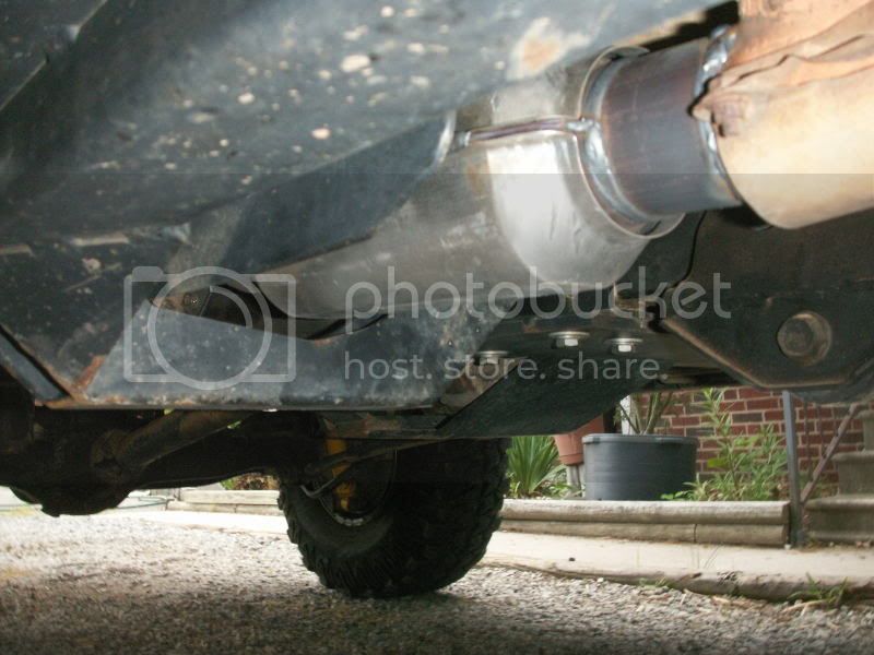

side profile
single catco cat
goin over

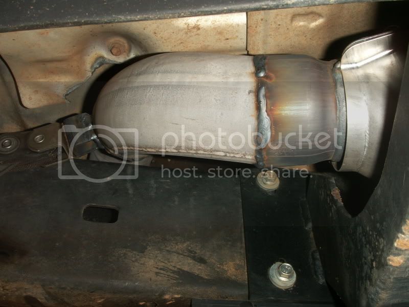

coming back down the inside of frame rail
the muffler twisted to be above frame rail (offset inlet, ctr outlet)
and the nice clean exit, inside frame rail, almost unsmasheable :D

yes its a full 3'' pipe over the frame rail w/ no body lift..... its tight and i guess time will tell if its going to contact. Reading through several other posts of folks w/ 3'' over the frame, no one has mentioned this being a problem, but ill update when i get a chance to get back on the trail. I did have him put a hanger right where it goes over for this reason.

in my 3" exhaust build getting the pipe over the frame is not a great problem-there is a good 1/2-3/4" of free space all around the pipe as it goes over the frame. the trick is getting the 3" over the rear crossmember. there is like no extra room if you go over that rear crossmember. when the truck frame flexes the exhaust has to have someplace to move. it there is not a flex pipe up front there needs to be plenty of room for pipe movement. If you secure the pipe semi rigid at the rear crossmember to avoid banging then the movement will be seen where the exhaust crosses over the frame by the cat. I havn't been able to test mine yet but even though I brought my 3" below the rear crossmember I am worried about banging. good luck

I have 1/2 inch above the pipe and 3/4 inch below the pipe at the rear crossmember. one hanger as it goes over frame, factory mount behind muffler and one at the end at exit (all are semi-rigid w/ metal<rubber>metal). Well see once we get on the trail.
