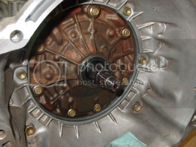

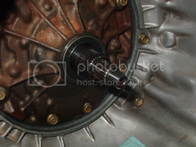

Here are the measurments, they are all from the face/engine mounting surface of the bellhousing. The measurements were taken with the 5VZ V6 bellhousing mated to the tranny and the difference between the 5VZ and the 1FZ bellhousing is the 1FZ is 36mm longer. I don't know if they will be the same with the original pump and input shaft.
Face of bellhousing to end of pilot shaft 30mm
Face of bellhousing to end of small splined shaft 45mm
Face of bellhousing to end of large splined shaft 66mm
Face of bellhousing to end of face of seal 98mm
[URL="http://i480.photobucket.com/albums/rr167/mmml4/99%204runner%20build/DSC02937.jpg"][/URL]
[URL="http://i480.photobucket.com/albums/rr167/mmml4/99%204runner%20build/DSC02936.jpg"][/URL]
These measurements will be the same as if the 1FZ bellhousing were still mated to the tranny.

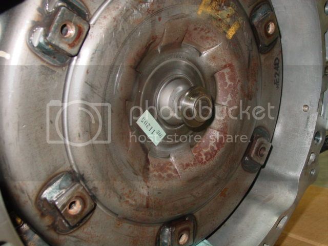

Face of bellhousing to end of face of torque converter pilot 4mm
Face of bellhousing to end of flange of torque converter pilot 10mm
[URL="http://i480.photobucket.com/albums/rr167/mmml4/99%204runner%20build/DSC02938.jpg"][/URL]

One positive I can see from the pics is that the original bell bolts should not interfere with the NV4500 trans to bell bolts because of the circular pattern on the Toyota bell vs. the square pattern on the NV4500. Looks like we'll have enough meat to bolt the two together via an adaptor block.
