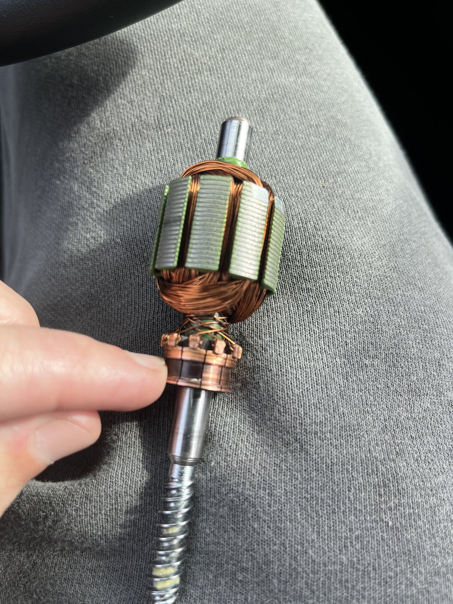

FYI, it was the actual armature of the motor that had failed. The copper plating had worn through so the brushes were not making contact 100% of the time. I tried copper tape to restore it, but could not make it work. While the 100 series antenna is almost identical, I don't think they fail nearly as often as the 80's simply due to lower use. I suspect that most 100 users did not leave the antenna's up all the way, or used CD's and/or SAT radio, so there was much less wear on the motor.

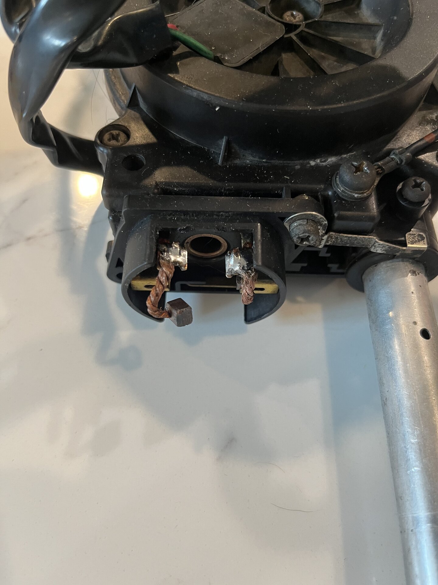

I ended up just rebuilding my antenna. Took every piece apart to diagnose. Same issue as WannaCruise, copper plating on the armature worn and flaked off.
You can get the armature rewound locally at an electric motor shop.
Next was brush refurbishment, which was difficult to source. The best option I found is the old Toyota brushes- but you will have to modify accordingly. Link below to a 10 pack.
Our brushes for 86300-60080 are 4.5 x 4.5 5.5mm.
The brushes listed above for eBay are 4 x 4.5 x 8mm.
The brush housings with the springs are a tight fit to the OEM brushes .
To Modify:
A. Sand down the 4.5 mm side slightly to 4.35mm. 4.5 has too much friction for the spring to work.
B. The 8mm is challenging in two steps. Taking a razor isn’t ideal for carbon brushes, fragile material. So a lot of sanding. 5.5mm
You can’t simply remove material from the back since the copper wire is seated about 3/4 of the way back in the brush.
You need to sand the material from the front, then bed in the front of the carbon brush to have a semi-circular surface. I used a pencil and sandpaper to spin to give the concave surface.
220 grit was fine, not too much material removed at once and you could go finer if you want to for all sanding purposes.
Soldier on new brushes.
Attached, brushes seated and armature in place. Using thin painters tape on each side, then pulling the tape once the armature sits was my method.
Hopefully this is helpful to someone. I would consider helping repair one of these if there is a need.
That's great @idyllwild! I did the same thing originally. Found brushes, filed them down, etc. My issue was getting the armature fixed. I tried copper tape, but it failed after a few cycles.
How much did it cost to have the armature rebuilt? Who did the work?
I had the local alternator shop ask around and they knew someone who did that kind of stuff. Charged $150 I think.
Yikes, but I guess with labor rates these days it was bound to be pricey. But still cheaper than the FJ100 unit!
