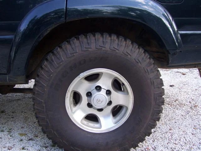

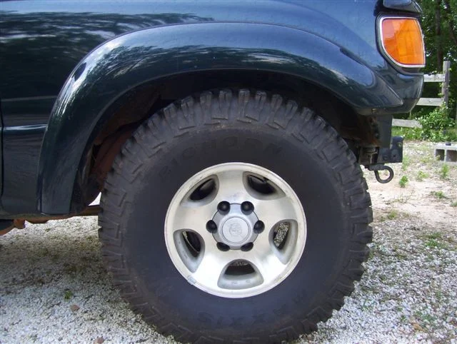

IIRC I saw someone on here who managed to stuff 35's on his rig with no lift.
I fit 315-75-16 (35's) on mine stock, but it isn't advised because of rubbing.
That was me. :D
33" tall tires are a safe bet for sure, and fill in the wheel wells very nicely.
clearly 35s are possible...
35's are 'possible' if you don't put anything else in the rig. I put 35's on mine for a short time but when I put stuff in the back AND put my 3-rail motorcycle trailer on, --- rub city ---
I think under serious articulation, you wouldn't be happy with more than 285/75's unless you lifted it up some. FWIW. Dan.

315s are the metric 33x12.50R16s... However, they are a bit undersized. I ran a 33x12.50R16 SS Trxus (true 33" tall) without rubbing on my 80 with no lift.
