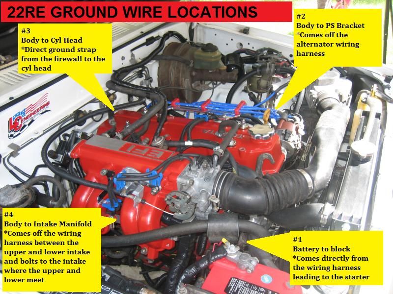

Did you reconnect the ground that mounts to lower air intake plenum? Well hidden and easy to forget.

There is one that mounts to the support bracket at the air intake plenum. It's the ground for the injectors. So if not connected it will turn over with starter but not crank or crank and die like 5-10 seconds later, can't remember which.
Ground #4
