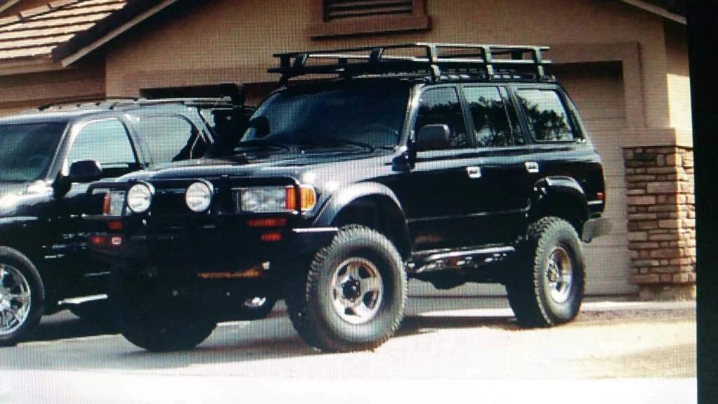

Hey Guys and Gals, I have a 49' By 83' Chinese RTT I bought to put on my full basket 87''X 49'' roof rack I bought on impulse today.
I don't believe the RTT will sit in the basket because it is also 49'' which is the same as the HTT size. Does anyone have experience with these racks and have an idea how I need to mate the two? I am having a headache thinking I just bought two incomparable parts.

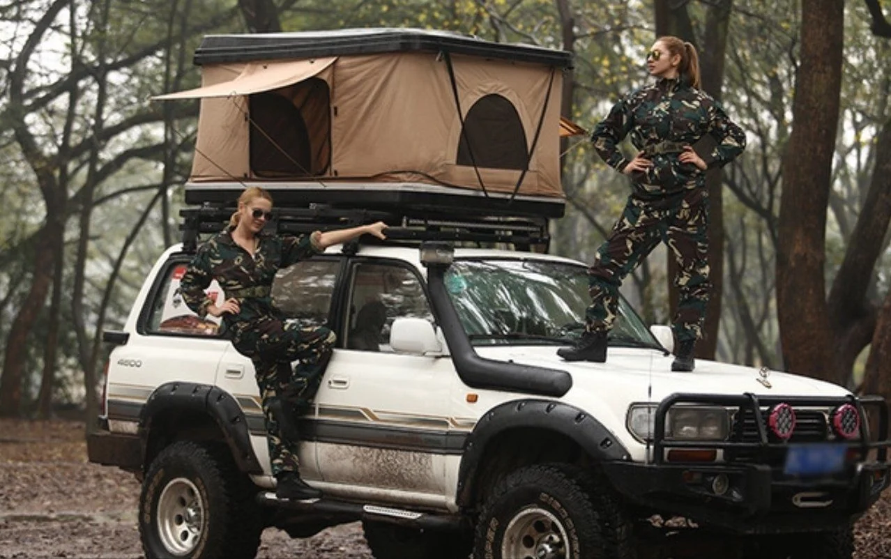

Might need two Thule bars with adapters/"feet" that attach to the round, upper bar of the ARB.
Maybe see if these will fit the ARB upper bar:
At least with these type of adapters, you'll have some room underneath the RTT to put some flat items.
Good luck
Can you think of any cheaper solutions I can't afford a Yakama or Rino bar at the moment.
Check if the Chinese tent maybe comes with its own cross bars that you can use. The classic soft roof top tents come with cross bars that can go across the top of the ARB cage rack.
