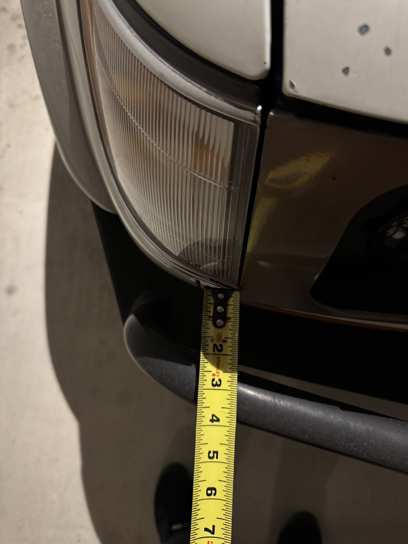

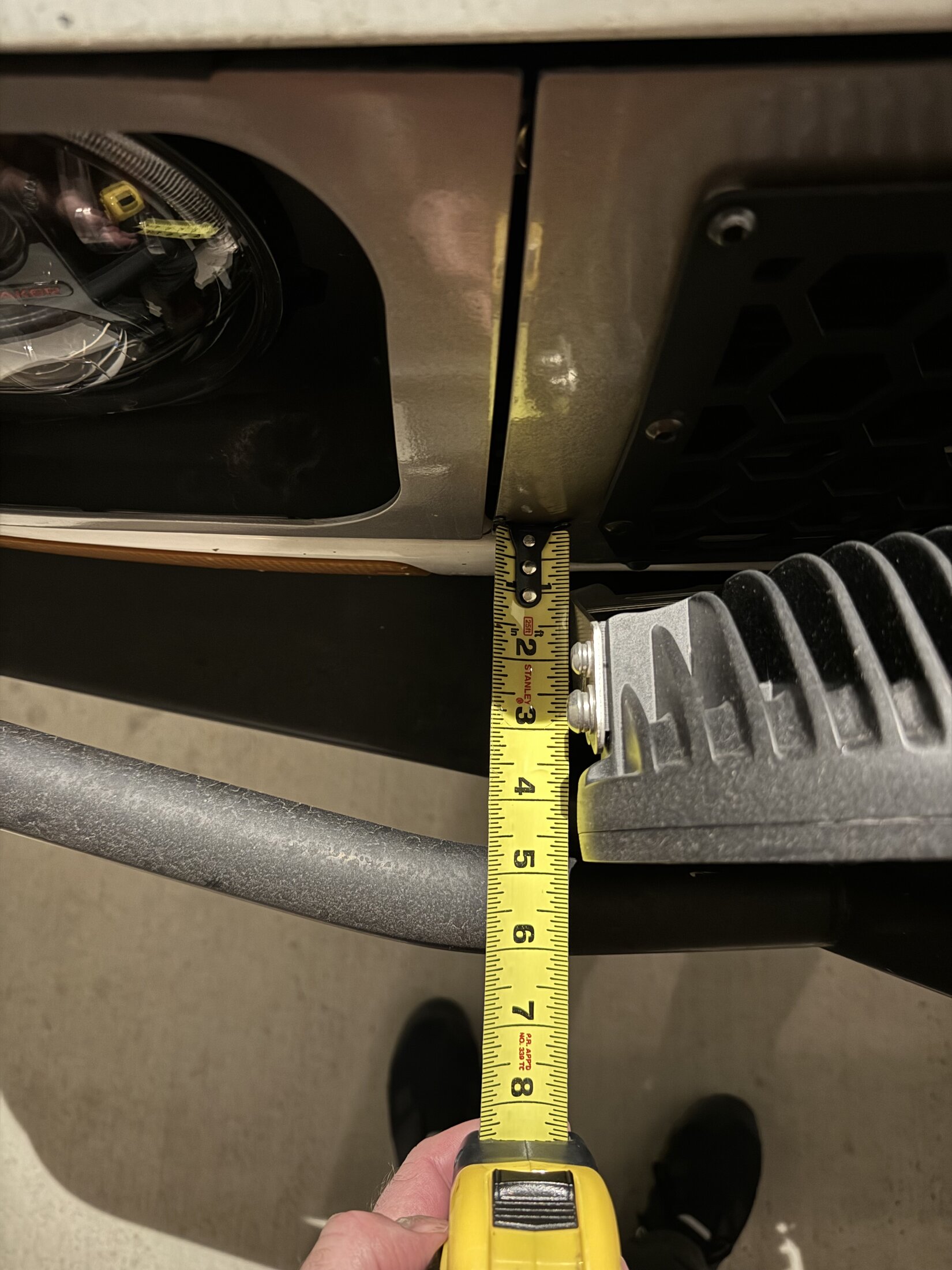

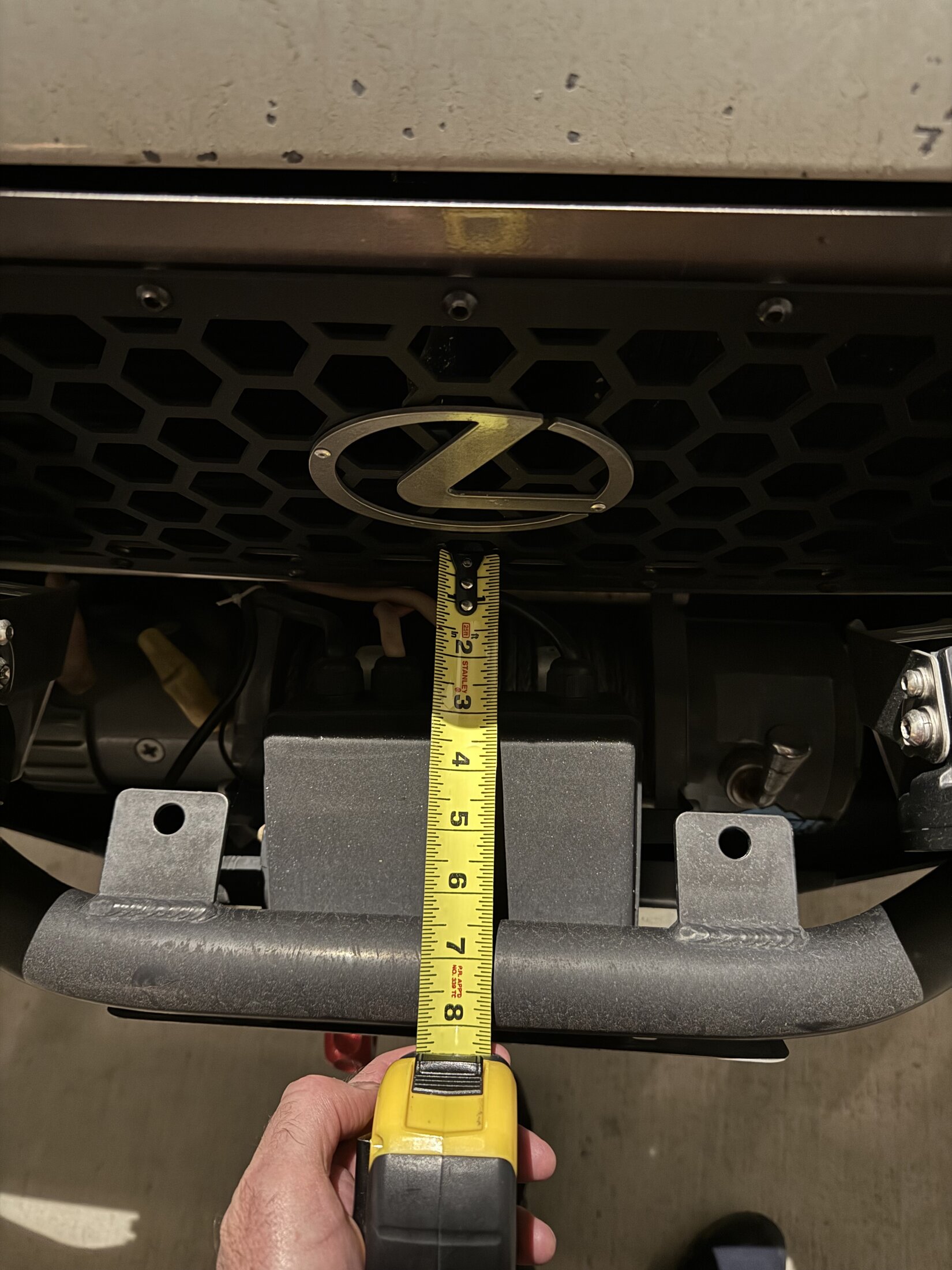

Ive got one I can snap a couple pics of for you, but it wont be till tomorrow afternoon. Also, to see how it mounts on an 80, look at Slee's instructions. He has pretty good drawings in there of how it mounts.

Can’t wait to hear more about this project, CD. I have the short bus on 80, but changed to custom grill last year. I can take some pics in the daytime tomorrow if that would be helpful, but I’m really thinking that would be hard to know for sure since the 60 front is so different. I’m thinking maybe to get J. Monroy to take some pics of his 60/80 truck and maybe make some measurements from height of frame mount points to valences, etc?
i figured out how it mounts from slee website. What would help is the width of the top flat pieces from front edge to back edge to see if I have the space.
