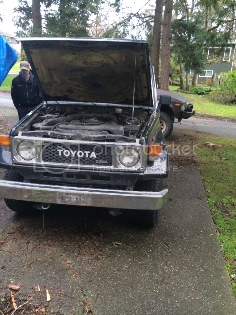

I went to check out this one off usedvic, it's 86 3b with 368km on it. The truck mechanically seems pretty good. (Except a possible glow plug issue, which he wants to fix before selling)

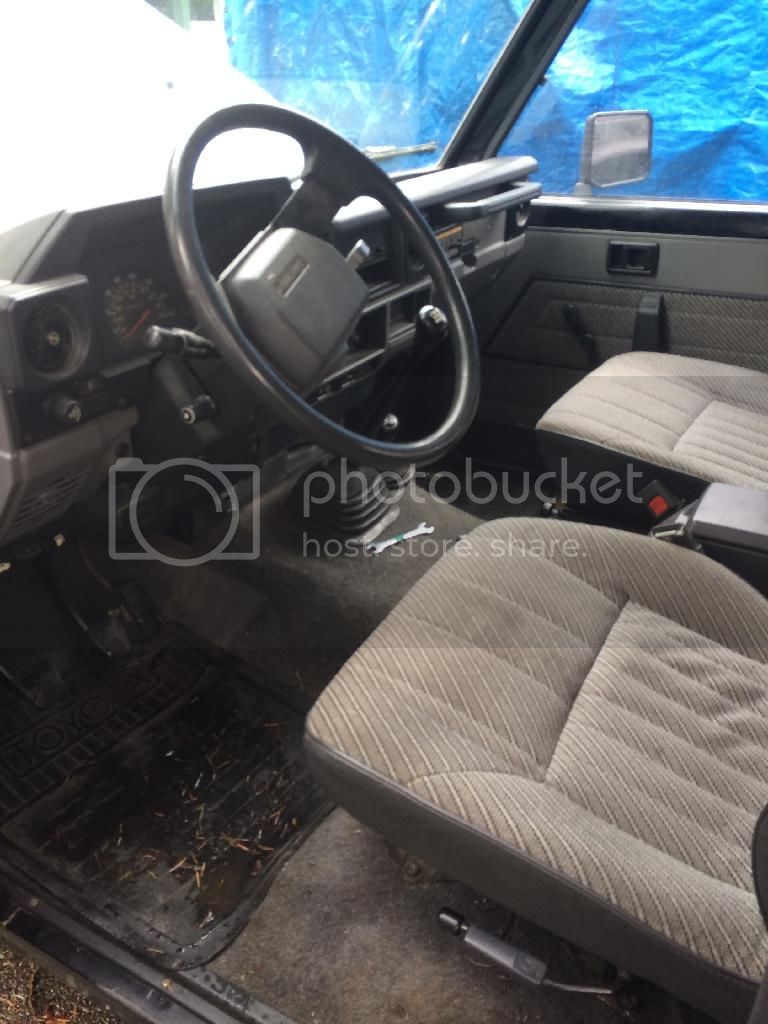

Everything on it seems to be unmolested, it's got a nice interior (after a wash). And it comes with a new clutch kit bought from radd apparently.
He is asking $5500

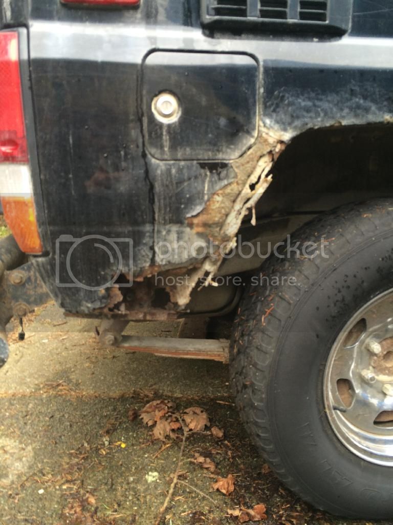

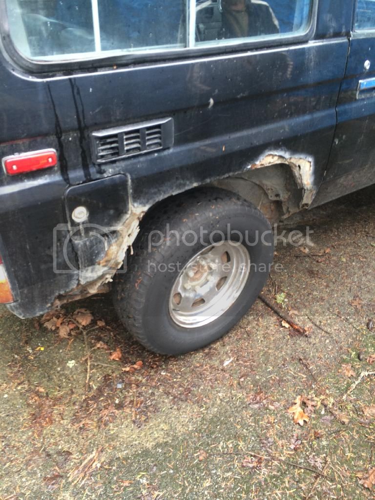

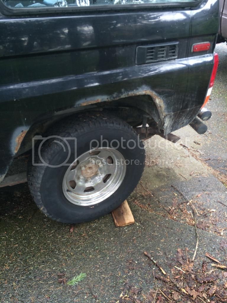

Now here's the problem, as you guessed. Rust..
The rear quarters are hurting, r/h side especially.
The front of the truck, including floor and rockers and even fenders and the frame are good though. The only rust is the rear quarters.... And it's bad.
I'm not terribly afraid of fabricating body panels as it's kind of what I do for a living, bit I don't really wanna pay that much for it.

Howdy.....always miss my little rust free BJ70... Looks OK, if the frame is good the rear quarters should be not bad to tackle.. As for how much, we cheap cruiser heads would not want to pay that much..:clap:
When I bought mine it was similar, although the inside and wheelwells were all fine. The rockers can be bought still, and aren't hugely expensive, although they are a pain in the ass to install.
With the arse end, if you do away with the fender lip, they're quite easy to do as it's all flat. I did a "quick and dirty " repair to mine when I bought it, and it lasted 5 years until I sold it. I have one of those flanging tools that stamps a lip into sheet metal, I used that on the rear and it worked pretty well. I wouldn't say the truck looked perfect, but the carpets stayed dry. Wet carpets are kinda the shark jumping moment for a cruiser, the rust spreads at double speed once it gets there.
