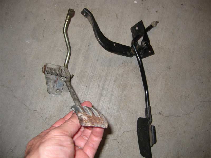

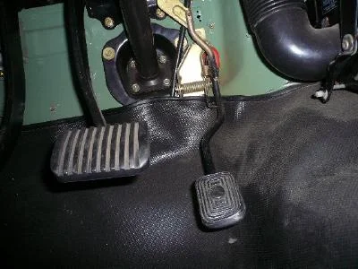

Iam redoing the gas pedal on my 3FE - 40, and need to know what the stock pedal looks like.
I've rounded up a FJ60 pedal and what I think is a FJ40 pedal..don't know what year. I plan to use a 3FE Throttle cable, and need to weld a eye to the top of the pedal...or come up with something else.
I think I have am mini truck pedal in there now- the cable is too short and the idle won't kisck down - it just ain't right. :frown:
any pictures would help me fiqure out what I have.
Thanks - Mark
Here is what I've got - the one that is one the truck hits the e-brake.
Hey mmw68
:beer:Got a cable for you!! If you can find the bracket for the throttle lock you could use that 60 pedal with the 62 cable. You should be able to clear your e brake. Anything else you need before Sunday night call me.
