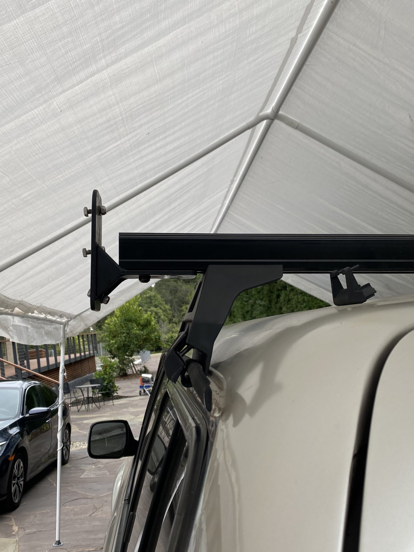

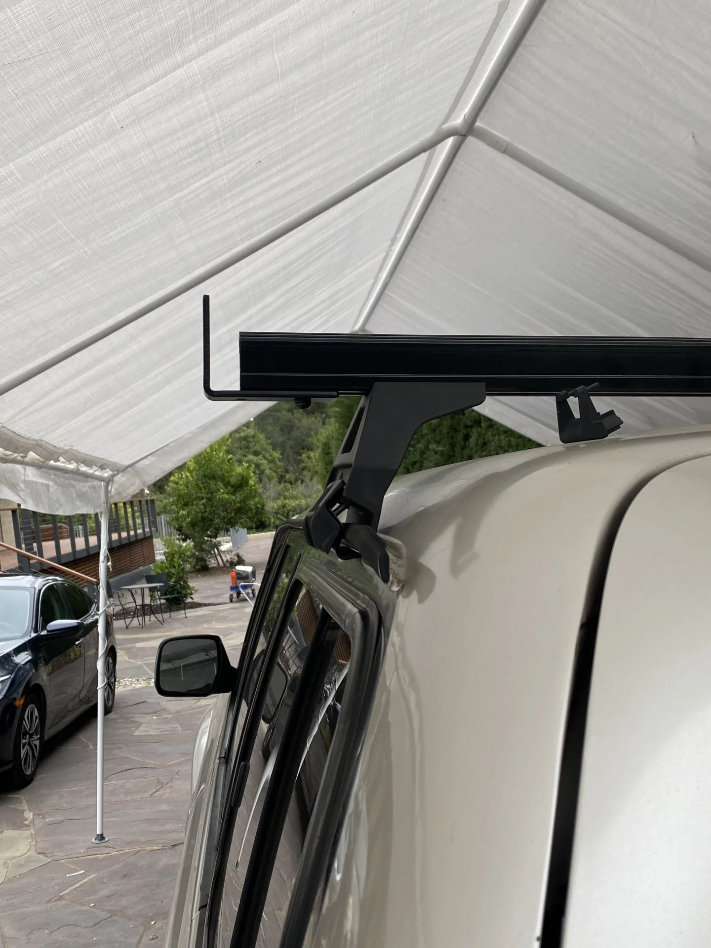

Here are some versions of L brackets and T brackets mounted to a bar. You shouldn’t have an issue getting the awning as low as possible. I’d suggest Rhino Rack, Front Runner or Gamiviti gutter mounts. In the pic here I have Rhino Rack RL110S legs to a 60” HD crossbar. The bottom of this crossbar is 3/4” above the metal roof.

Thanks to you and Shoredreamer for that info. I'll still do some due diligence on the Frontrunner bars and gutter clamps, however, they do look like they'll work on first impression. The bracket in the first pic that Shoredreamer posted is probably the way I'd rig things to clear everything. Best thing is I have no previous rack up top, being one of the relatively few "slick" ones that came without.

The way I mounted mine is similar to Shoredreamer's pictures, except my L brackets are attached to the top of the cross bar and then pointed down. Even then the only added "height" is the thickness of the bracket and the nuts on top.
