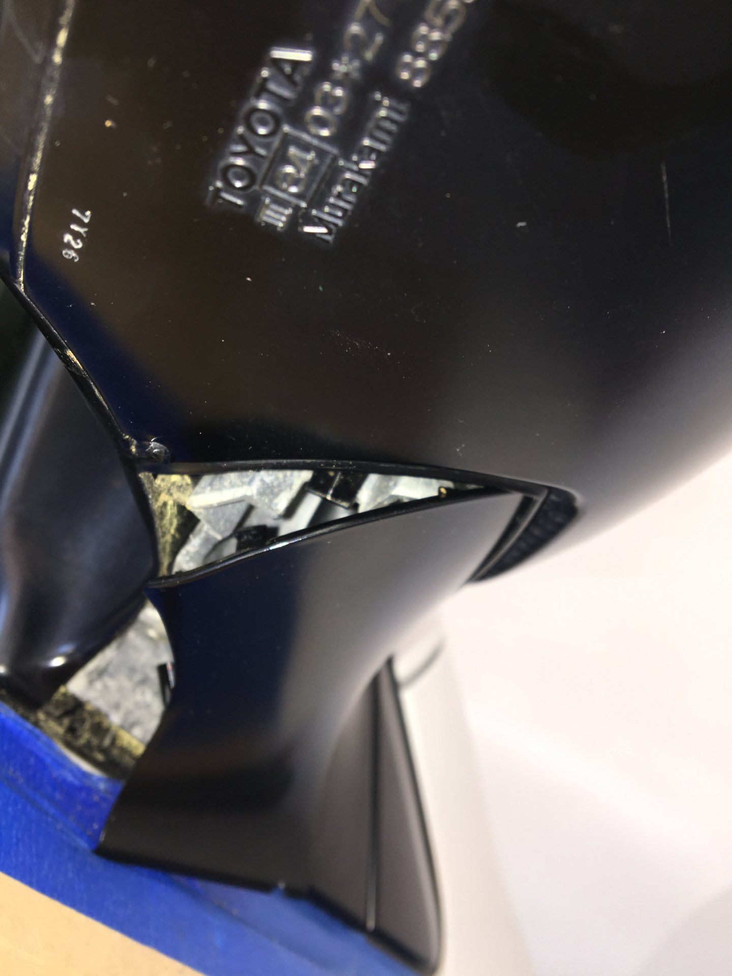

Spending a few minutes looking at the tabs and where they seat helped with the reassembly. It is an odd shape. It needs the long edge toward the front of the vehicle partially set - not snapped in though so you can then target the two outer clips that are farthest from the door. The photo I’m including is the pre-set position before you start working it toward the outer clips.
Right when those clips go out of sight, pop - the whole things seats without any fuss.
ps: Got to thank my wife for stepping in with the spidey-sense... When she saw my prying on the drain hole with a dental pick she called whoa - do this when you have more time... gave me just enough of a pause to realize I was pulling in the wrong drain hole - and the wrong panel. Sure enough there are two panels under that mirror. A big one that covers the entire bottom of the mirror and a much smaller one directly below the pivot point.
Here’s that photo:

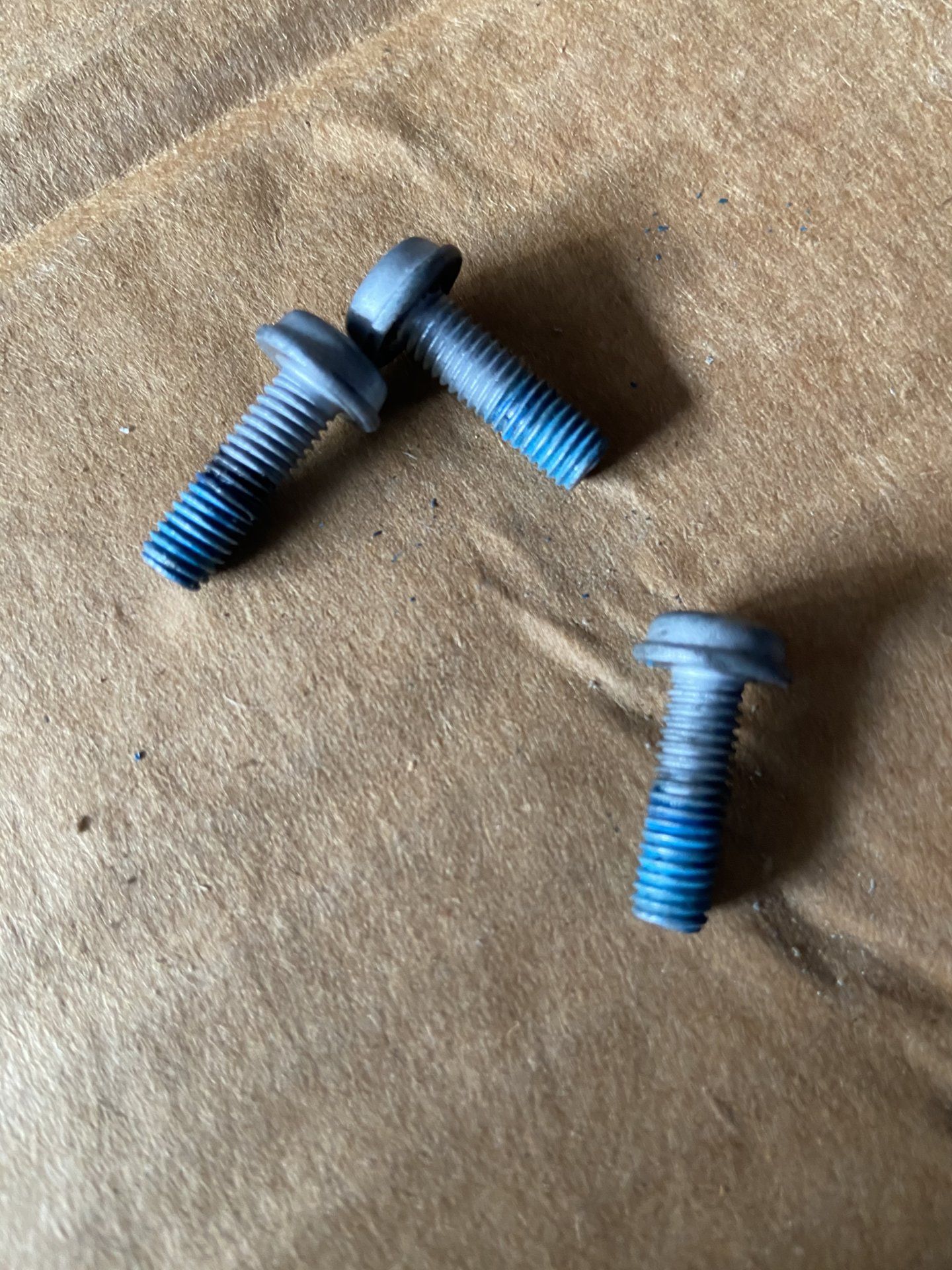

Had this my problem on my 08 LX. The original screws didn’t have a locknut washer or washer as seen in the attachment.
