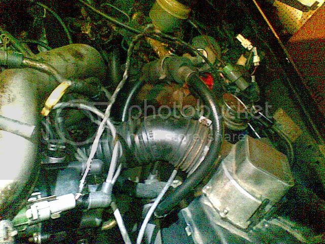

So that small black wire with the black connection on the end, was in fact the starter wire, ended up clipping of the end and putting on a flat clip end and hooked right onto the starter. Jumped in the truck and turned over the key, and there it is! It turned over! Now to find the 2 sensors that I am missing. I need the Temp sensor and the sensor that clips onto the Distributor. What is that sensor???? It is green!
not a sensor... Weather connector?
The other side of it comes out of the coil... Is that the one you're thinking of?
1st off... Is the "green thing" you're referring to a sensor or the connector?
carbed truck...
EFI

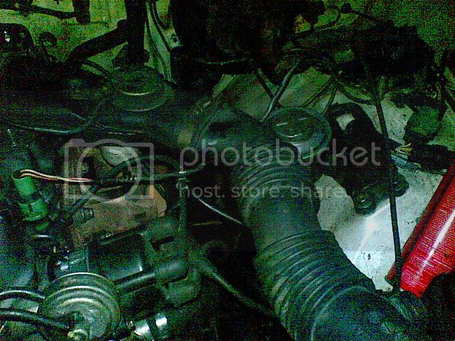

Yes the connector on the EFI unit that is attached to the distributor. Also just got back from pick-apart and was able to find the temp sensor, found some other parts as well, but miss placed the $20 bill I took with me! Have to go back tomorrow!
fired over.
So finally went back to junk yard and was able to pick up the bracket that goes on top of the valve cover and some of the "weather connectors" that attach to it. The one item I am still missing the the "weather connector" that attaches to the distributor, I believe it is green in color, what does this connector do and go to? Worked on the truck tonight after work, and was able to install the radiator and what ever else was left to put back on. Got in truck, turned it over. I had to turn the key about 10 times to get fuel up to the engine, and it was able to start to fire over but the battery started to die. I have friday off, so I will charge the battery and see if I can get it to start then!
