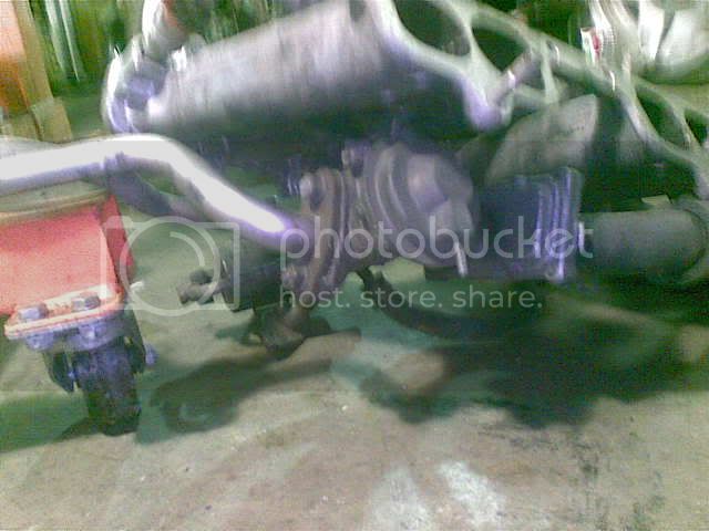

progress so far. I am looking to know where the air injection tubes go, in a picture please.

as far as my memory, and my RTE,,, the pipe dosnt look right... And on my RTE, there's nothing there...
AND middle of the intake is one of the hardest (IMO) to put on pipes there is... It uses very small bolts that could be hard to start...
sorry I don't have an RE to double check on... But that pipe does not look right to me...

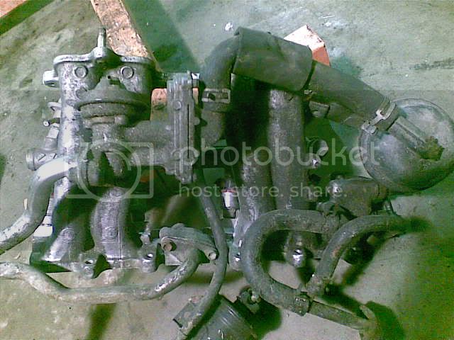

so, anyone else with a PICTURE of the engine with the EFI intake removed? Please!
what in the .... is that, well i have learned my something new today!
you can thank uncle sam for that mess.
i do not see any electrical connections on that mess, i would look into shedding it and some weight.

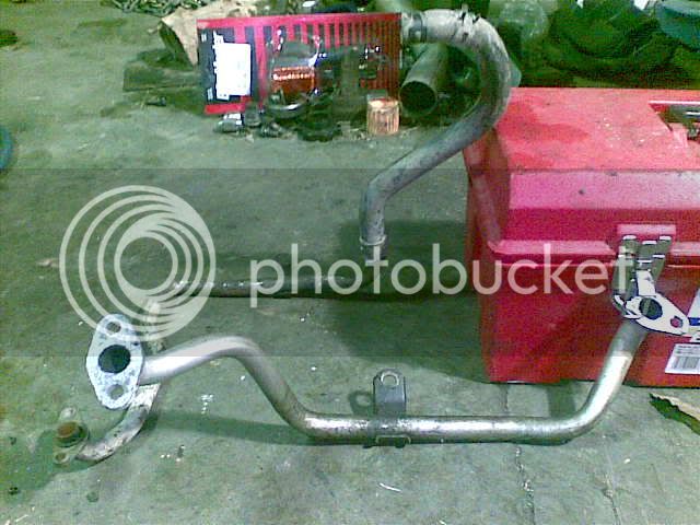

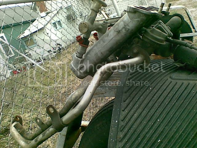

Well, I REALLY hate to tell ya this, but I'm pretty sure you're gonna have to pull the upper intake back off to get that one line installed that goes to the bottom of the lower intake. As a matter of fact I'm pretty sure you'll have to pull the fuel filter to get it to bolt up to the side of the block in the right place. ...and you might even have to drop the engine down some (remove a mount) to get it installed around the back of the head since there's no room to get it down in there without bending it.
When I'm building a motor that particular tube goes on before it ever leaves the engine stand. I just saw this thread and can take some pics if you need any more!

Installing that PAIR valve tube and the other tube is tricky. My 22RTE doesn't have one, but my 22RE does. I didn't drop the engine, but I have lots of cuts on my hands from the installation. Fuel filter bracket definitely has to come out to get the middle manifold tube installed. I've been there before. :o
These pictures Help me out! Outstanding, Thank you very much. Yes I will have to remove the Intake again, and that's fine. The Fuel filter has not been installed yet, so that is to my advantage right now. I will get back to it monday on my day off. Thank you Mud community! Also I found this large diamiter shinny tube that is bent in almost a 90 degree turn, where does that sucker go?
