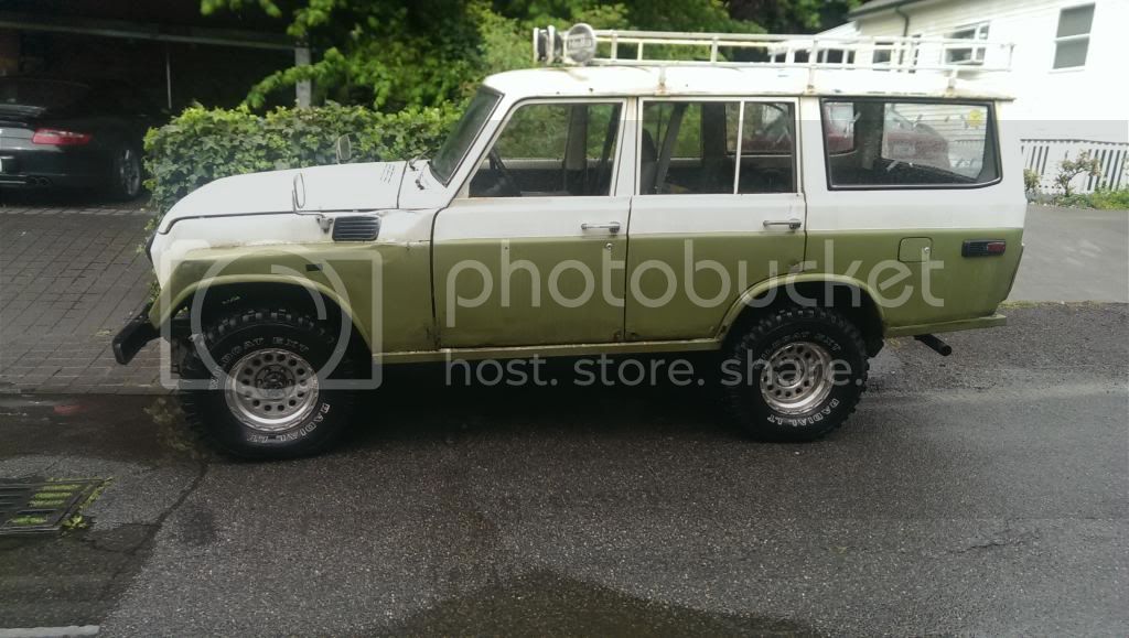

I don't have many pictures right now, but this should give you a general idea of how it looks.
33x1050x15 BFG MT with a 3" lift via shackles and add-a-leafs. Pro Comp wheels that came with the used set will be replaced by painted FJ60 wheels. Would rather have ATs but found a great deal on a mounted set of MTs just to try out the size, which works well with SBC/4spd/4.10s except for road noise.
More meat will accentuate any needs in your steering. Will be replacing the center pivot soon.
