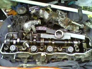

2: Toyota parts are like gold. Everybody, everywhere wants something. Other than being a better carb, the reason I posted that adapter is b/c I believe it will be an easier carb to find. If you plan of visiting salvage yard don't be disappointed with your 1st trip. Toyota's are often the 1st vehicles completely stripped. You WILL have to go multiple times more than likely,...unless your lucky and find it 1st time.
3: Get a list of Toyota CARS that had the 20R in them. As the trucks are the premo item, most often pickers forget about the cars;)
Thats how I got all this, @ $100 from a Toyota Corona I think.
