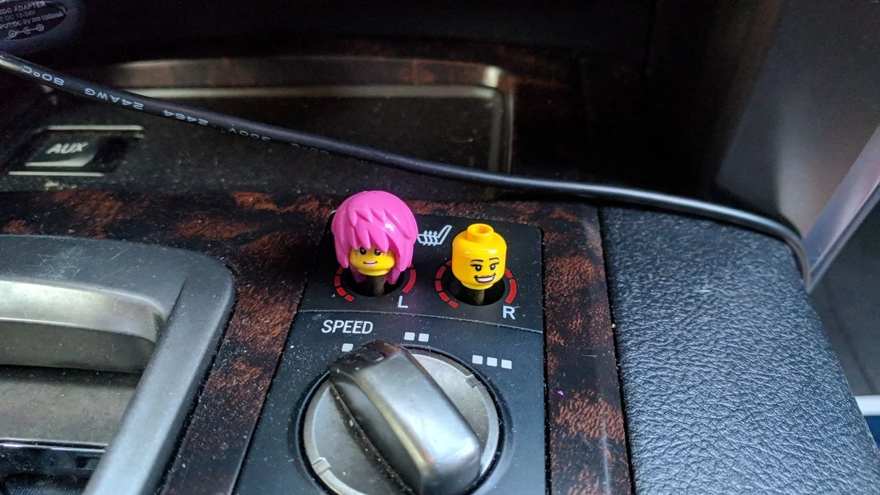

So I stole two Lego heads from my kids, shoved some Play-Doh up there necks and voila new heater knobs.
Quote from dealer was over 300 (380+?) for this, just ordered from the Ebay seller and will let folks know how it goes. I plan to pull the knobs and not go to the trouble of R&Ring the full switch. If that fails I'm going Lego heads too - great idea :D
