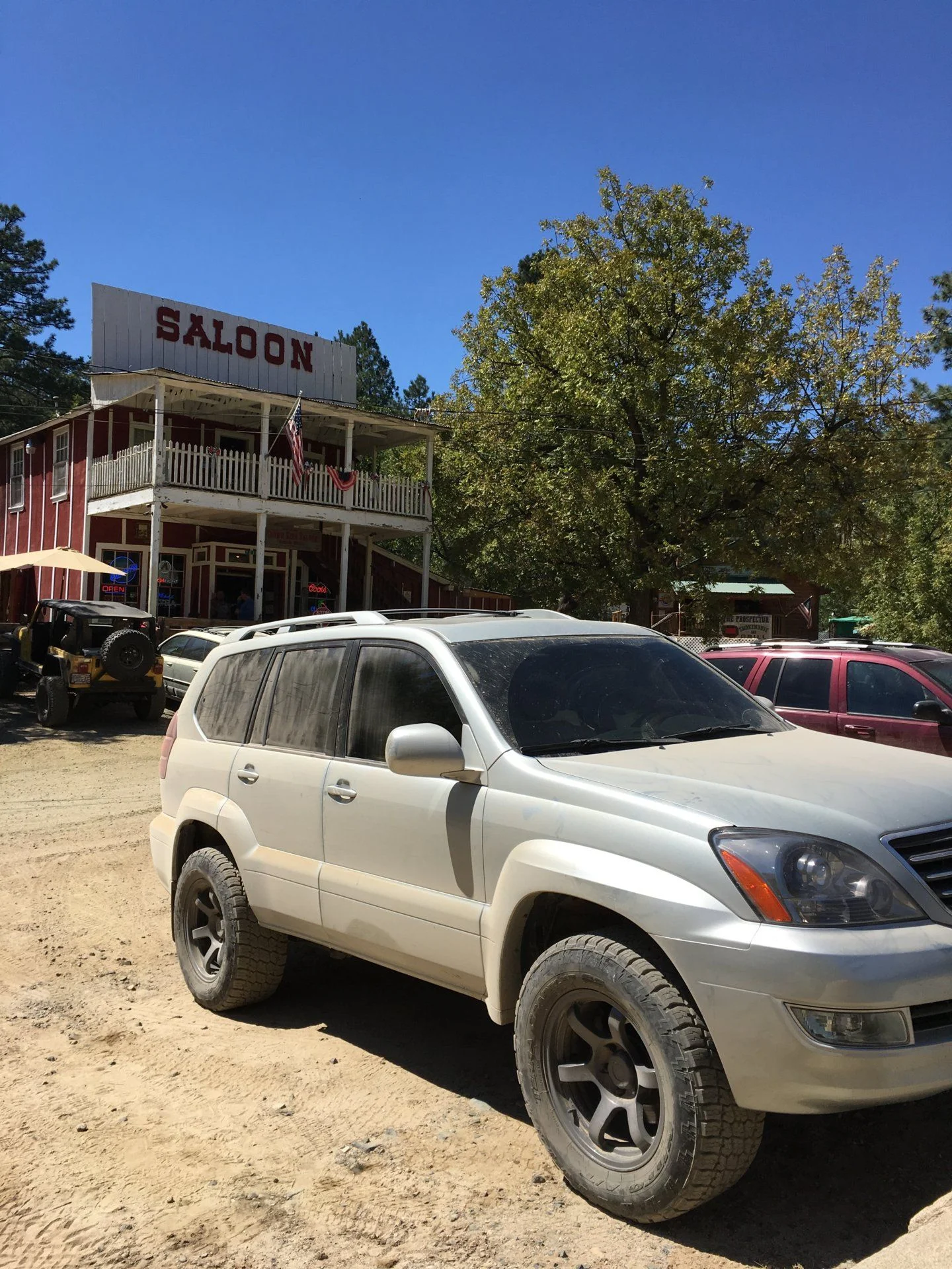

You can do the entire conversion to springs for around $300 if you do it yourself. It’s VERY easy. This is how it was before being lifted, but it’s a metaltech conversion and FJ Cruiser springs. Rode awesome.
