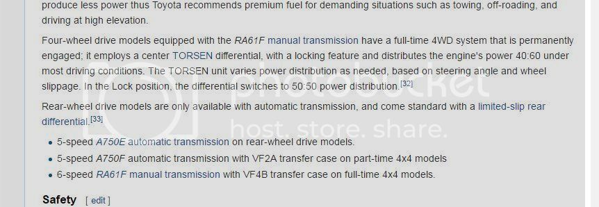

The manual trans are all full time 4WD. On the transfer case shifter is labelled H (high hear, transfer case Torsen limited slip 4WD), HL (high gear, transfer case locked (off road only)), and LL (Low gear range, locked transfer case (off road only.)) On manual trans models the front axle is clutch type limited slip at all times, hubs non-selectable. The rear axle is an electric locker that from the factory can only be engaged in LL mode. There is a simple wiring modification to allow the rear diff to be locked any time which I like for deep snow on the road. I'm informed enough to not engage it on dry pavement. (Given all this I've got 3 different gear oils in mine - Limited Slip in the front axle, GL4 gear oil in the trans (per Toyota's recommendation) and GL5 gear oil in the transfer case and rear axle.)

I own a 6M. It is not full time four wheel drive like a couple of the posts claim. It has a transfer case which will supply power to the front wheels if selected (either 4h or 4L) by the driver. It does not have "locking hubs". Locking hubs allow you to lock or release the wheels from front drive axles so the front differential is not spinning in 2 wheel drive. It helps reduce wear and improves mileage a little. I have owned at least 10 cars and all have been manuals. I have two issues with the tranny. First is that reverse gear is way to high. Every other car I have owned reverse is as low as a granny. This lets you maneuver in reverse without playing with the throttle. Not so with the FJC. The other issue is this is the grabbiest clutch I have ever driven. It sometimes engages all at once and unexpectedly. It is not very consistent. Backing up a hill in reverse is a real challenge.
Maybe you have a unique or non-US spec model? Mine is full time AWD as described by Toyota and Wikipedia?
