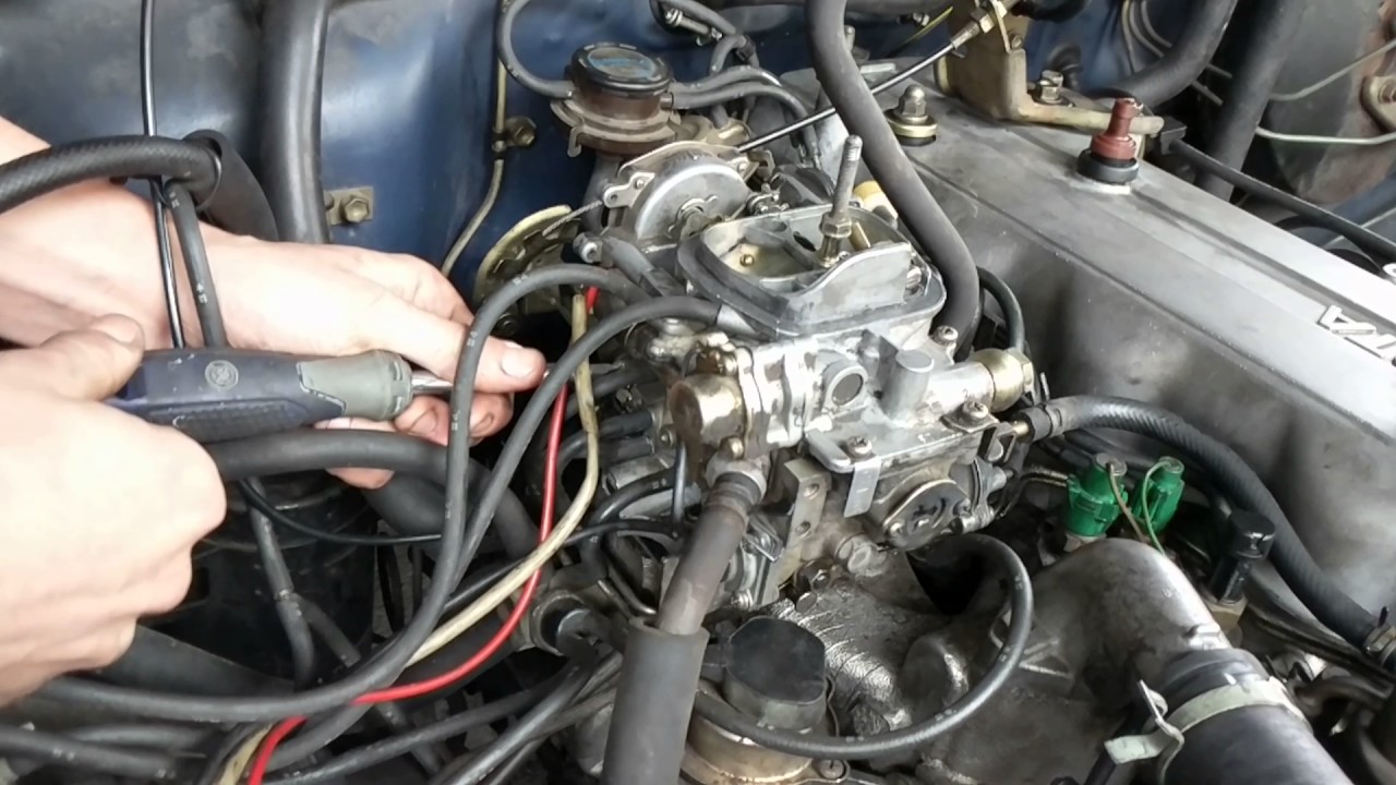

I have a 84 22r that I am doing a carb rebuild on. I am looking for the gasket that mates the carb to the air cleaner. My carb looks like this. Thank you mudders!
I believe @ferg is thinking of the gasket under the carb to the intake manifold.
You want 17848-35010. Call your local dealer with your VIN, then can get it for you.
The gasket for the intake manifold came with the carb kit. The air cleaner gasket was the one I could not find. Even ordered a gasket from ebay that said it was for my year turns out its for a Holley Rochester carb so now I own that...
Thank you KLF. Much appreciated.
You're telling me to use aluminum as a gasket?
Was a bit tounge-in-cheek about the a/c to carb gasket being made from the cardboard box. Doesn't need to be much, just enough to compress and keep out the dirt.
