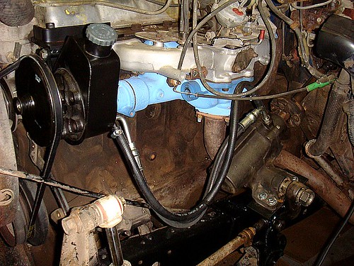

Here is a pic of the 95% completed job....pitman arm from 4runner...

I love the baby blue exhaust manifold :lol:
Yeah it's baby blue!! ;p...at least it's not "pink" or "salmon" for those more policaly correct types :princess: .
I think the "baby blue" gives me a little more horse power....just like "red" goes faster.....:flipoff2:
