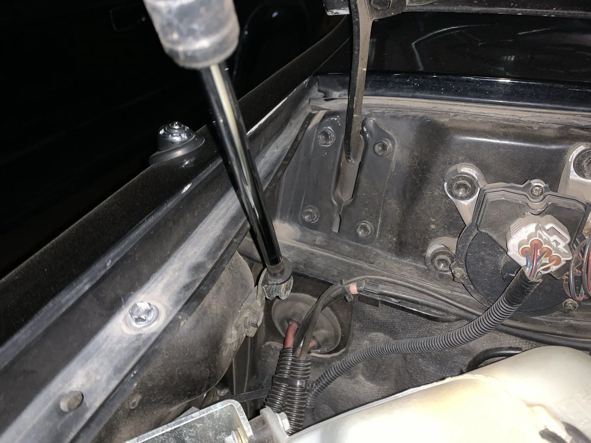

Could someone post a picture of where the gas springs for the hood attach to the inner fender. I think I screwed up...
I'll try one, this is just a quick copy off of google, hopefully it works...

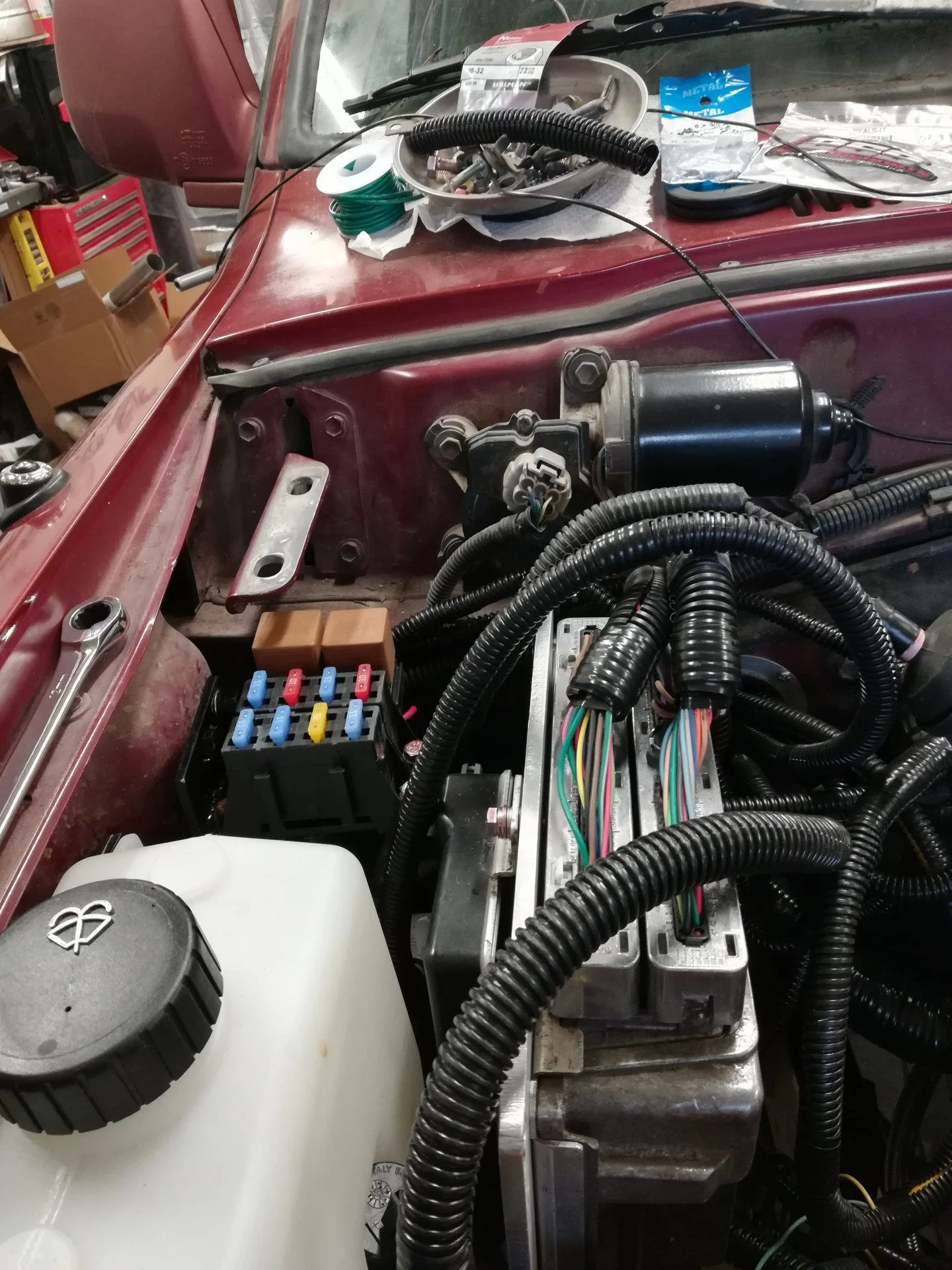

Thanks guys ... I did screw it up. Those spots looked like the perfect place to mount the two fuse & relay blocks for my swap.
Then the new hood gas springs got delivered yesterday, and I lay awake last night going through next steps and realized what's actually supposed to go there :bang:
The fuse blocks may not be to bad ... I might be able to just space them out in the same location. But the relocated washer bottle may be a real problem. I think that's right where the gas spring needs to go with the hood closed.
