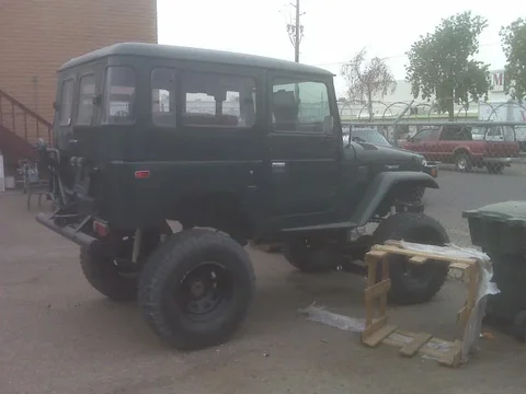

Oh and they had this little number in the parking lot... (crappy cell phone pic)
It can be yours for just $6000 OBO
