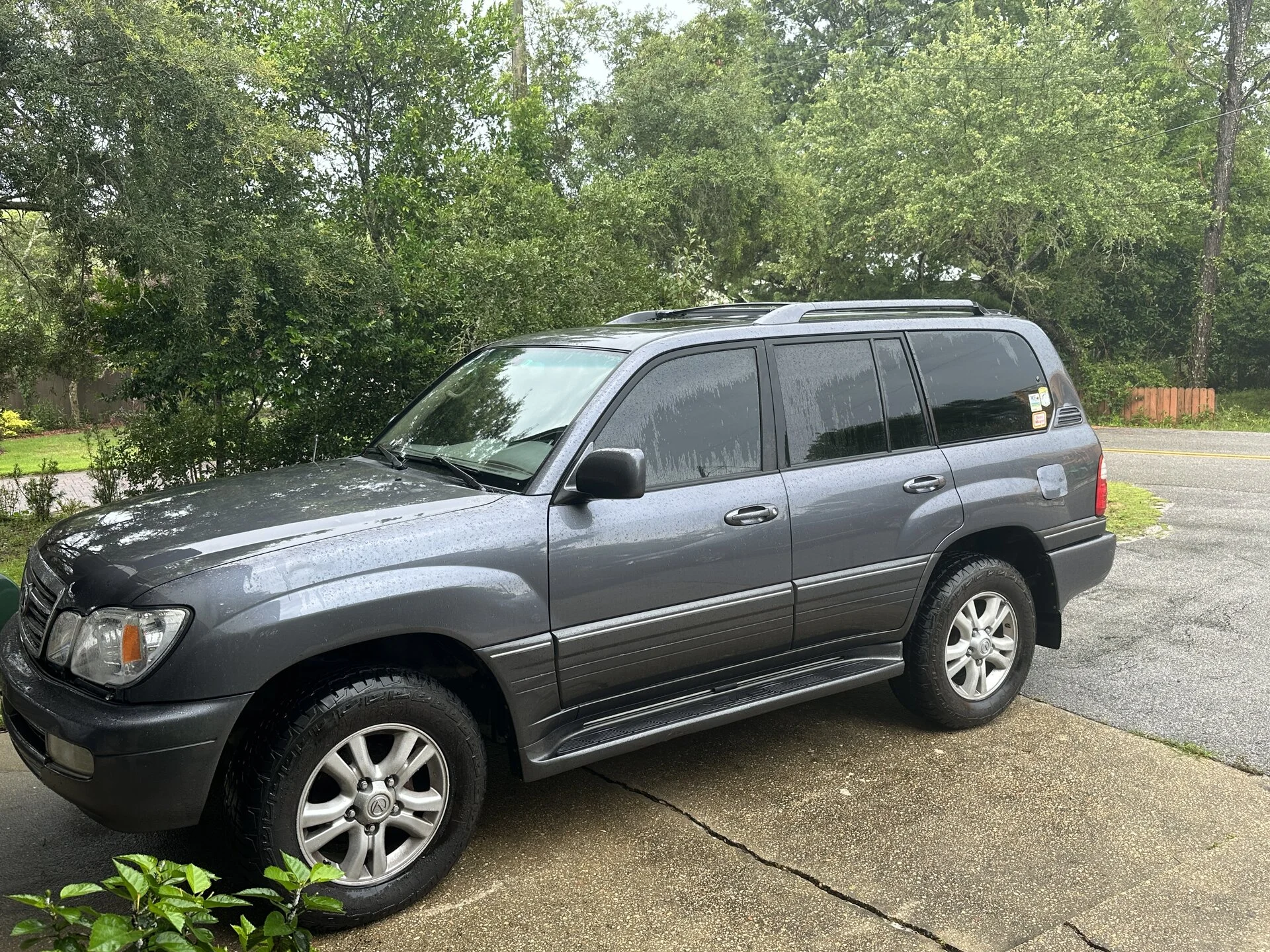

I just bought a 2004 LX470 with 161K miles that came complete with a few whiskey dings and scratches. I've managed to clean it up more than I expected and now really want to get it closer to former glory. I immediately had the timing belt done with new water pump, alternator and battery. I also had to have my hard break lines replaced as one split on the way to the shop. The ACH has already been deleted in the rear but L and N seem to work in the front. Most everything in the interior seems to work but I really need to replace all the speakers while keeping OG look. Any suggestions?

Also does anyone know what type of tires those are in OPs picture?
