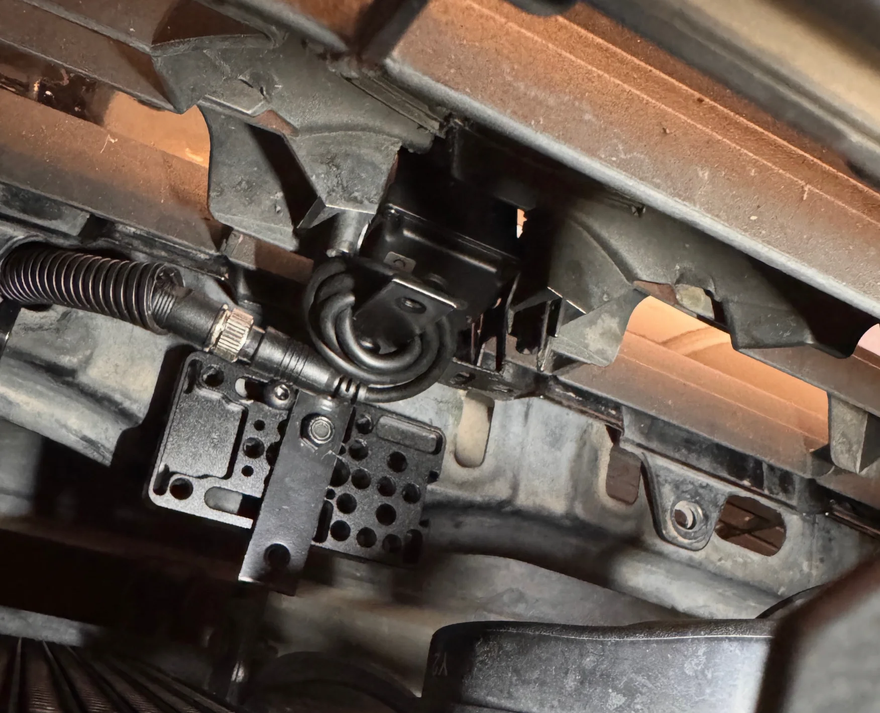

I bought this carplay screen unit about 6 months ago. It's about $150 and comes with 4 cameras. The cameras are kind of old school looking chunks, but they are much higher quality than the small AV cable based ones. My goal was a bit different, I have an off-road trailer that's not small and I wanted off road cameras for wheeling, so I went this route. I've been using it for 6 months daily and it's rock solid. It has a bright sharp screen about 50% larger thanmost of these (though it is a polarized screen so bad with polarized glasses).
It has 4 camera inputs and a dvr that can be set to security record. You could probably find smaller cameras if desired. I bought extension cables and routed three channels back to my hitch. I mounted one camera under my 'L' in the grill with a little help from my Dremel. I ran another long extension along my trailer roof to a camera I mounted on the back of the trailer. When I'm driving I can see the rear camera split screen so I know when someone is about to get brake checked. On the trail I can see a full 3-4 feet closer to the bumper in front with the camera vs. what I can see above the hood. I plan on adding the remaining two cameras to the front sides of my trailer to see around the corner when I'm backing while turning.
The caveat is that you have to figure out how to mount it. I have an touring rig so I've already bit the bullet and screwed Expedition Essentials mount to my dash (amazing, highly recommended). I used a ram ball mount that lined up with the mounting holes on the back and I used plenty of lock tight on the tiny screws. No issues after wheeling all summer. The umbilical is about 6' long so I routed that through the plastic ignition button cover but you could route it along the dash without drilling.
I know this is a bit more than most will want to do, but if you wish you could add the off-road camera system you never got from Toyota, this is a great option. The screen and the camera are MUCH higher quality than all the OEM stuff of this generation. The old school touchscreen on the gx is 800x600 I believe, so adding a Grom or other carplay through the circa 2008 oem screen seemed like an underwhelming upgrade to me. The way I went isn't as clean, but the resulting system really high quality and versatile.

I like it. I already have a beatsonic but I might try that unit and just take it out when I'm not on a trail. I would love to be able to see a little better on the trail.

That seems like a really useful system especially for a trailer!

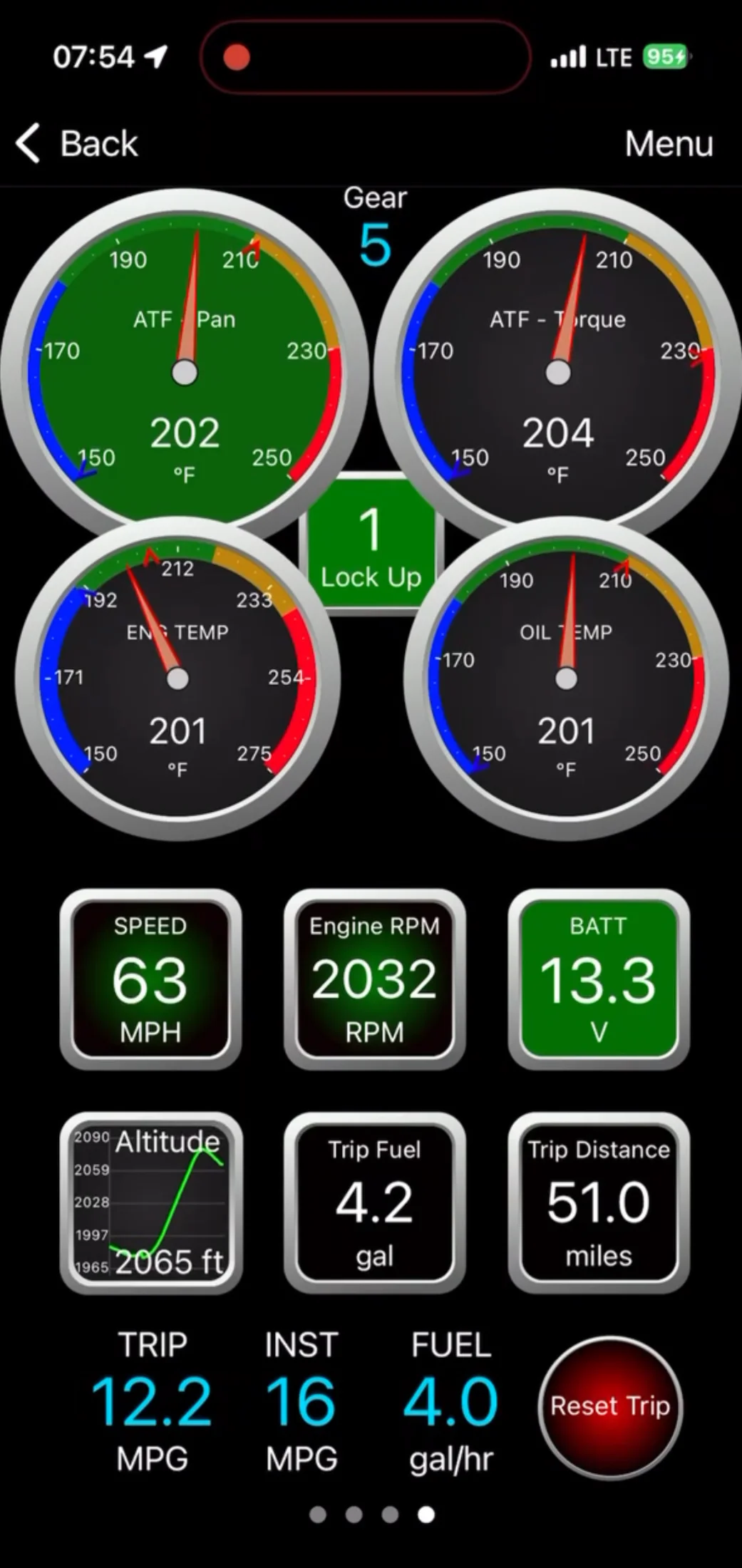

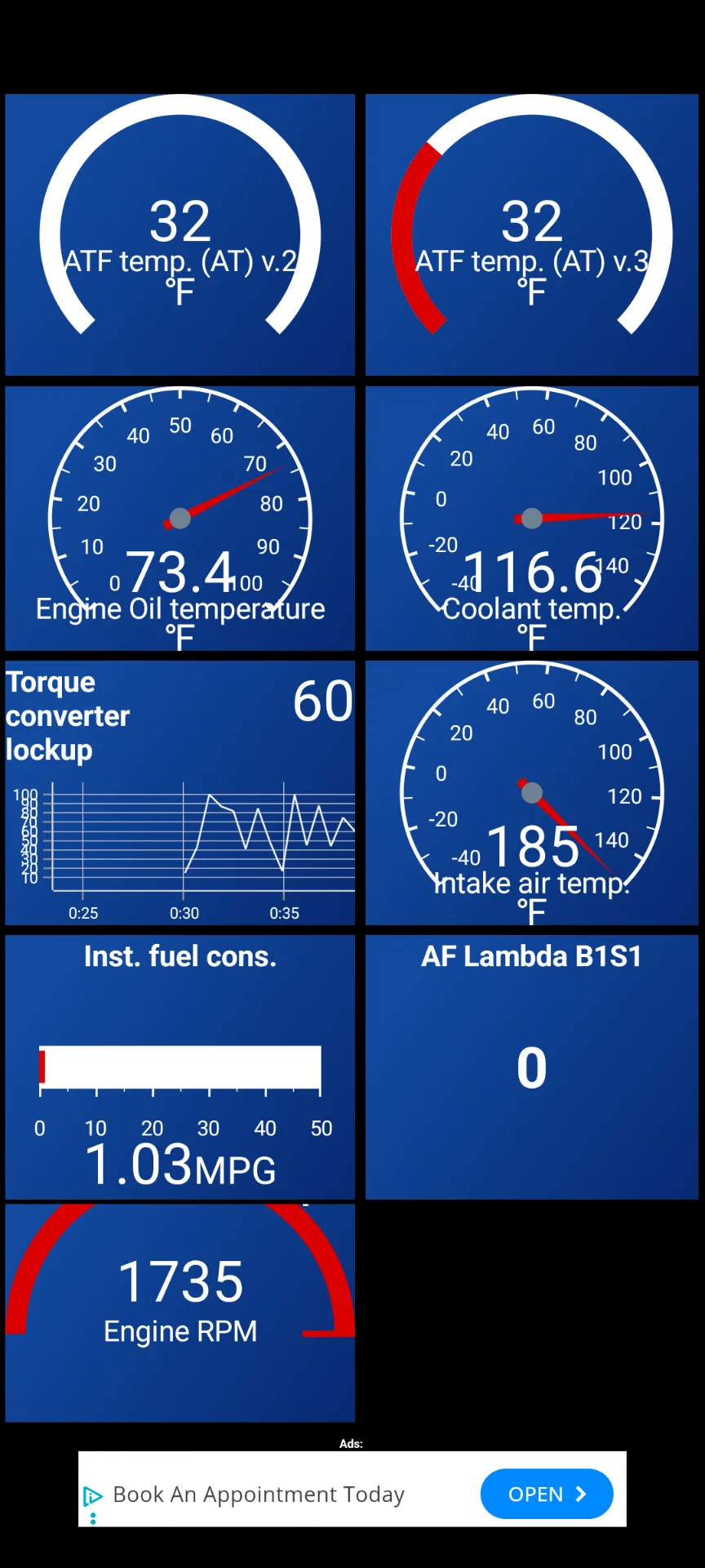

Not to derail the conversation too much, but I discovered last night that the combination of a cheap OBDII Bluetooth Dongle (https://www.amazon.com/dp/B073XKQQQW?tag=ihco-20), and free download of the following car scanner app (https://www.carscanner.info/) allows me to pull up my Trans temps on screen so I don't need to order a Scangauge. It is definitely not the best UX, but I am able to set custom dashboards, AND I can access the app through Android Auto, so I don't need to have my phone out. Anyone that doesn't have Android Auto/CarPlay can still benefit from the functionality, they would just need to use their phone.
For reference this is what the readouts look like on my phone and AA screen. I can't get the torque converter lockup readout to function correctly, in the screenshot from my phone I was in demo mode so all those numbers are meaningless.
....Great minds :cheers:
I'm doing this exact same thing. Actually, one of the reasons for the CarPlay unit is to have better access to the Garmin Switch when I don't have my Garmin Tread with me. Went with the OBDMX+ (https://www.amazon.com/dp/B07JFRFJG6?tag=ihco-20) to ensure it would work with an app on my phone.
If all goes to plan, I can get the CarPlay and OBD stuff set up before the weekend. Will share results.

I ordered the dongle originally to change the Trans fluid; the fact that it saved me from buying a Scangauge is just icing on the cake. I was also planning to try OBDMX+ since their app is a lot cleaner and they have actual brand recognition on forums, but for $24 I had to try the VEEPAK and the free app is fine. When they crap out I will probably upgrade. Good luck, and can't wait to hear how it turns out!
OBD Fusion has the best customization I believe. I used to use Car Scanner but ran out of patients with it's customization options. I built this to monitor trans temps while towing and crawling. It also has the ability to display through carlink but again, text based only, that's a Carplay limitation. I place this in a cradle next to my screen. I run Gaia or OnX on the carplay unit and monitor all the car systems on the phone. When I'm exploring this set up allows me to grab the phone and jump out to tag spots or take pictures.
CarPlay just got updated yesterday with iOS 26 and there are a lot of new features. Maybe Car Scanner or OBD Fusion will be able to build better interfaces with the updates. I'd love to have the ability to build something like this on the carplay unit.
