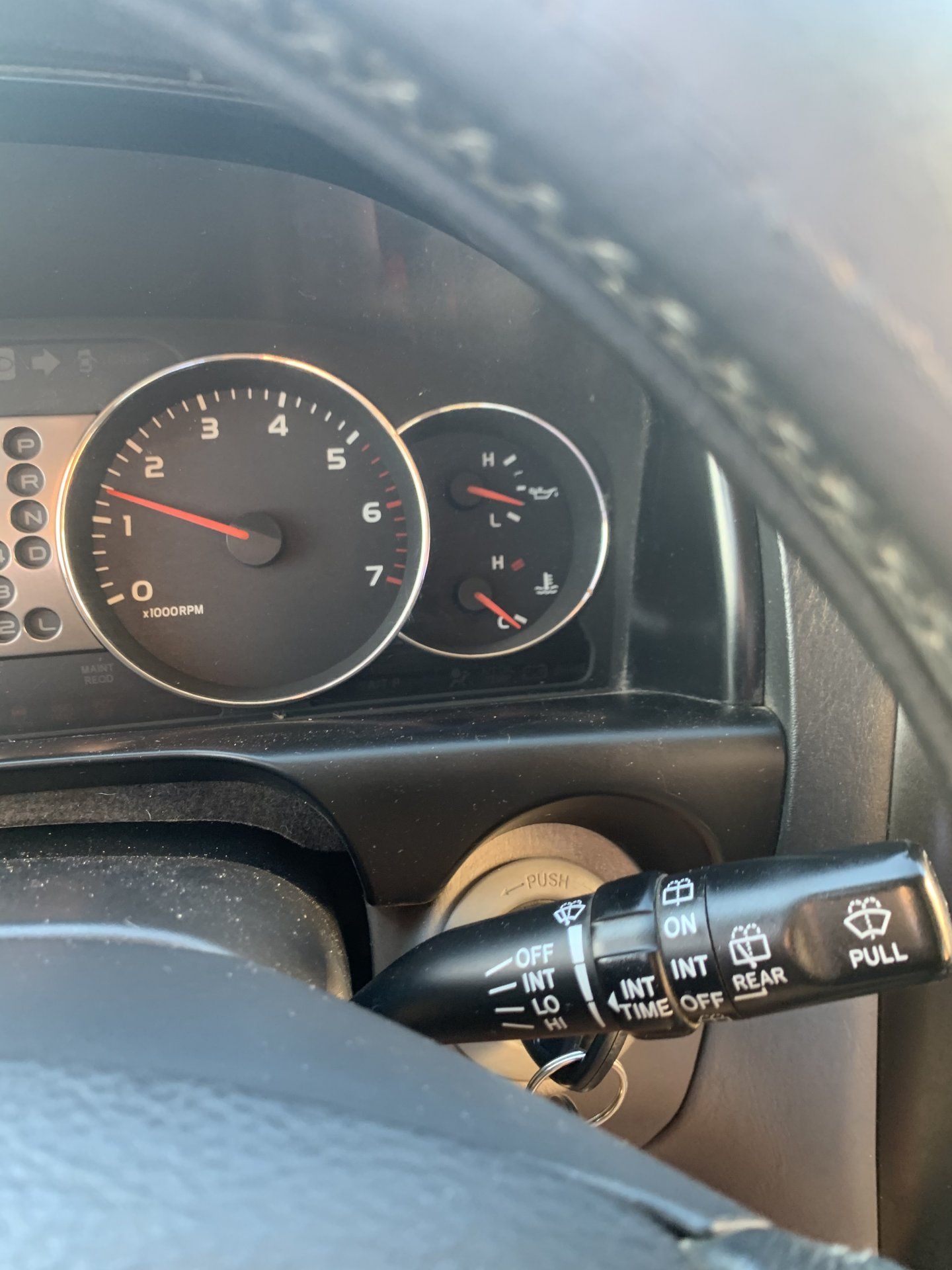

I am having the same issue. Display is dark. No outside temp display. Same message on the display. Engine temp gauge is not working. Cruise control indication not working. But, I don’t have a wet floor on the pax side. Don’t know what to do.
I started having the same issues in Februar/March. Then it went completely fine by itself for a couple of months but it has been back since last week.
Gear indicator/water temp comes and goes, Cruise indicator is not working, but cruise itself is fine, "Check the connection" and no outside temp indicator and the fuel consumption screen is not working.
