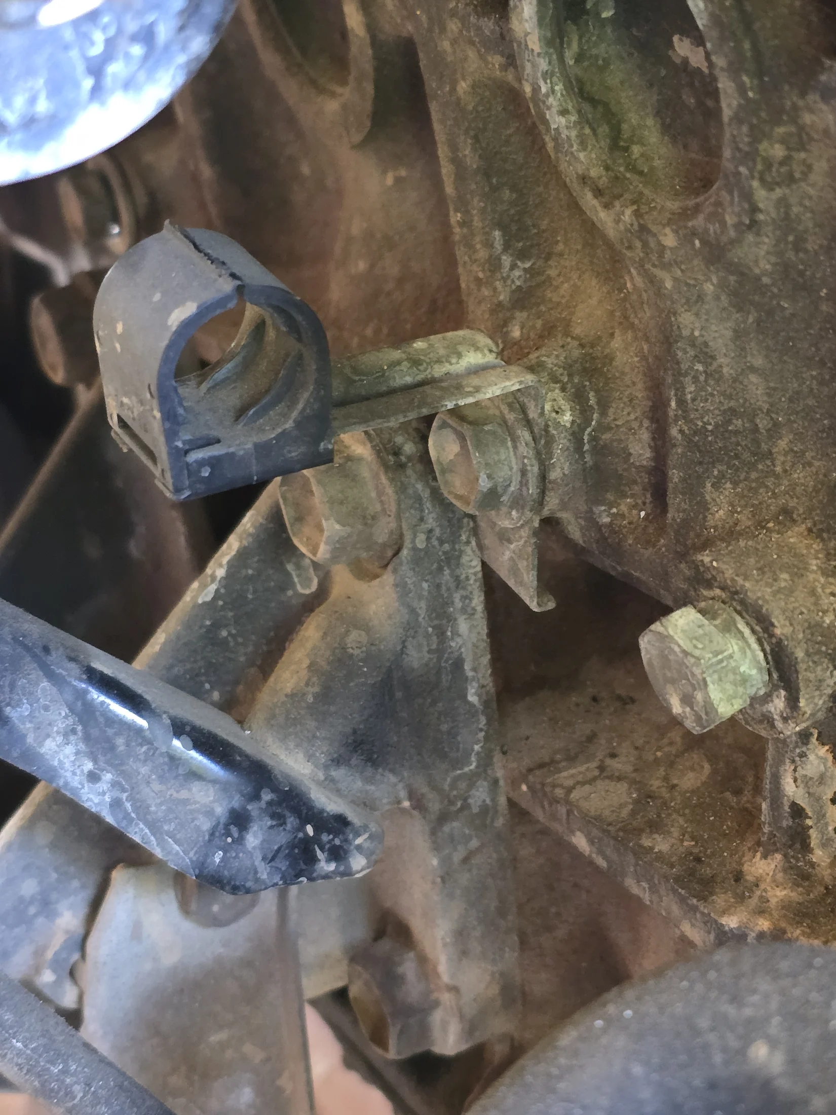

Does anyone recognize this clip from a 97 LX450, would be on driver side near or in the path of the oil filter?
It popped off while I was removing an oil filter and I can't seem to find what the replacement is or where it goes. Anyone have any idea?
Thanks.
Wiring harness clip.
One end would slip onto a metal tab, then clip around the harness.
This, I think theres a few locations for them i think.
heres a picture of one, and how they attach. The one in the picture is under the fuel filter
Thanks, I'll dig around and see if I can find where it popped off. Appreciate the help and photos
If you download the EWD (Electrical Wiring Diagrams) for your truck from the Resources section above, you can identify the exact clip based on the #13 that is molded into it, then it should show you where it mounts or which harness it goes to.

Thanks, I didn't realize that was possible. I will do that, appreciate the tip
