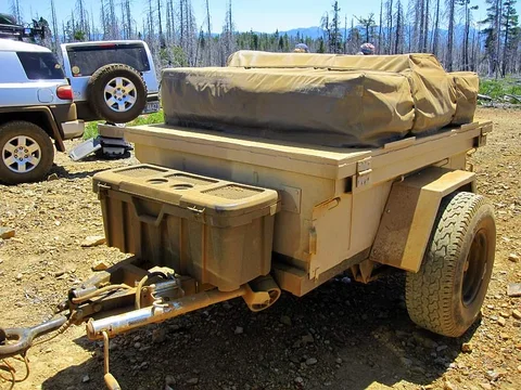

I just returned from a 6700 mile trip with my trailer and I learned that having the tires sticking out from the fenders is not good if you are on dusty roads or on higher speed gravel roads. The trailer made about five times more dust clouds than my truck and also threw gravel forward and put about 50 chips in the paint on the back of my truck by throwing gravel forward.
