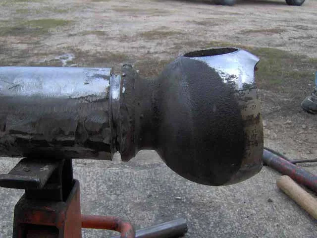

cool... you don't need to do it but if you have minor fab skills as you do you can do it yourself easily enough. Again, first break down the axles completely so they are just the knuckle balls. You will want a front axle rebuild kit from cruiseroutfit or whomever about $100 shipped.. Then, cut just inwards of the factor weld using your grinder to no more than 1/4. That will break the inner and outer housings apart (which are only held together at the factory weld at the end of the housing). Then use a big pipe or a highlift handle or whatever and rotate the axle housing to desired position, pinion pointed towards T case or just below it (if you anticipate spring settling). And rotate caster angle so the steering arms are about 4-5 degrees (using angle finder) increased, so tips of steering arms are farther away from floor. And voila. Then take the whole shebang, the axle, spring perches etc to the welder... You will also want to think about how to mount shocks to the axle housing, I used old 40 series shock mounts welded to the top of the housing. With the Ford towers 14" travel are perfect. Here is are a few pics... 62 front axle (almost identical to a FJ60 axle) under my FJ55...

1) The axle broken down again...
2) How I ground. As this was only my 2nd cut and turn, again I ground way too deep. Because this was at the end of the axle luckily it is not a place where there will be any warping with too much heat, so I layed down two layers of good thick beads to bring the welds/metal back up the stock height. Again you'd be surprized how thin the outer housing is and it should only take one good thick stong bead. But because you worked at a welding shop I imagine you are fine to do it...
3) And other photo of grinding too deep...

My understanding is that the knuckles are pressed into teh axle hopusinga nd then welded together...You want to just cut through the housing an dno all the way through,,,Once you cut the housing then you can turn the knuckles where you want them...
Knuckles are a press fit into the housing by about 3" or so.

And BTW, I always have used a 4" tubing cutter. The only reason that some prefer the grinder method is because it leaves a very nice gap to be filled in with weld.

yes that is correct. You grind the outer housing no more than 1/4" deep. Leave the inner housing in tact. You DO NOT cut the whole knuckle off... The inner housing and knuckle are all one piece that Toyta slides into the outer housing from the factory, sets the caster (same technique described here) and then welds together at that outer weld. Basically you are grinding so the weld does not hold them together any more. If you wanted to, as this stage, you could pull the whole inner knuckle out of the axle housing but the point is to basically rotate it to the caster angle of your choice. So... say the axle is set so it has 0 degrees of pinion angle stock, and +2 degrees of caster (arms lifted off the ground = + caster). Then you grind off spring perches and clean up axle. Then you point pinion towards t-case. Say that takes 10 degrees. So your pinion angle is 10 degrees. Because your caster previously was +2, and you want +4 with 10 degrees of pinion, you will have to rotate knuckles 12 degrees total. Then, with the pinion at 10 degrees, you add perches so they are at whatever angle the springs are at (usually 0).
I hope all this makes sense.. Maybe this should be a new thread... I dunno. The pipe cutter works very well and correct, it is much harder to go "too far". It still amazes me how thin the axle housing is... But grinder does work well...
