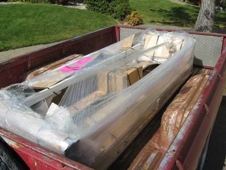

And I should get back on the Cruiser tomorrow because my motivation called. I drove over to Sacramento today and picked it up at the freight depot....
Thanks to all the guys at Slee Offroad to help motivate me!
The rear bumper is calling me from the pallet...

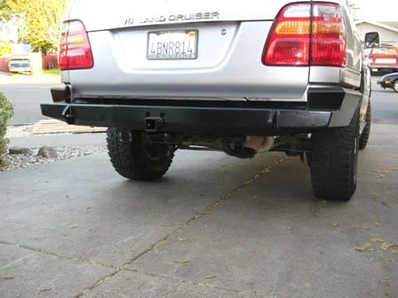

But I did get the bumper installed.
