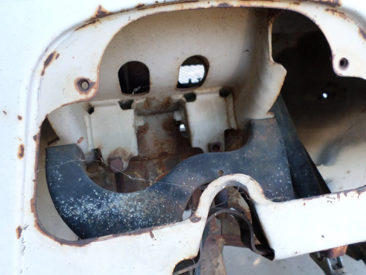

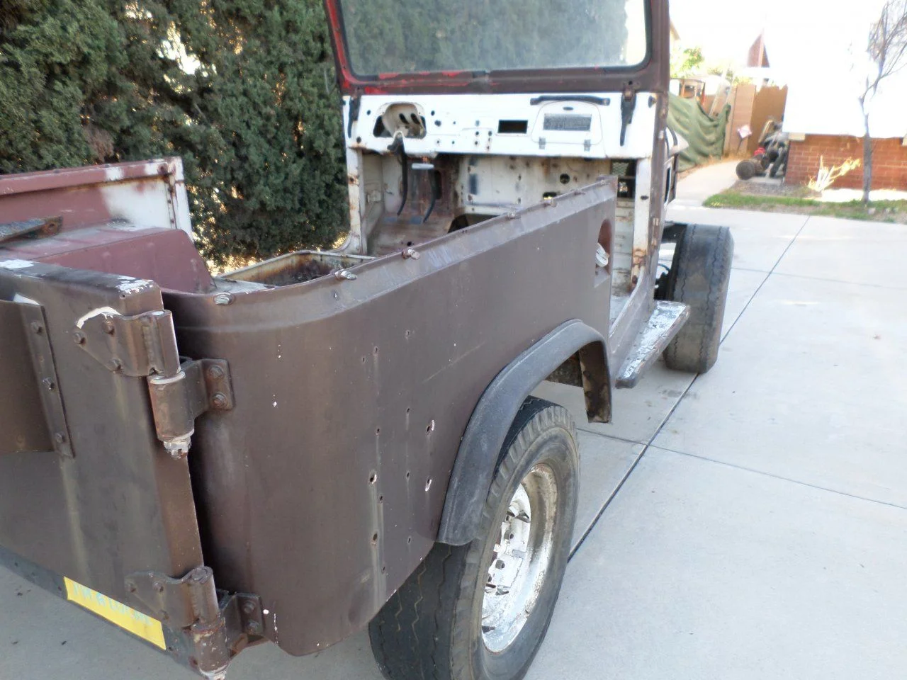

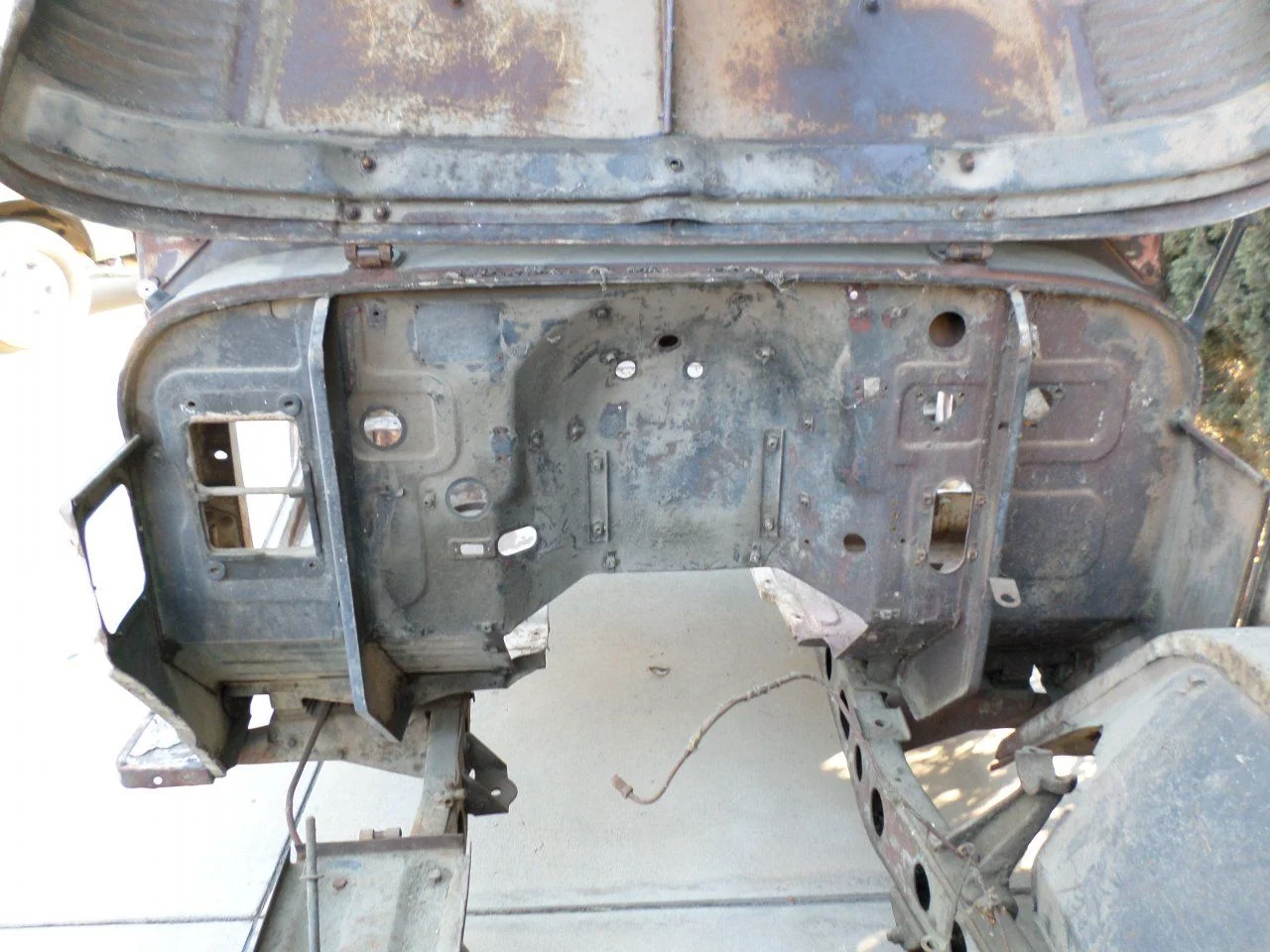

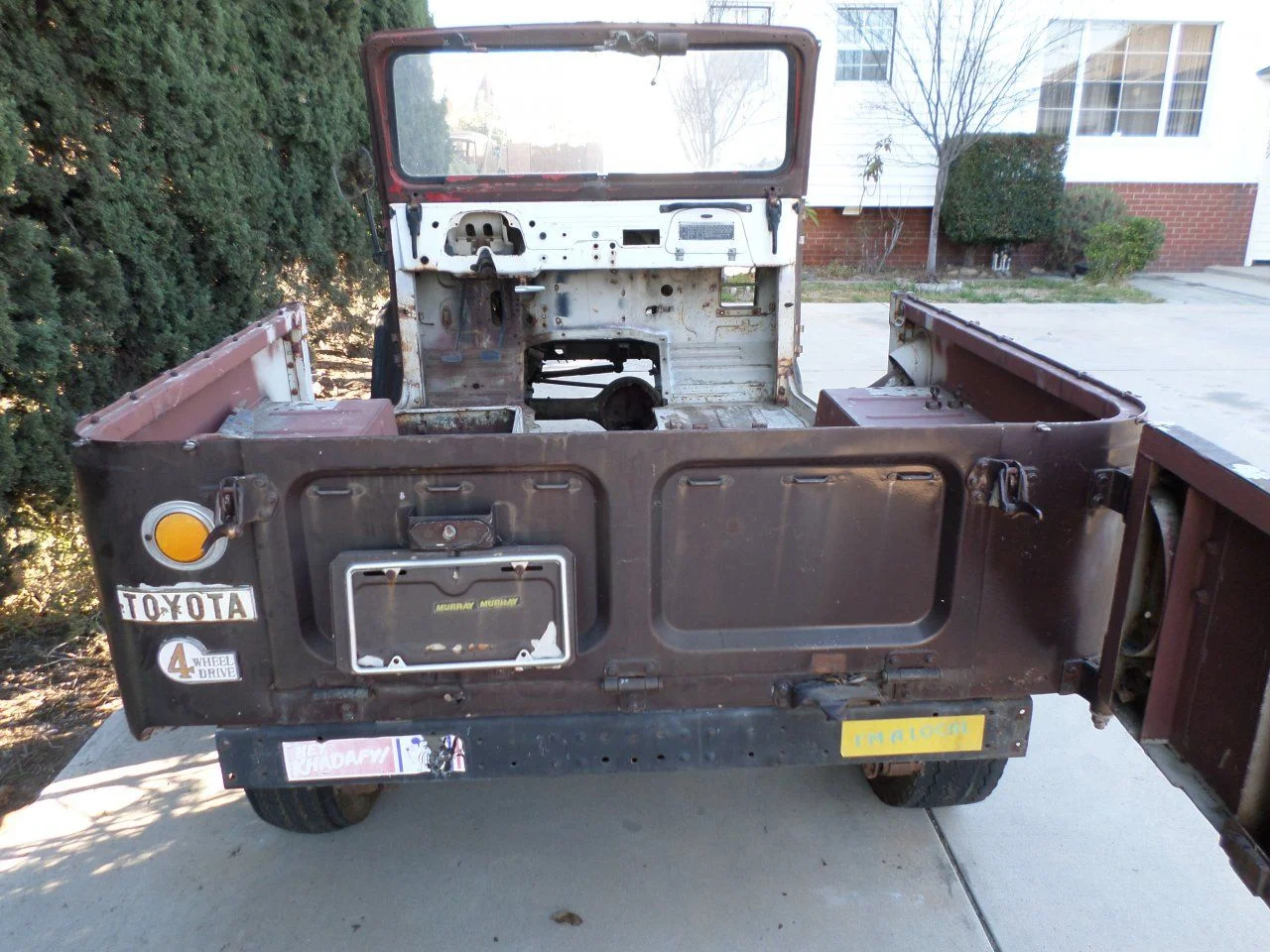

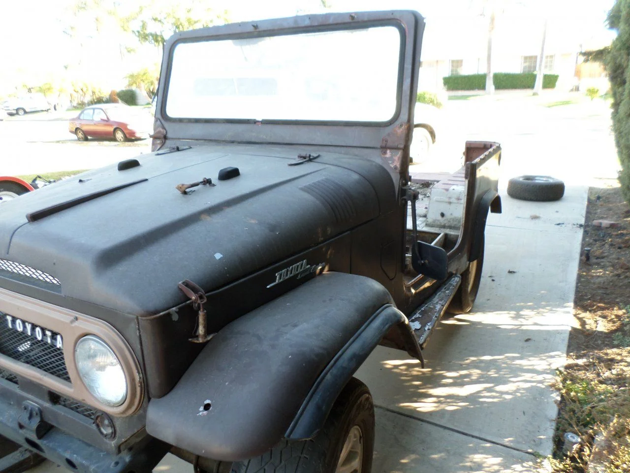

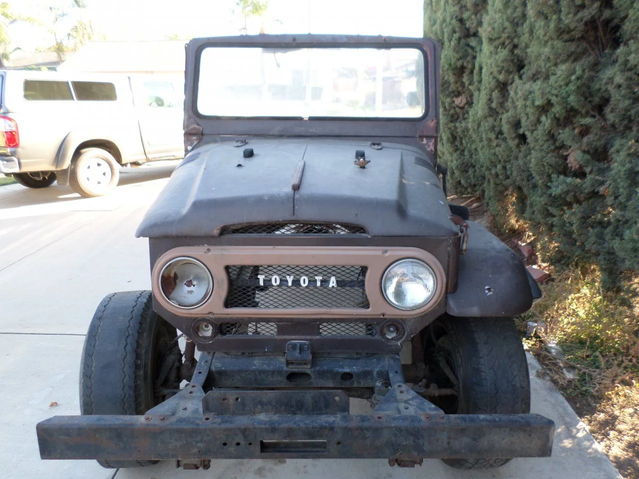

So, I finally got the 64 this afternoon. I have to be honest, Once I had it parked it my driveway, I thought to myself "what did it I get myself into?" Here are some pictures.
Over all, the body is in pretty nice shape. The only flaws I see are a few surface rust spots on the driver side floor board and some bubbling on the right side rear sill. The body is much better that the body on my 76 was when I bought it.
It has no engine, transmission, steering components, front third, wiring harness etc... the list goes on and on. I noticed when I was towing it, that the front axle casing was hacked with a saw and has a huge cut. Ill have to replace it completely.
I have the front right fender, it will definitely need some work. It came with a set hard doors that are in pretty nice shape.
