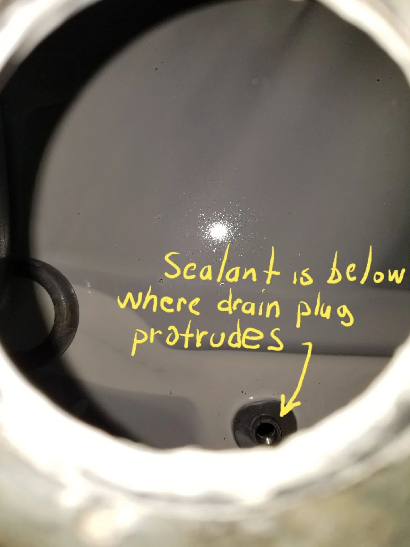

Regarding the drain plug. I guess I'm not the sharpest tool in the shed but I wasn't understanding of how the sealant would work with the drain plug. There weren't any instructions as to how to prevent the Gas Sealer from clogging up the threads or when to leave it in after gas sealant was poured in. Here was my solution: After I poured in the 2 bottles, I sealed off all holes with gorilla tape when I slowly rotated the tank (*). I knew I wanted the drain plug to be last place the coating to dry since this is where the majority of the time, the gas would be. I followed Step 12 (Properly Coated Tank in how to instructions) and make sure EVERYTHING is covered, then pour off the excess once. I found out that draining the sealant from the hole where the fuel pick up is easier. Once, coated for 8-10 minutes twice and coating all surfaces, undo the drain plug. When I looked inside, I noticed there was a lip that the drain plug bolt came up through which I thought no sealant would come through....I was wrong. When I removed the drain plug, the Sealant was dripping like out on the outside of the threads, NOT on the inside of threads, even though the sealant was below the bolt (see pic) . I know it might sound weird but that's how it was dripping. By this time, it was curing and dripping like snot. After it drained, I took some Acetone and used a Q-tip and cleaned the inside threads just in case, then put the drain plug back in. The next morning, I unscrewed the drain plug and left it out. BTW, it had cured enough that had harden.

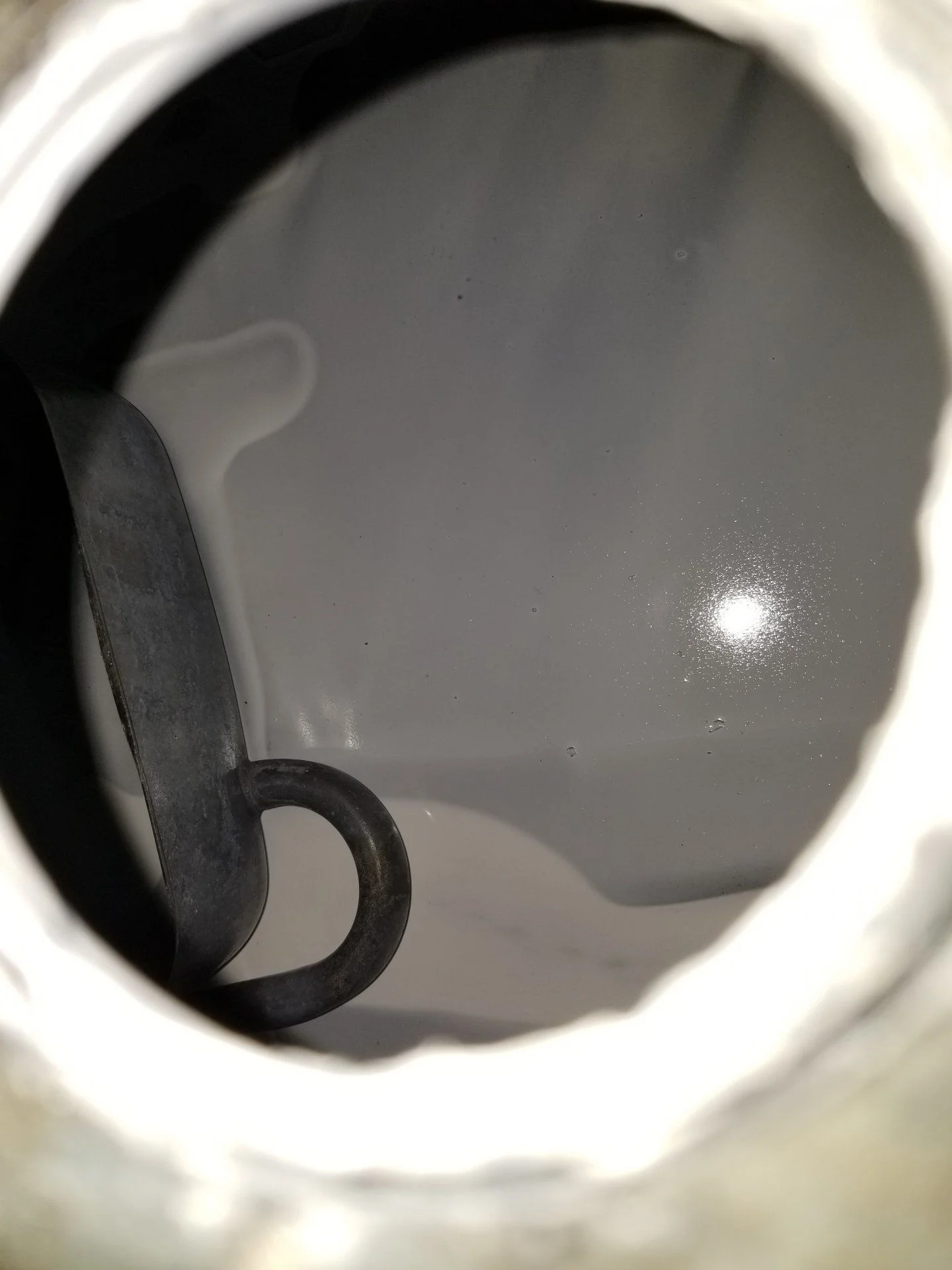

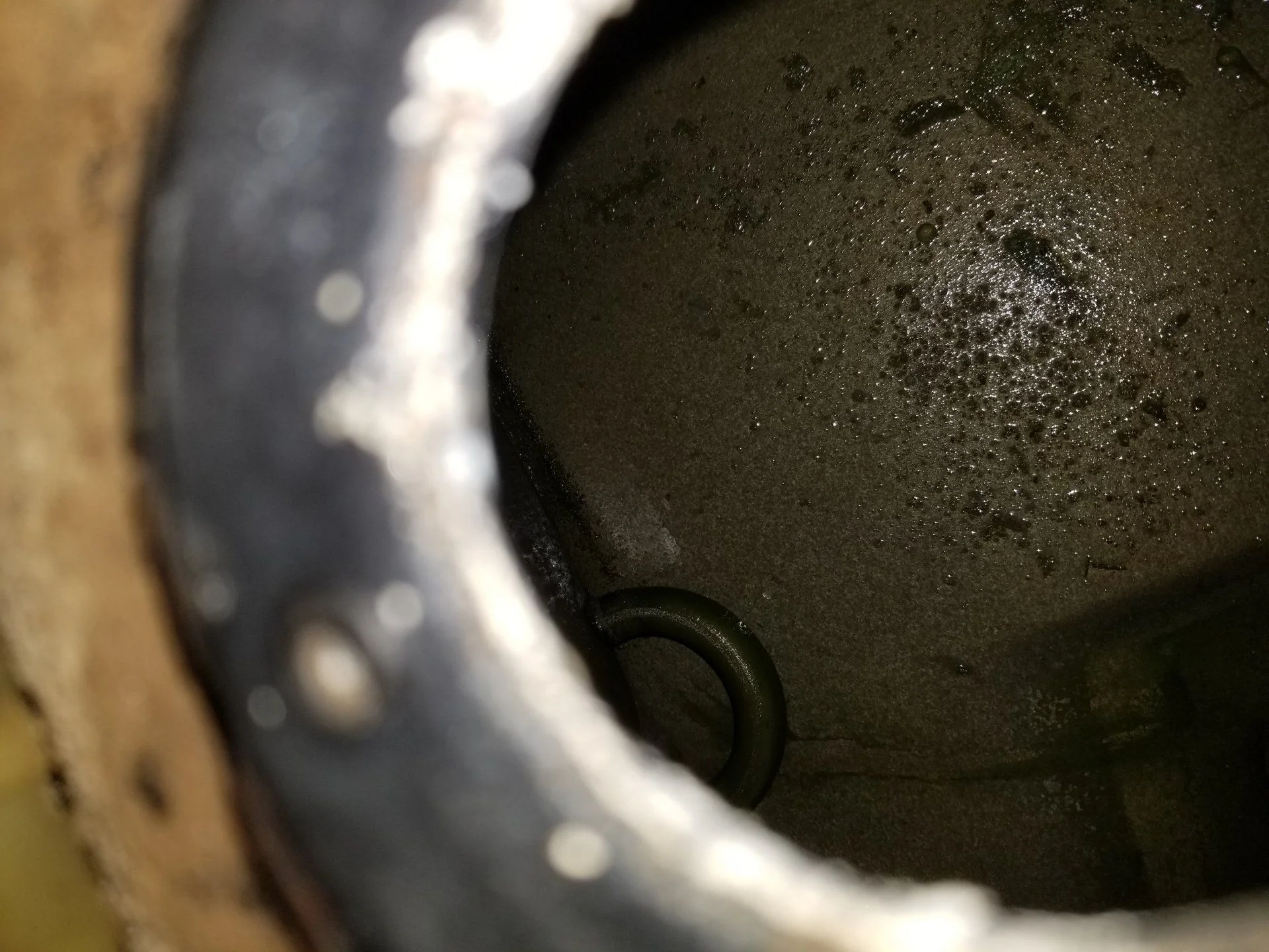

I left it to cure for 48 hours (as recommended) and I made sure my garage was kept at 65F or more so it would cure. Please with end results with last two pics below. I hope these little Tidbits will help when using Eastwood system. The results seem to be very durable but the true test will come when I install the tank with fresh gas and it fires up. My recommendation is do when its warmer weather if you have to do it outside. This can be done within a day easily if there is a well ventilated area and its above 60F.
Drain Plug
Before
After
