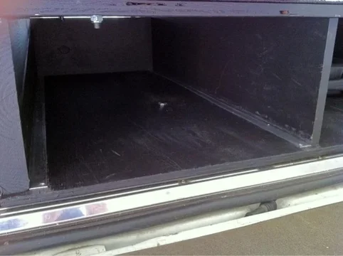

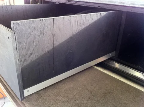

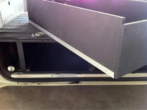

I built the drawers to fit snug inside the openings and used an aluminum "L" piece on the outside bottom corners of the drawers with a set of flat 1" aluminum piece for them to slide on. Them seem to work well do far and were by far the cheapest option.
The 1" flat aluminum runner
