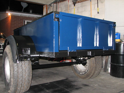

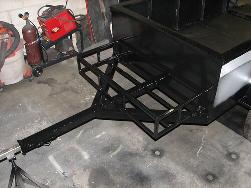

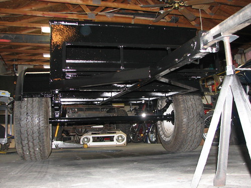

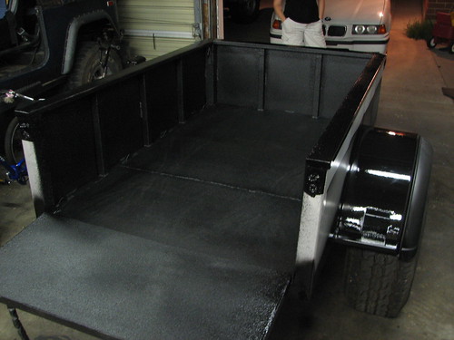

After self medicating and finishing the "Walk with the Blind" this morning, I thought I would get sumthin sumthin done in the garage.

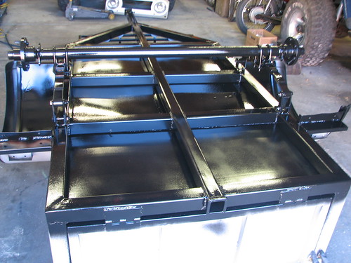

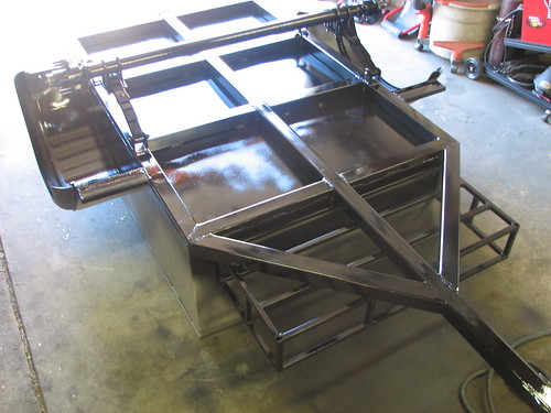

Mountain West paint had some of their store brand of chassis black paint for $25.00 a gallon so you know I couldn't pass that up!
viola
I need to let it dry till tomorrow then I will get around to painting the top and fenders.

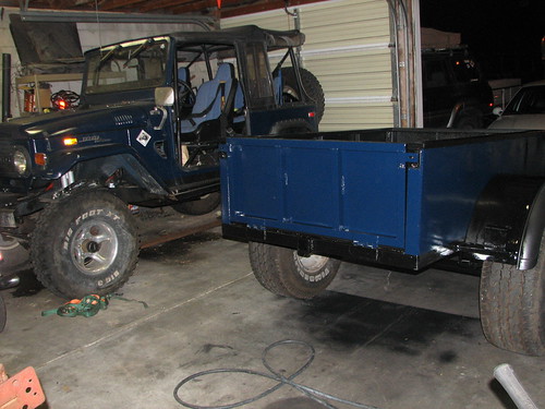

I got a little more finished today after a clogged drain in the kitchen, Where I needed to visit the crawl space...
All the grayish parts, I'm hoping to paint the same color of blue as our FJ40, I masked some of it off and then wondered why... as I'm sure you can tell.
That is looking really nice.
Thanks!

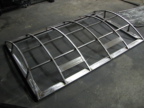

Me and my wife have been brainstorming ideas on how to cover the domed lid, She brought up Plexiglas, I like the idea, But I'm not sure how well it would bend and if it would be prone to cracking where I rivet it on, I was thinking about some light weight steel sheet, But I cant seem to find any that is large enough for a single piece, It needs to be a 50x72" piece, Most of the stuff locally comes in 4x8' sheets.
:hhmm:
Brian,
Neat idea. What may work better is Lexan.
Don't know how a big a sheet it's available in. That might be tough.
Brian,
I did a GIS and polycarbonate*sp is around $300.00 !!! :eek:

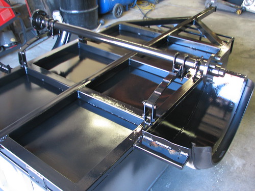

didn't see it, but did you mention what fender flares and mudflaps you used?
if not, bit of info?
TIA
TIA
Sorry about that.
The flares are CJ7 rear flares, IIRC $40.00 for the set from 4 wheel parts.
Fenders were off the shelf 37" fenders from a trailer supply $40.00 a set as well
EDIT...
Crap, I didnt read correctly, Mudflaps were a single Semi truck mudflap cut in half then cut to fit.

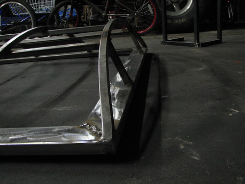

I almost have the lid finished.
All the metal is welded up, I just need to do a little grinding and then I can paint it, I have some stainless steel being cut to cover the top, I'm going to adhere it with 3M VHB tape and then get it fitted.
Some of the most recent work.
Brian,
The lid's a work of art!

Work of art... Thanks! But I would not call it art. :cheers: One nice thing about the lid rib's that go front to back is I could hang lighter items from it if necessary.
Square and boxy is the best shape, It makes it easy to fit stuff.
