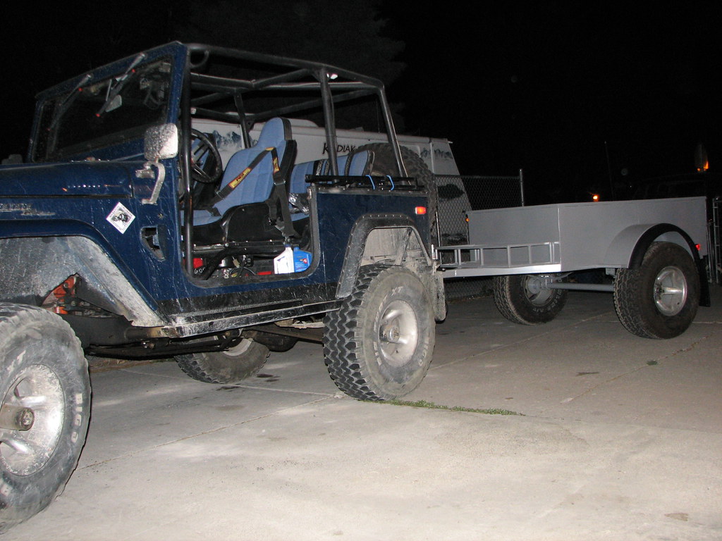

My plagiarized trailer.
Welp, Here are tonight's pic's.

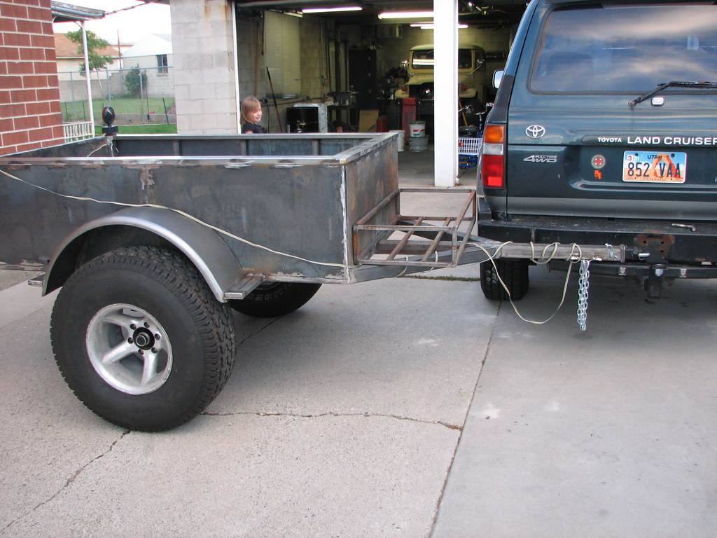

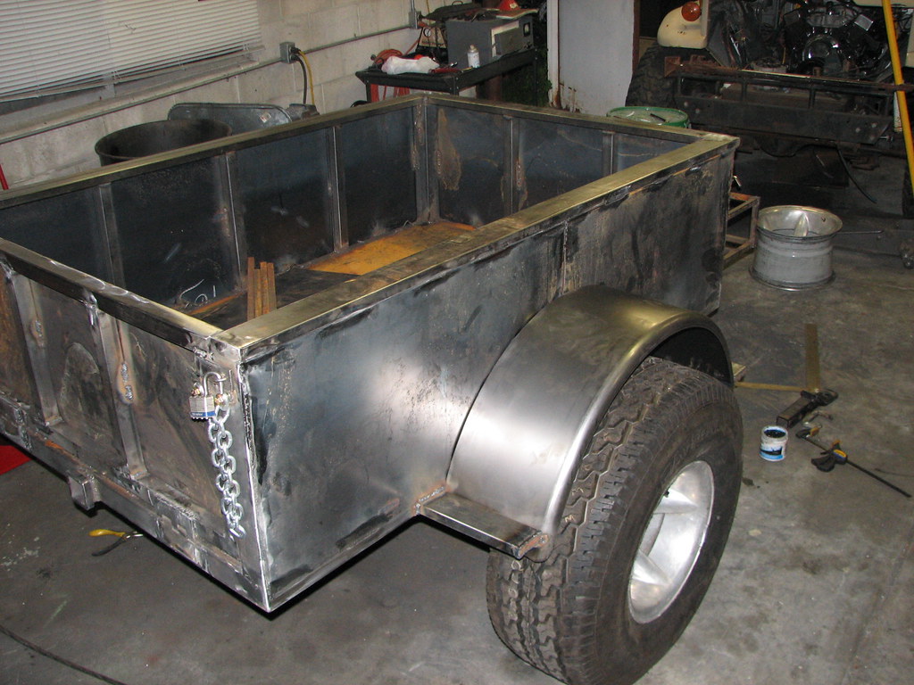

I'm not thrilled about the round fenders, But I couldn't find any squared type that would fit a 33" tire locally.

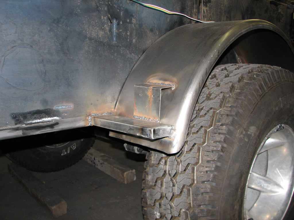

I added some steps, As you can imagine they will help getting in and out on the side and hopefully they will add a bit of protection.
Definitely need some fender flairs.

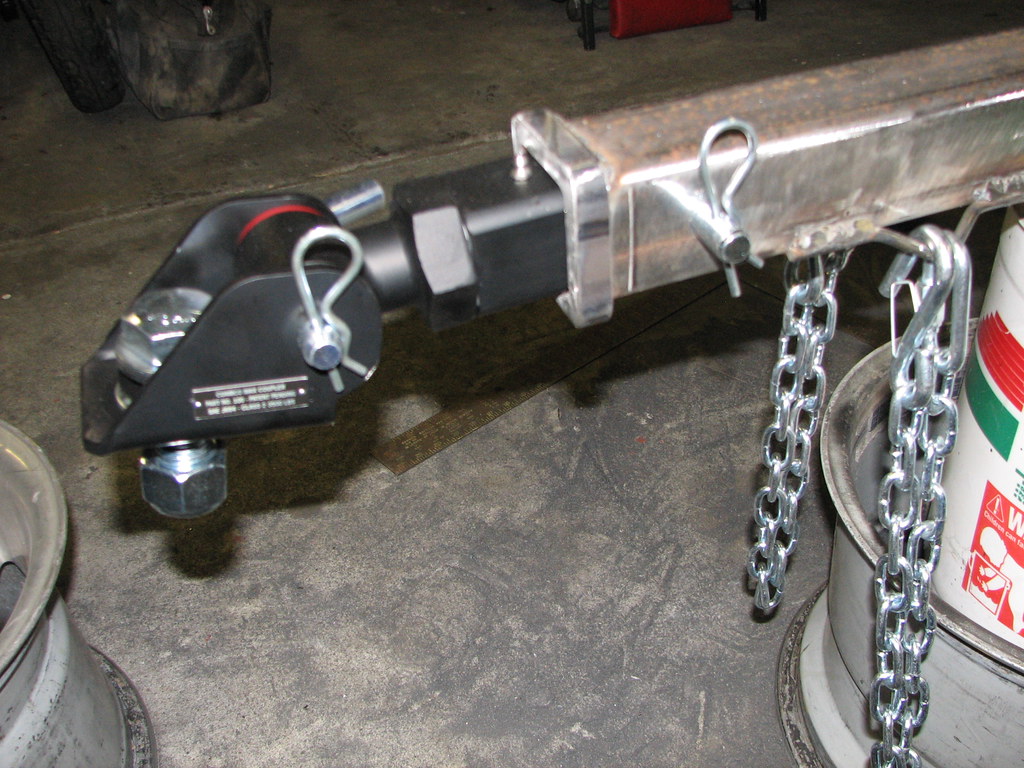

Of course the Max Coupler installed.
along with some new safety chains.
Not too much going on here other than I built some tail light brackets, Towed it around the neighborhood to see how it would go and it pulled very nicely, I also did a bit more grinding.

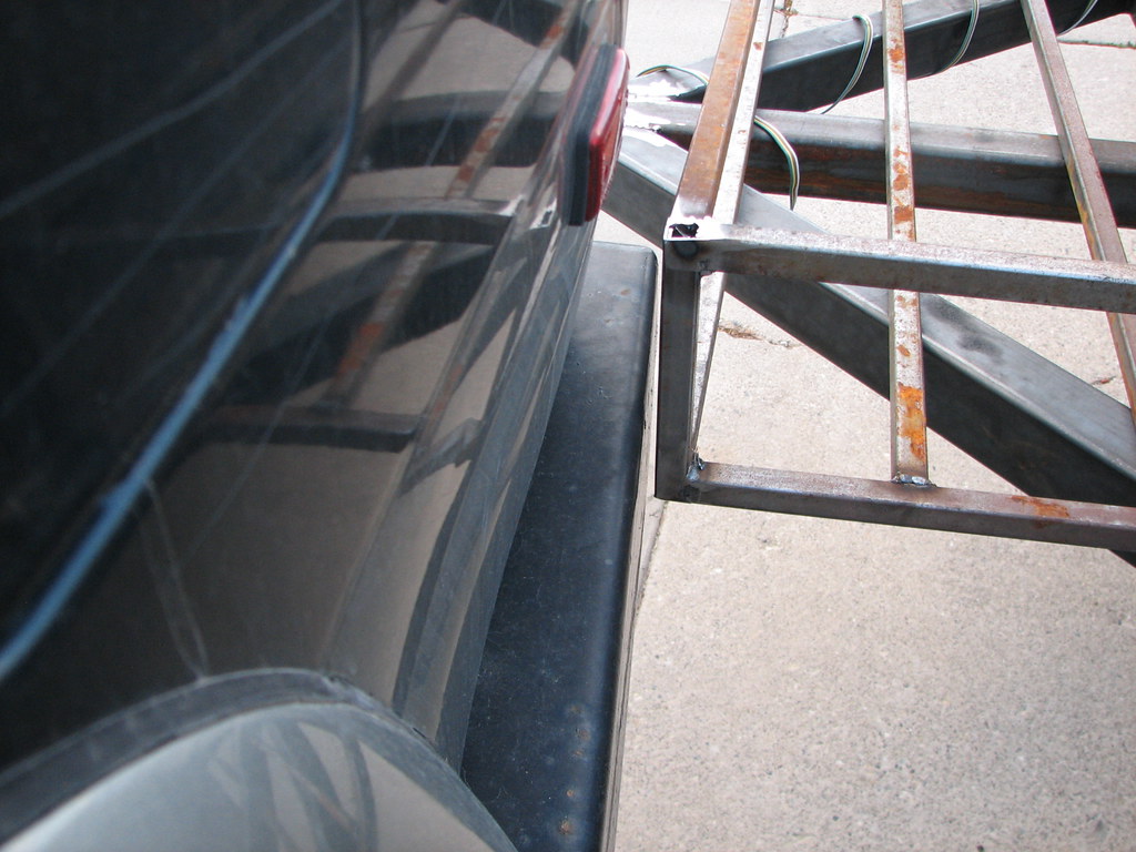

I did manage to jack-knife it at the school without the basket and I had a good 4" room between the rear bumper on the 80 and the trailer frame.
Sorry no pic's.
I have an appointment in a little over a week to get it sand blasted and primed so I can get it painted :cool:

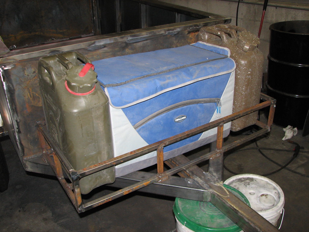

Here is a pic of what I plan to use the front Basket for.

Got it back at about 4pm today, It came in under bid at $150 for the blast and prime, I took it straight home behind the 80, Towed wonderful again.
I got to work on the wiring, I stopped by State trailer supply in WVC to see about one of the tail light converters, They had just what I needed for a cool $17.00 I wired it in and it worked perfectly! Then I got to a few other things I took off for the work to be done.
After the wiring I started in on the fender flare and mud flaps, Unfortunately I only got one side finished before it got too late.
I drove it around the block and it feels great so far, I don't hear much noise at all, I even jack-knifed it at the school to see what it would do, I had more clearance than the FZJ80.
Now mind you, I'm taking this on the Relic Run so I don't really have time to paint it yet, Hopefully it wont see much water.
Its finally coming together :)

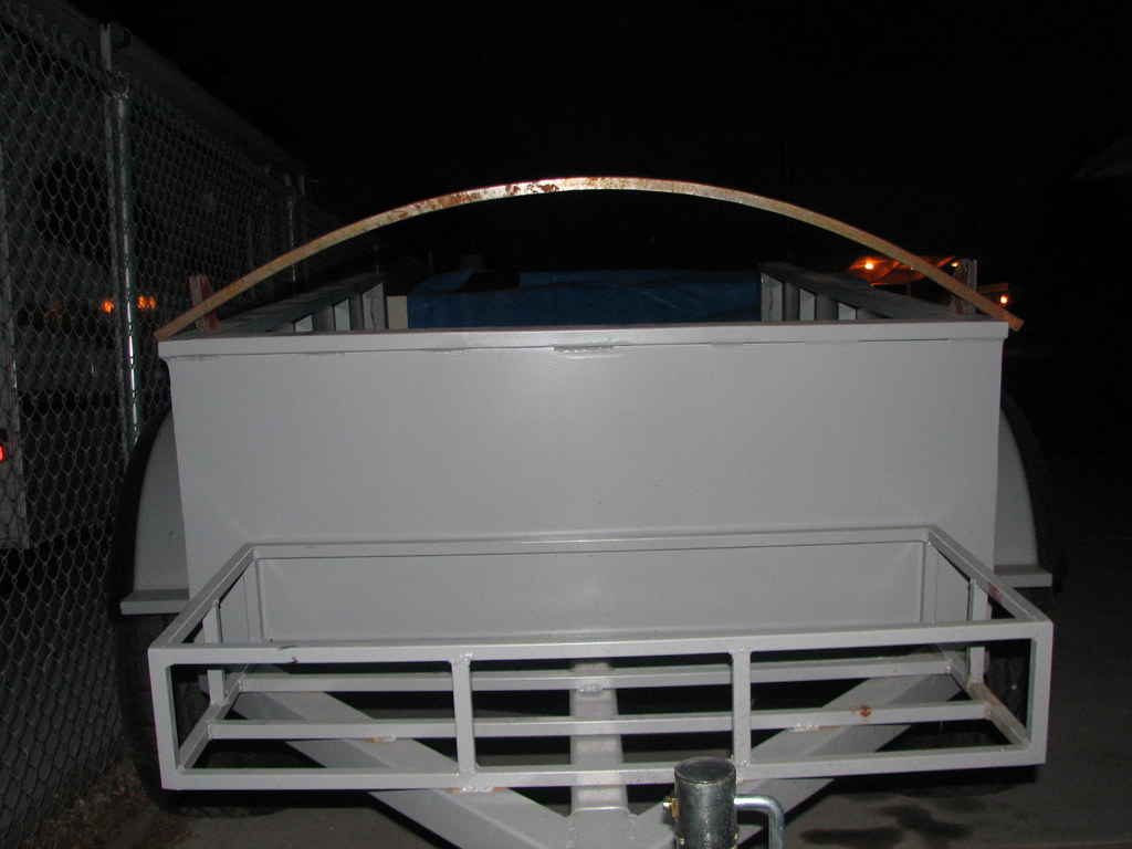

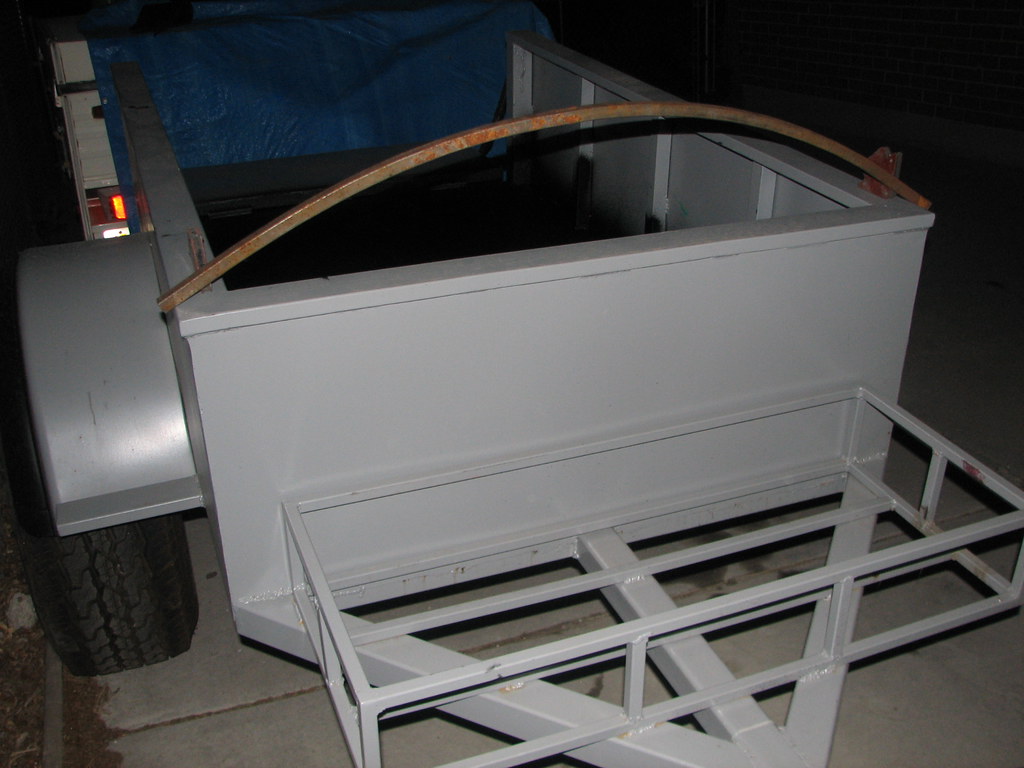

All, I am about to start on the lid to the trailer, Michelle had an idea about a domed top, I wasn't sold, But I bent a piece and I think it could work, The skin would be cake compared to what I had thought about building, Similar to the type Equipt sells, Here is a quickly bent up piece.
The front and back would be flat, Unless I can build an angled front piece, You know for aerodynamics and all :silly:
I have an idea about a removable hinge system, But I would like to try a mock up first.
Thoughts?
A domed lid should work as far as shedding water. The drawback is putting anything on top. You can build a frame, which would distort the clean lines of the dome. Or maybe there's nothing needed up there?
I would not sweat the aerodynamics. Not enough mpg there to make it worth the trouble of streamlining.
I would certainly be building a frame, 3x1" tube for the mating surface, Then add 6-8 of the curved rib's with support bars running front to back, We are planning on putting a RTT up there, So it would need to be somewhat strong.
Like I mentioned, I am working on a hinge system so I can remove the lid for utility duty.
Yes, I was totally joking about the aerodynamics.
Thanks for the thoughts :cheers:

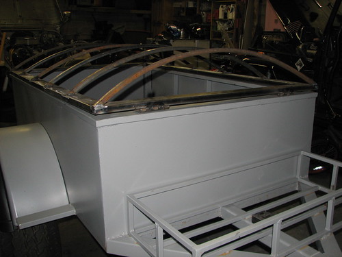

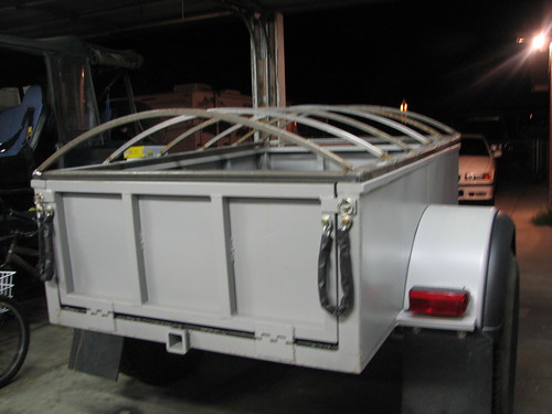

Decided I should get crackin on the lid, Here are a few pic's of the work I have done the last few days.

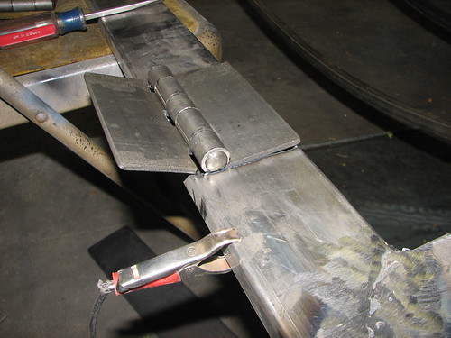

After building the rectangle framework, I had to figure out how I was going to put some hinges on it, I decided the best way for me to go was to plaz out a hole and weld in the hinges.
I've also finished bending all the roof arches, 6 total, I bent them with my HF tube bender.
I want to add a few bars running front to back to keep the arches in place, I'm thinking I will rivet the outed cover on this time rather than weld, I also need to figure out the tent mount, But thats another day.
