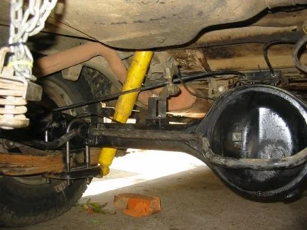

I got the pinion angle set and the spring perches tacked in today. Movin right allong.
Start sorting out the brakes and such tomorrow PM. Once I get that done I can pull the FF back out and weld it in for good. Ought to be rolling on the FF by the end of the week.
Greg developed a new technique. Looks as if welding the springs to the perches is the in thing now.
It was a really pretty weld though.

Today:
Got the LSPV bracket made.
Got the Ebrake bracket bolted in and almost set up, will finish it on final install.
Almost got the swaybar link brackets made.
Tomorrow's plan is finish those brackets, pull the axle back out and weld them all in place. Should be rolling by late this week.
Big thanks to Heath for his help and his big brain.

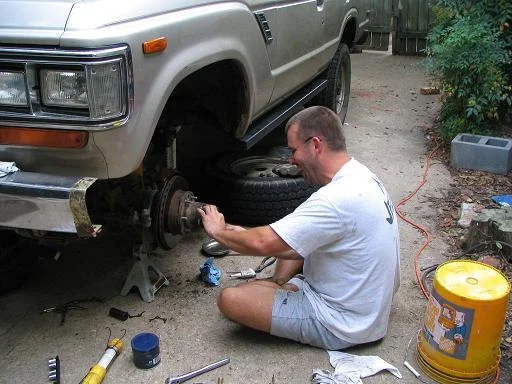

All bolted up. Took it for a test drive last night. Gotta work out some bugs, but the backs pretty much done. Re-bleed brakes, find a rattle, that kind of stuff. Hope to wrap that stuff up this PM.
Update and thanks:
3:00 today- truck goes on jack stands
3:30 Jeff and Brian show up to help
8:00 test drive the truck with the new front diff including an unexpected pinon flange swap!
In case you don't know that's a ton of work. We had to tear the front axle down and pull the drive shafts, then unbolt the diff, then find out that the driveshaft doesn't bolt to the diff which means we had to swap the pinion, then bolt everything back up including bleeding the brakes. LOTS OF WORK, SHORT TIME!
Wow, can't say a big enough thanks to Brian and Jeff for helping out today.
Huge thanks to Heath for helping for 5-6 nights in the last week.
Huge thanks to John for all his help.
What's left is plumbing the ARB. Still not positive how I'm gonna do it, but I'll be takeing my time with that part.
Thanks again guys.

A few pictures from the front axle tear down & rebirth::eek:
Looks like we are gonna have to tear it down again to do bearings and knuckle bearings. I talked to Gary about it and I bet it's in the front.
