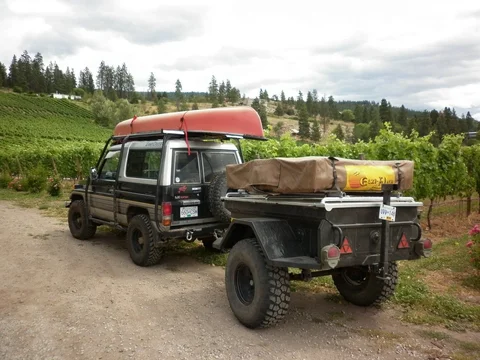

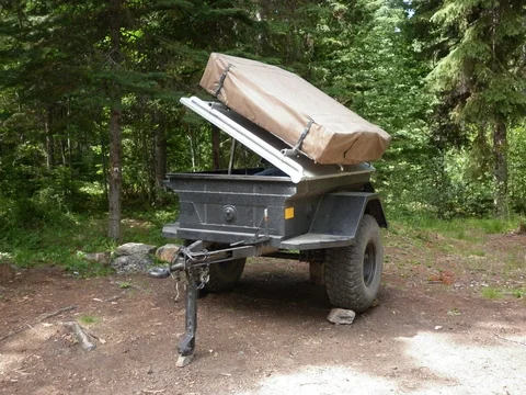

Well I f inally found the m101 I've been wanting for such a long time. Quite a bit of surface rust to take care of, but otherwise it a solid little trailer. Already sitting on 35" tires, widened fenders, nose box, side mount table, and a lid ready for a roof top tent. Started prepping for paint last night and hope to have it ready for camping in a couple weeks. I've never done a paint job like this before, so any pointers you can give me would be much appreciated.
Now I just need to find the rooftop tent. As I've already blown my trailer budget, if anyone in southern bc has a decent used one, I'd be interested in taking it off your hands!

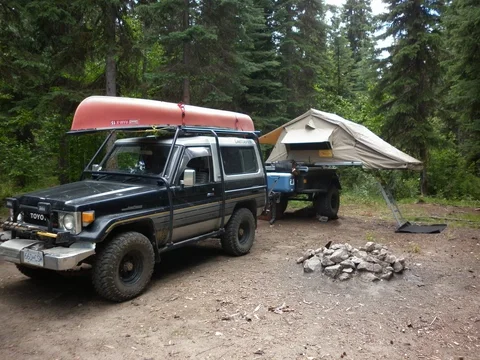

Been on a couple short camping trips already and the BJ74 has to work a bit pulling this thing. I have always been slow going up hill, especially when loaded with all my camping gear but the trailer really slows me down quite a bit more. Good thing I'm not in a hurry........ too often!

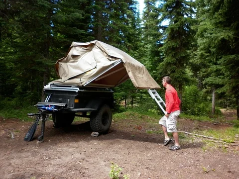

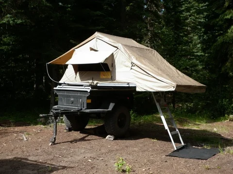

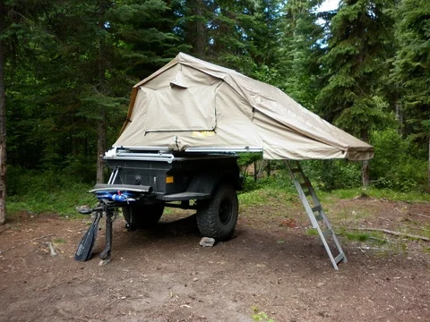

Well I was finally able to pick up the remaining item for the trailer, an eezi awn rooftop tent. Not only is this tent super comfortable and easy to set up, but it looks really cool as well. Only problem is, there's not much alone - quiet time at the campsite anymore cuz everyone stops by to ask about it, and of course the truck as well.
Also have the annex room for underneath the tent but when its on the trailer its too low to use. That will have to wait for a trip without the trailer and I'll put the tent on the truck.
