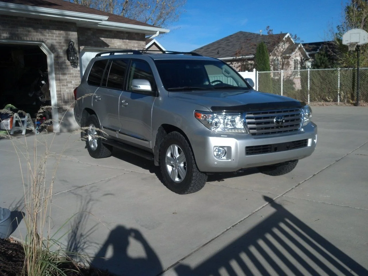

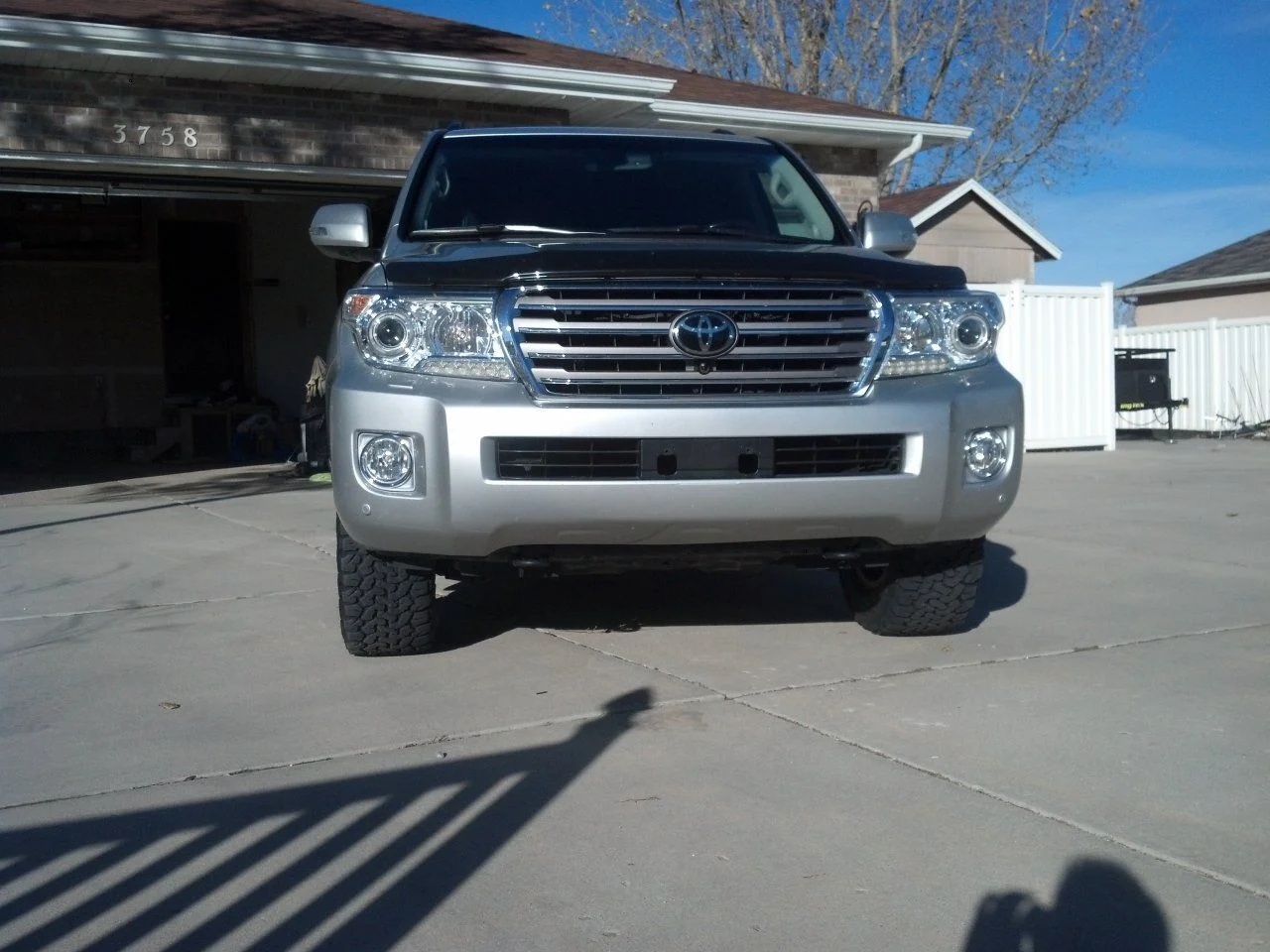

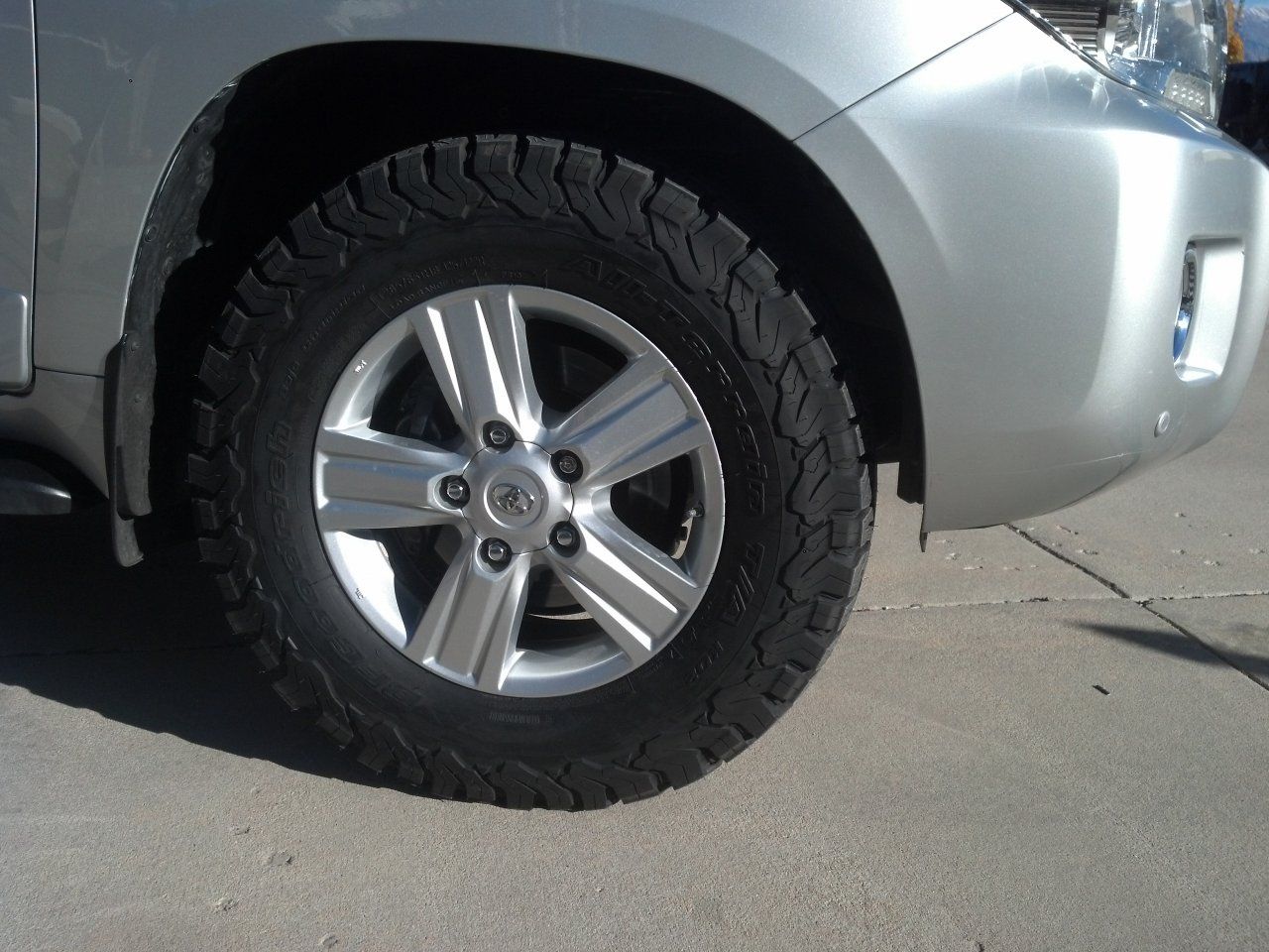

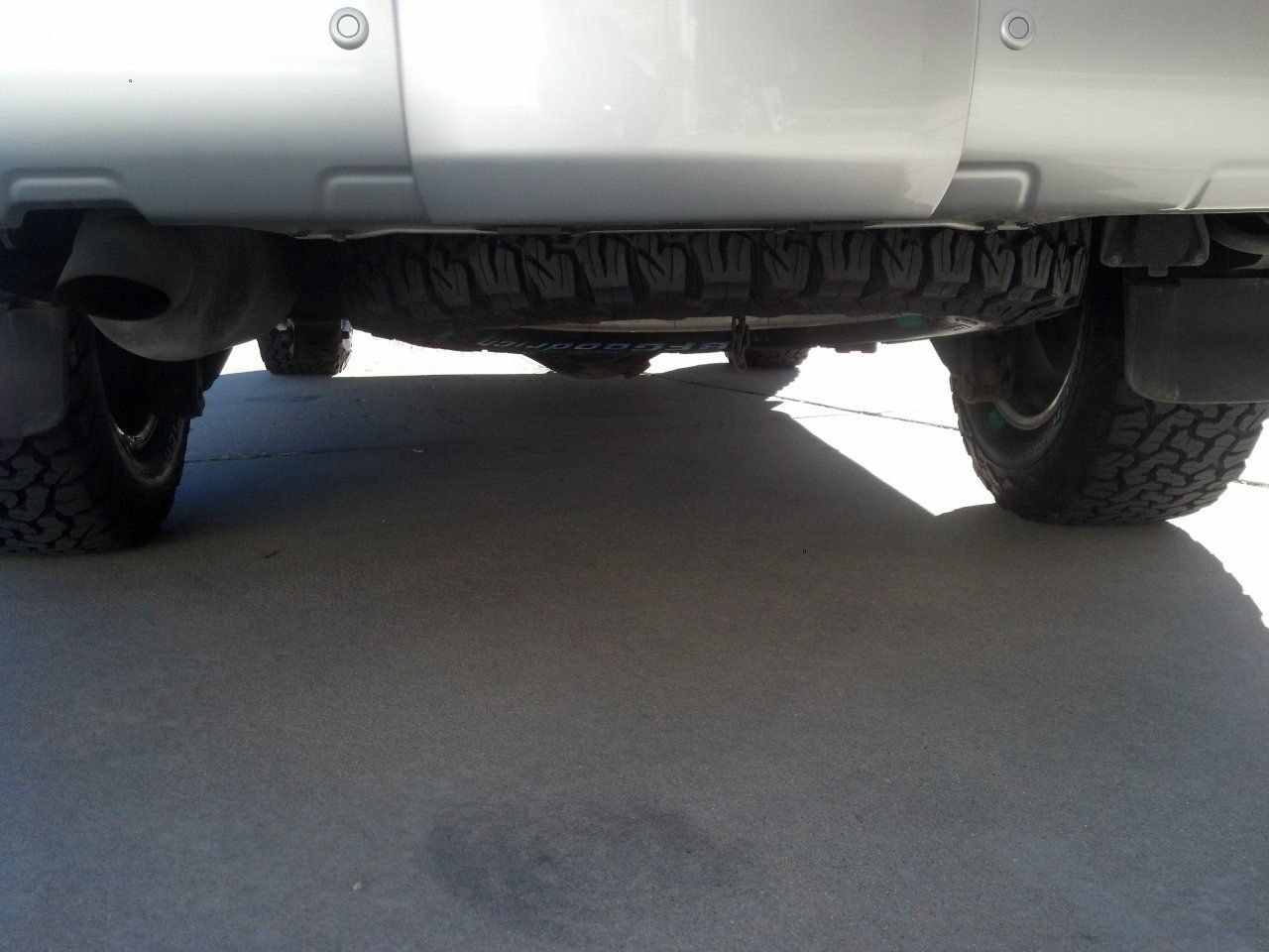

Hi all thought I would post my new pics of the KO2's!!! Running at 40psi. I wanted the 275/70r18 size but they are not coming out until march and we needed some tires to get us through winter. As far as on road goes they are really quite, can barely hear them on the freeway or in the city. Ride is nice just a tad bit stiffer but really not bad at all. I haven't been able to hit any trails but we mostly do mild to moderate trails only. Full size spare fits no problems at all
The SUV will pretty much stay stock. I took out the back seats, put in the dvd override system, and have the slee sliders on order, putting them on next week... After that I should be done

Hello, any rubbing at all on the 285/65/18 setup? Is your suspension stock? thx!

I have 285/65R18 KO2, E-rated on my '21 Heritage Edition. Stock suspension. No rubbing. Close on full lock but no rubbing. Maybe 3/16th inch clearance at the closest. I have not heard any rubbing with moderate off-roading on class 3, out of class 5, trails. No issues. I did loosen the mounting screws and move the plastic parts as far away from the tires when first installed and really tightened the mounting screws to keep them from moving. Due to the Slee skids, I also zip-tied one plastic part on the passenger side away from the tire to keep it from flopping around.
