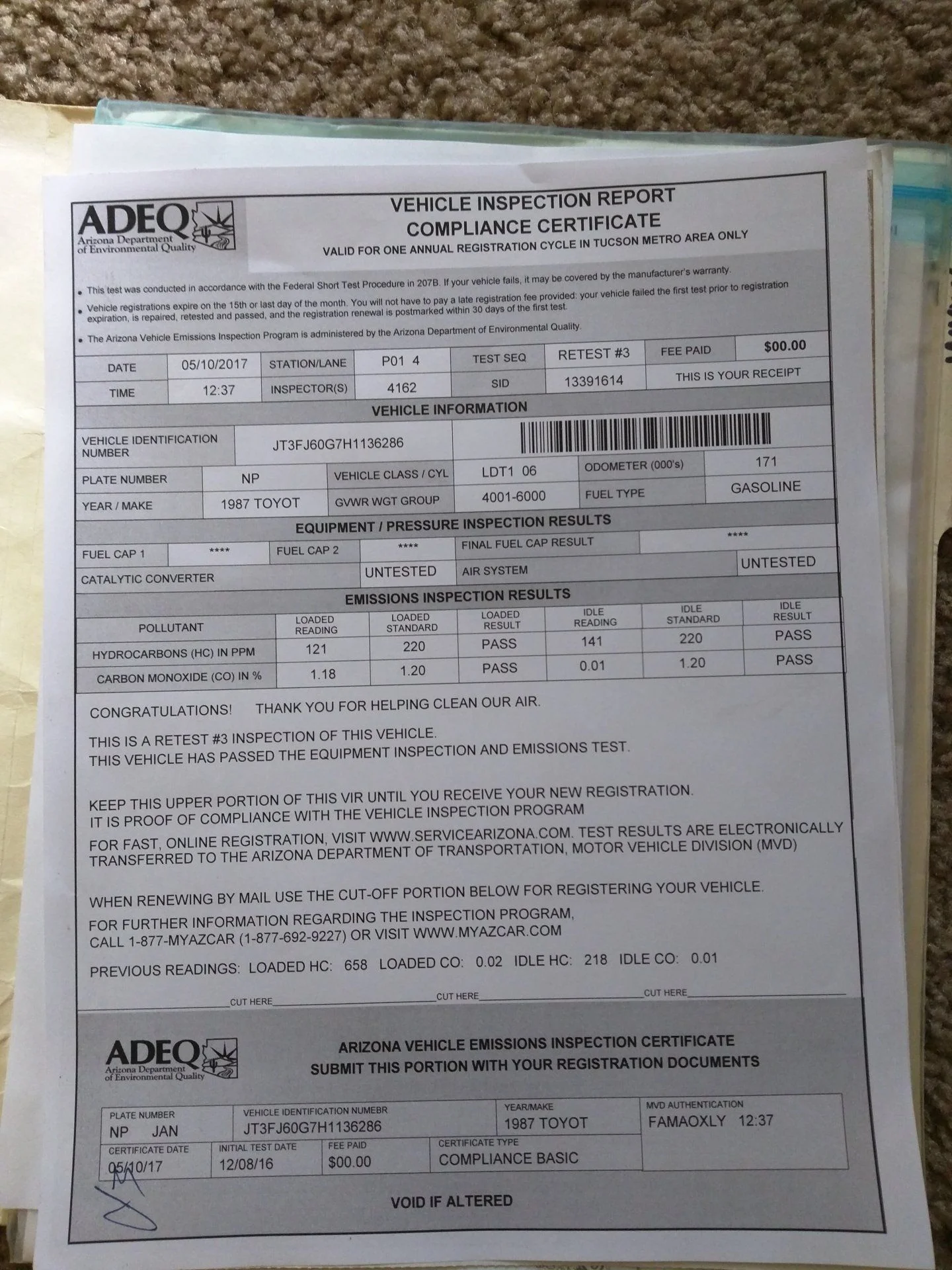

Ok, so that's that. The truck hadn't been registered since 2016 in CA, according to the old plates, so I figured it wouldn't be too hard to pass smog in AZ. My initial test failed idle HC, CO and running HC. So first things first, I rebuilt the carb (the secondary wasn't working at all) then replaced the plugs and wires. After that I only failed running HCs, and then it sat for a while while I worked up the courage to set the valve lash. I looked through the forum for a guide and set my lash while cold and also replaced my nasty cap and rotor. Once it was running better than ever I noticed a large vacuum hose leak from low on the carb which took my idle from around 650 to 100 or so. I found a friend that could help me check the timing and vacuum advance as well as re-baseline the carb and I passed everything, even if my idle CO is a tad high. Hopefully this will be useful information for someone looking for smog help.
Here are my final and previous smog readings

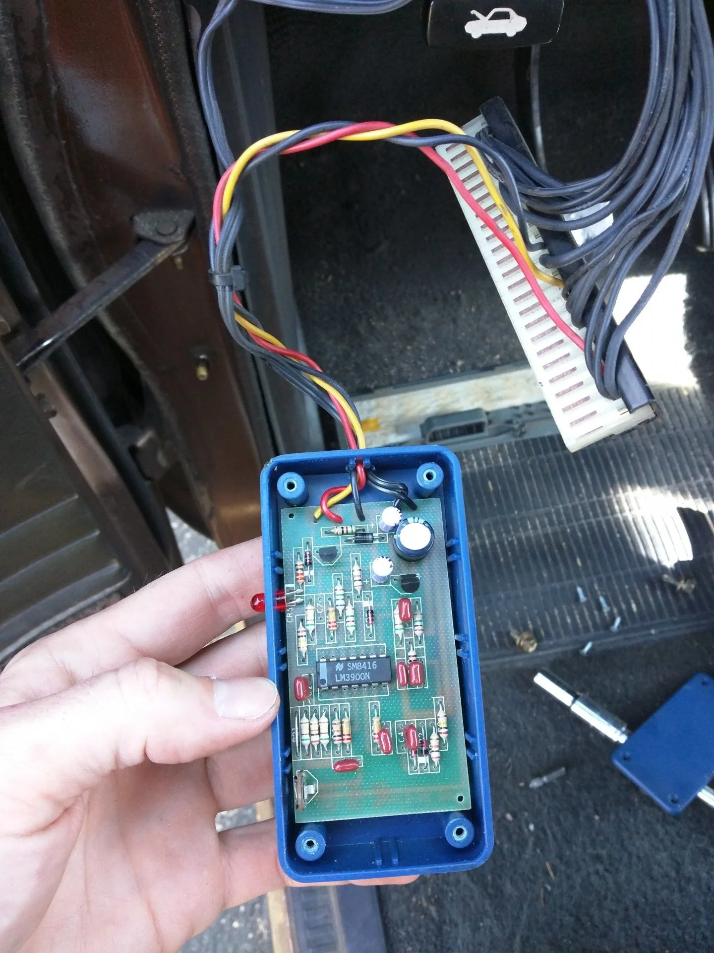

After that I started poking around in the cab and found this snaking its way into my loom behind the fuse box. It doesn't light up, I have NO idea what it is or what it does. I do know the PO had some sort of light bar attached because I have a row of switches on my center console, attached to nothing.
