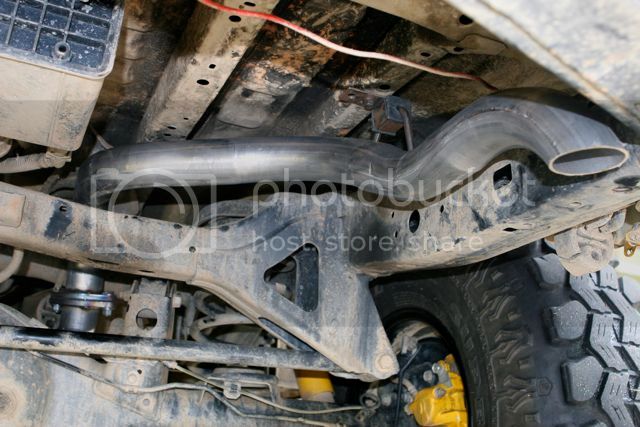

One of the big steps that you have to be willing to do is remove the existing rear cross member. This is a deal breaker for a lot of people. But, you get a huge gain in departure angle. HUGE.

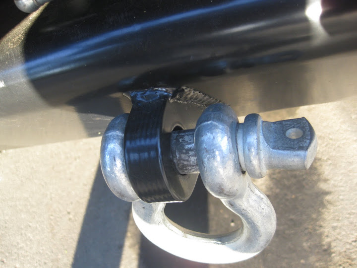

He welds in two recovery points
