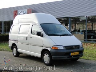

The later type Hiace (with not so good permanent 4x4, no low-gearing etc) is seen more common with high roof:
