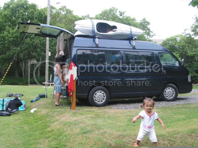

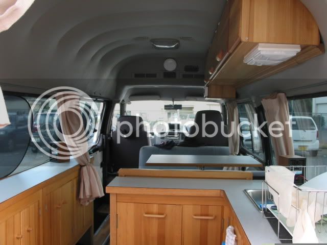

Holy Crap!! That is a rare find. There are of course a ton of Town Ace, Surf Ace and Lite Ace vans here but NOTHING that old with those specs. Take care of that thing....it's a classic. I had this Nissan E25 that I camperized (built entirely by moi) but the Hiace vans sure are nice as well.

Nice! I don't think my van will end up looking as Nice inside but it Will be functional and get the job done. Installed the tent today will post pics soon.
