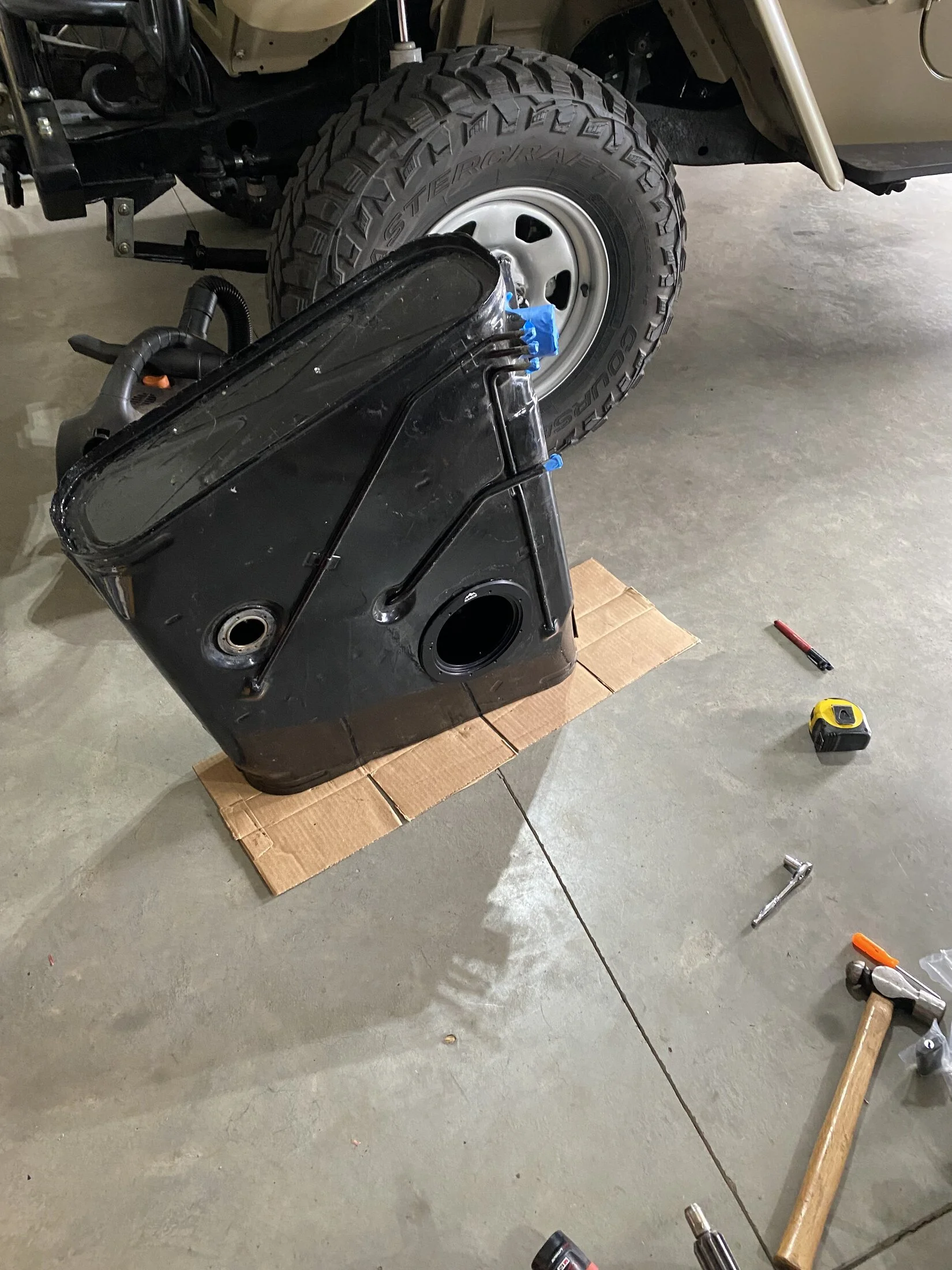

Where did you source the weld in ring?
Just a standard pump for the engine application?
Range industries is where I got the ring Range Industries - https://range-industries.com/, they have two styles that may be of interest. There is a weld in ring GM Steel Weld-in Fuel Pump Mounting Ring (Large Diameter) - https://range-industries.com/products/copy-of-aluminum-weld-in-fuel-pump-mounting-ring?pr_prod_strat=jac&pr_rec_id=a0d19e861&pr_rec_pid=7174511952081&pr_ref_pid=7586058076369&pr_seq=uniform and a bolt in ring GM Clamp Style Fuel Pump Mounting Ring (Large Diameter) - https://range-industries.com/products/copy-of-aluminum-weld-in-fuel-pump-mounting-ring-1?pr_prod_strat=e5_desc&pr_rec_id=5c1ed7667&pr_rec_pid=7174515294417&pr_ref_pid=7174511952081&pr_seq=uniform. Based on the tank depth they recommend several pumps. I got the idea from another thread and found this vendor that had these products instead of cutting out a ring of a GM tank and welding it in. Overall I like both.
Here is the pump I went with Amazon.com: DOLKSN Fuel Pump Module Assembly Fits For 2005 2006 2007 Chevrolet Avalanche Suburban 1500 GMC Yukon XL 1500 V8 5.3L Flex E3706M : Automotive - https://www.amazon.com/dp/B08RHZTLR5?ref_=ppx_hzsearch_conn_dt_b_fed_asin_title_3. I suggest using the metal top pumps vs plastic for both range industries rings so you dont have to get another ring in addition to clamp it down. What I learned is the pumps serve a range of depths, the one I listed is for tanks from 7-9" deep. Its got an offset and that made the install a little fun as I have to compensate the hole for the pump offset, basically drank a few beers and then figured it out. Where I placed the pump, I am unable to use the stock tank float gauge. I just got a Dakota Digital dash so I plan on using the GM plug to feed the signal. I did have to bend the gm float to get it to work based on the pump offset in the tank. How I have it aligned will allow my fuel lines to come out the side of the seat rails and through the stock fuel line opening.

this is the clamp style ring, highly suggest this on a used tank vs welding. I bought a new tank so thats why I had it welded in.

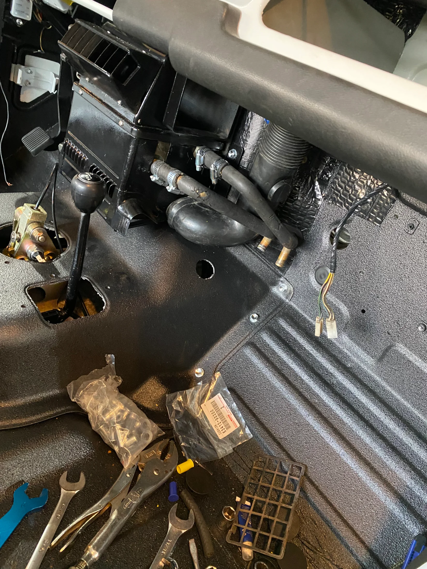

Here is an update on what I have accomplished recently. I installed my wiper motor (had to solder a broken wire) with new gaskets from CityRacerLLC, I added the fuel pipe vent line fitting, I drilled new holes and used nutserts for the heater (something to check on when you have a topnault, tub should you go that route), installed both the tunnel gasket and silas deadening mat, and made a battery mock up out of cardboard. I may end up moving the PCM/TCM to the driver side fender to give more room for the battery. The Dakota Digital dash is in so I have even more to do.

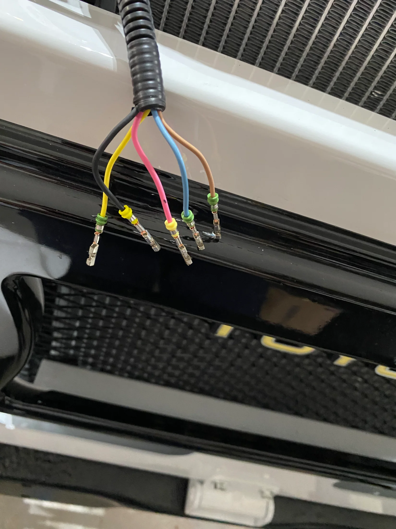

- finish repairing the main wiring harness, only a few more wires to repair on the harness behind the dash. I also need to fab a mount for the fuse box, another oversight from Topnault, I will repair the damages/spliced ends near the lights later on as I have the new Toyota lights and will need to splice anyways. I also have a new rear harness, big thanks to Coolerman for making it for me!

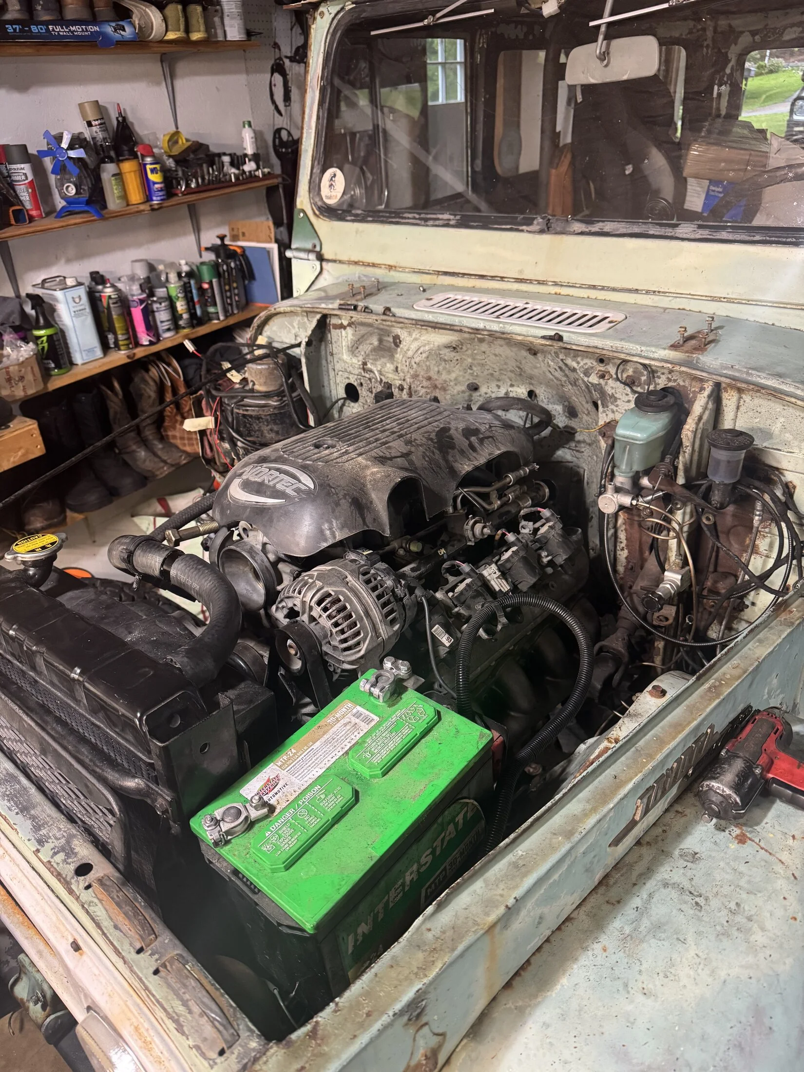

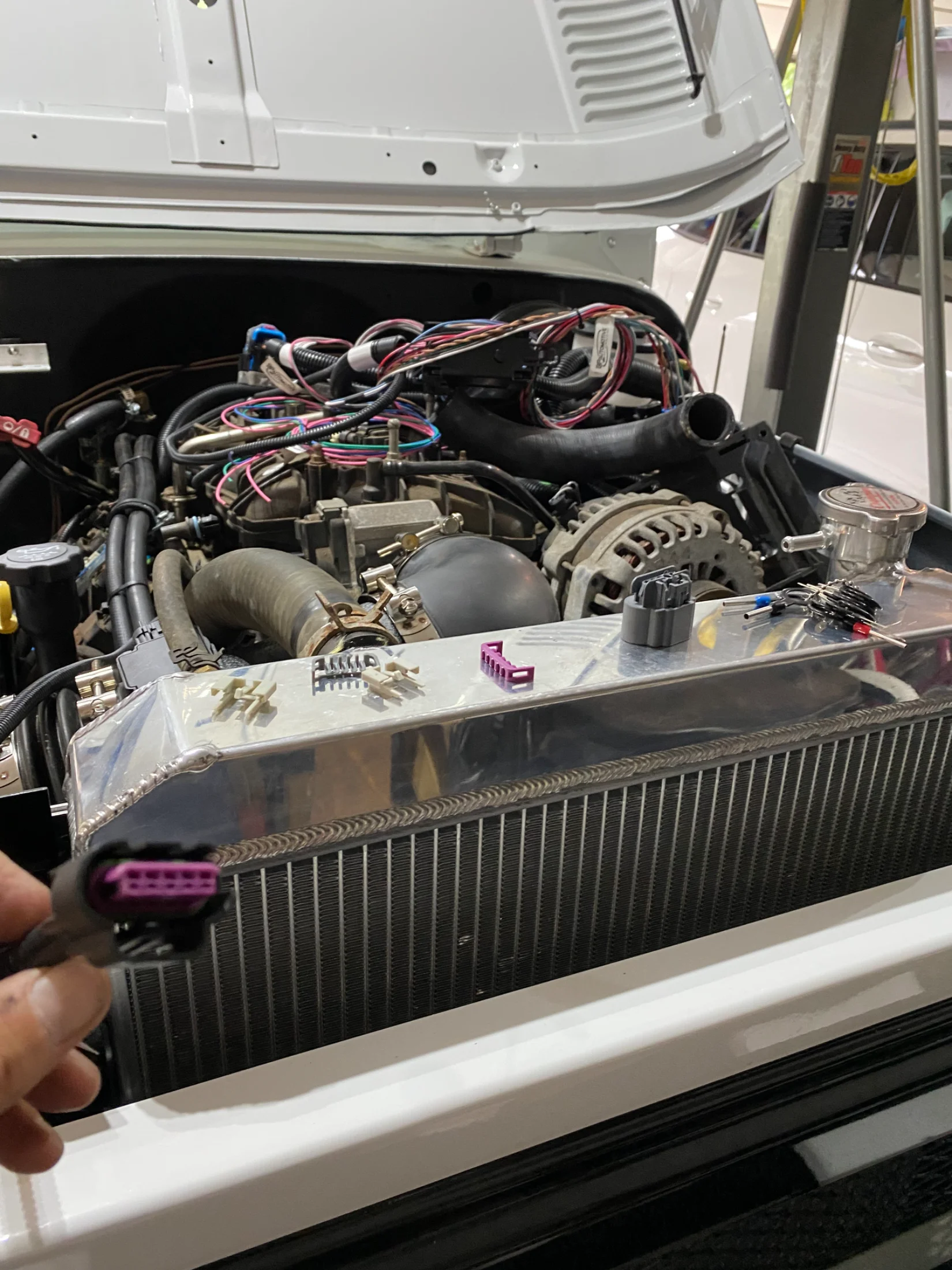

Honestly it fits great. I moved it up by the radiator. Still just enough room to reach down and access the Power steering cap and fill it. I’m planning to use the factory side post GM battery cables as well.
My engine is also offset to driver side.

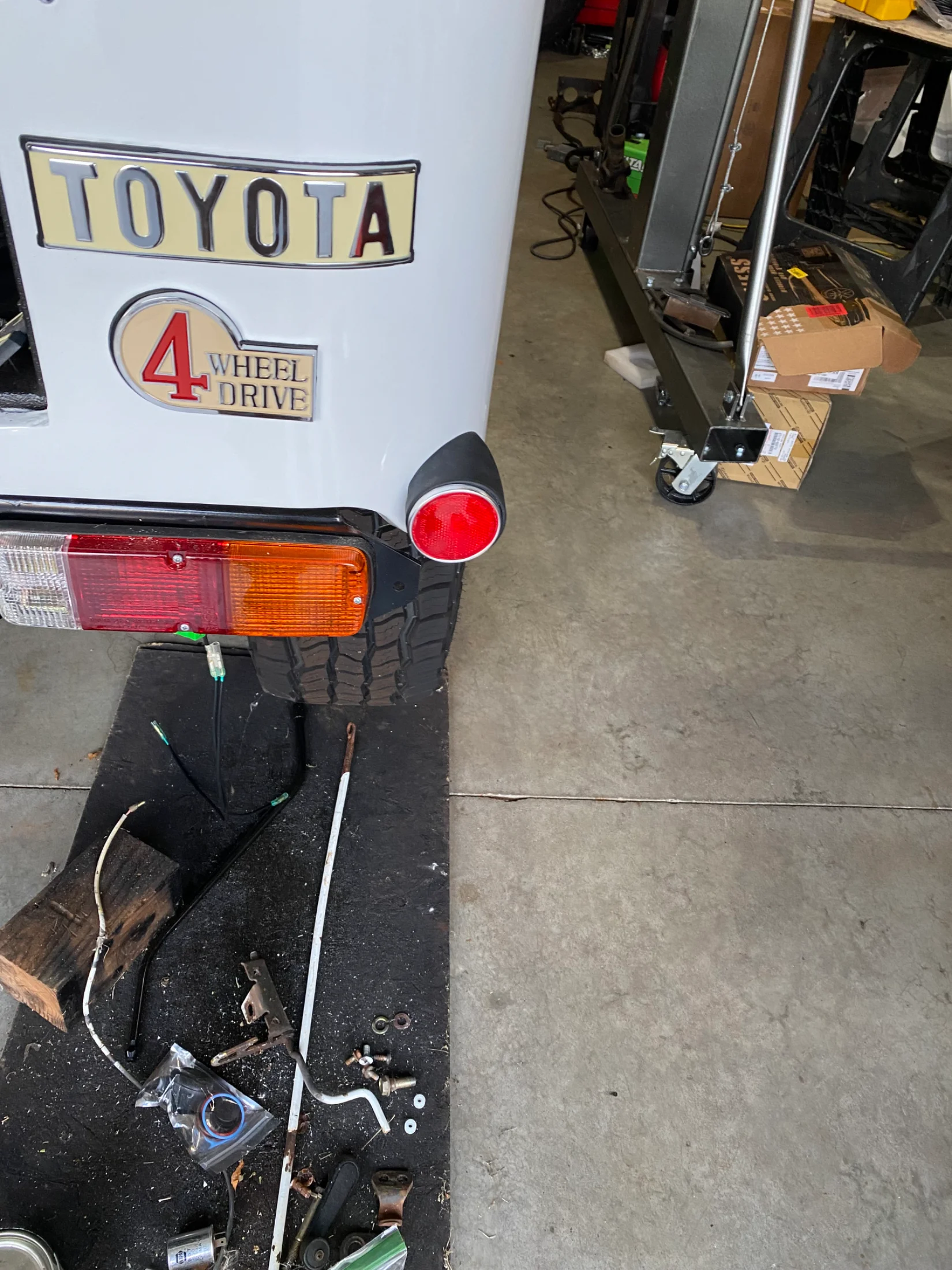

Added some rear bling bling, just badges on the rear for now.

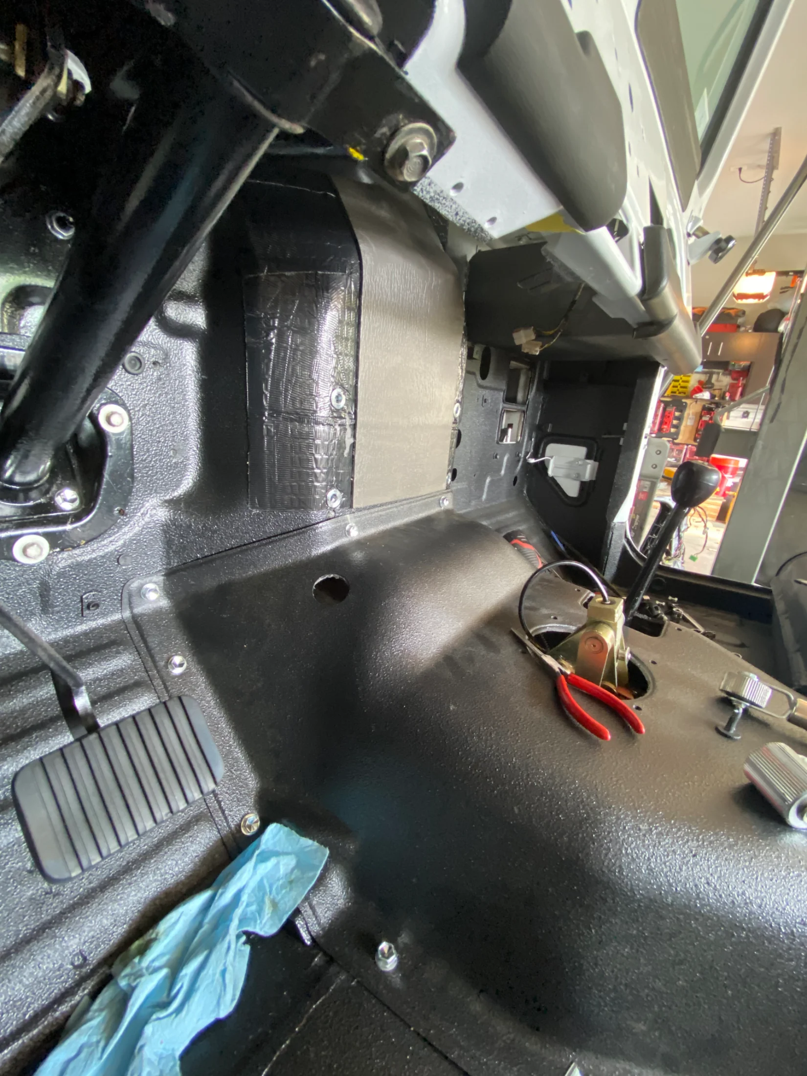

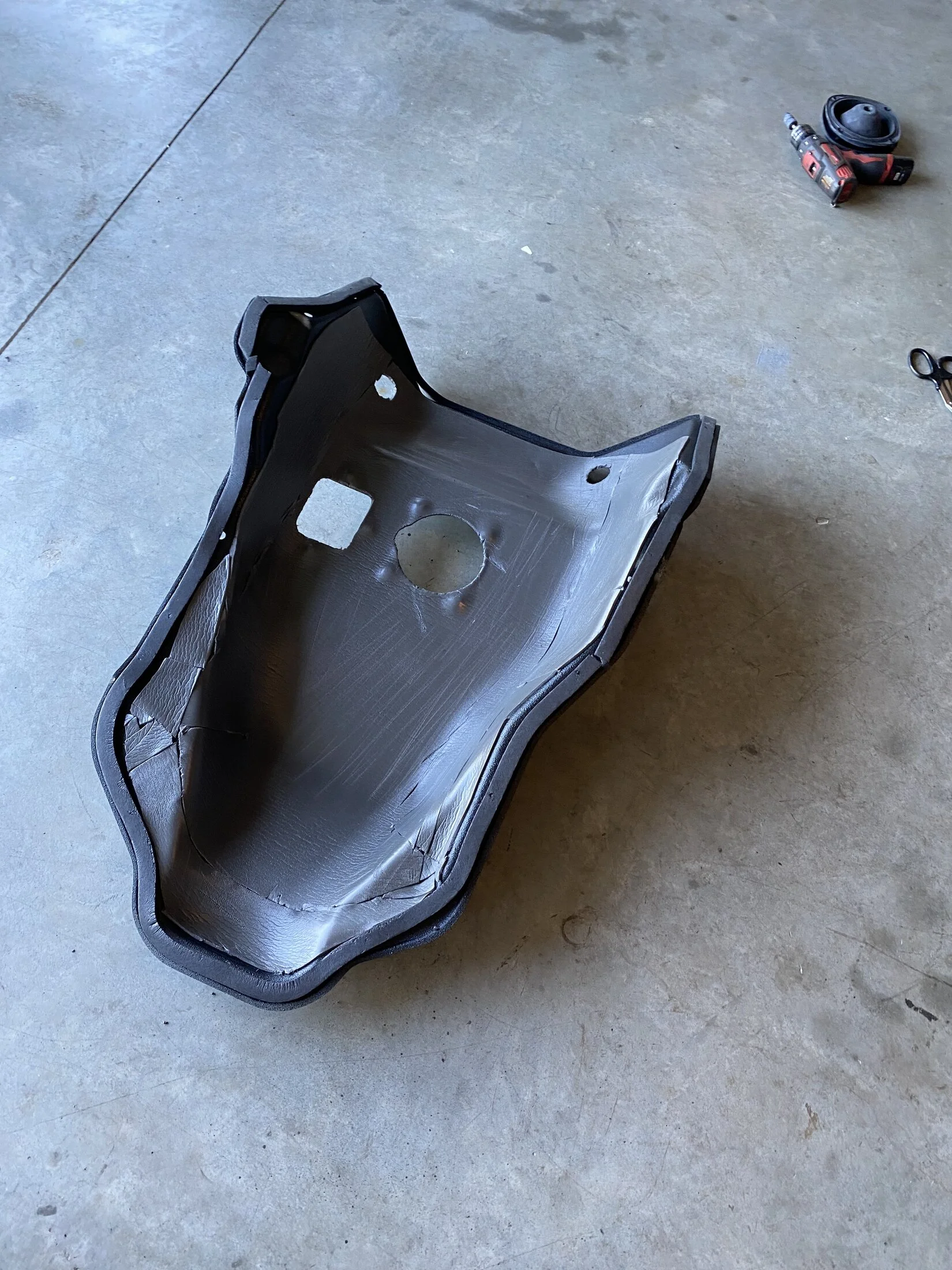

I also added some Silas deadening material to the firewall, it might be a waste of time but I am going to give it a try.

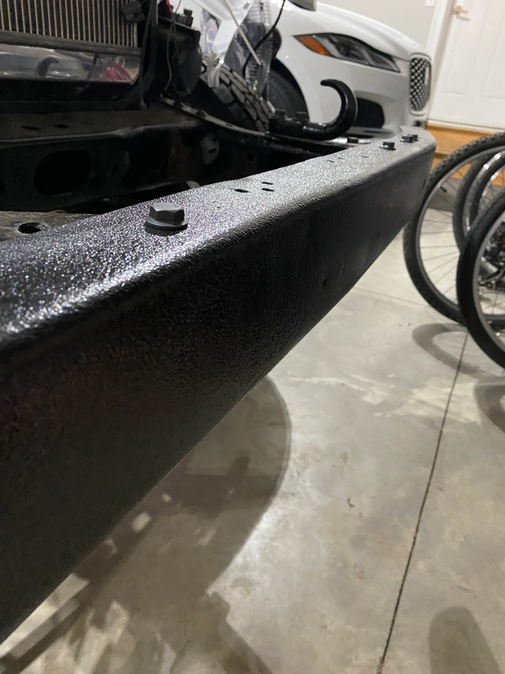

Next up is the front bumper, I decided to reclaim the bumper. It was bent up a little, with a little heat and persuasion and some paint its decent enough to use going forward.

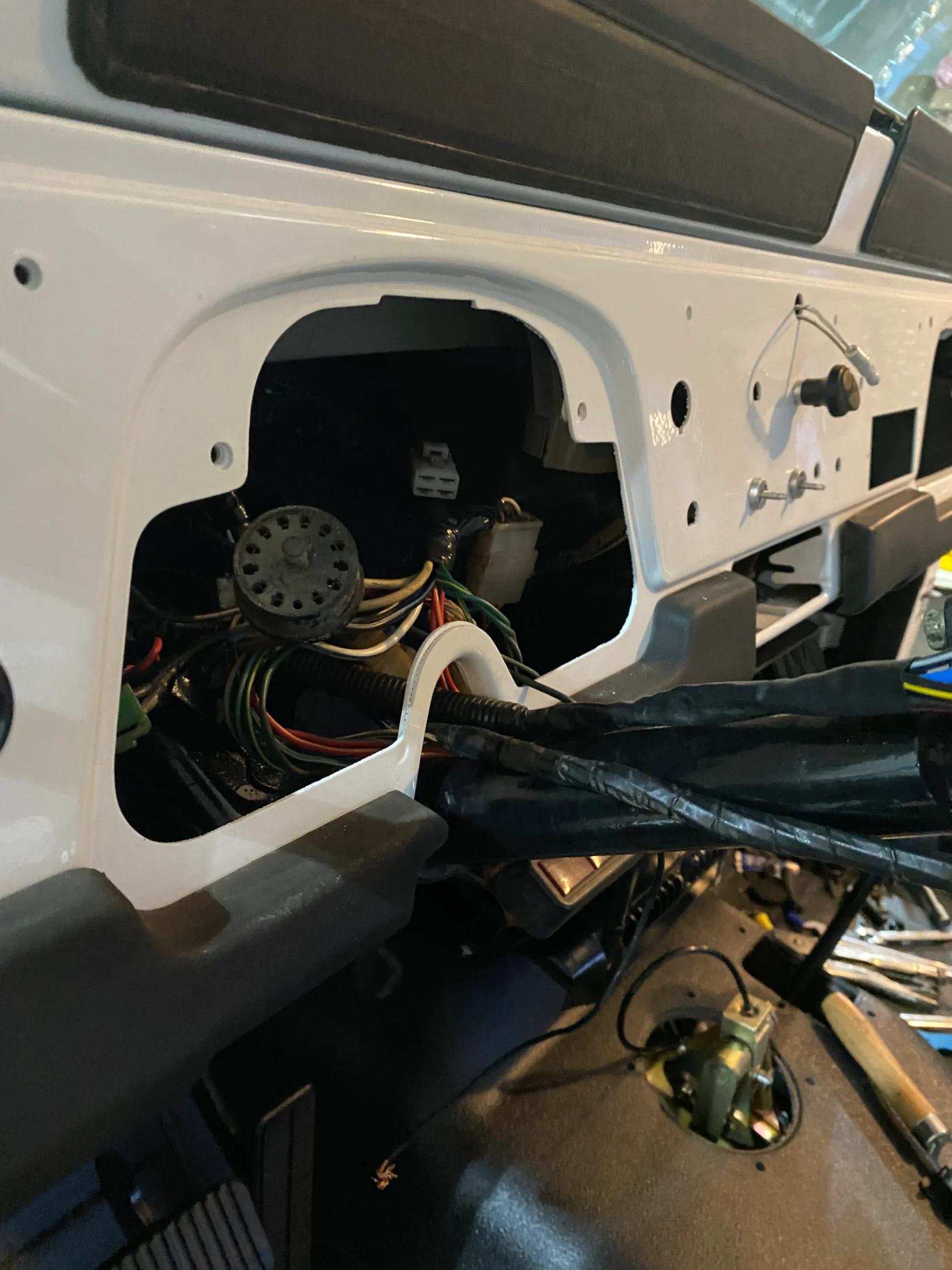

The last photo is the harness post repair, several wires were hacked up so I retraced every thing I could but wont know for certain until its fully powered.

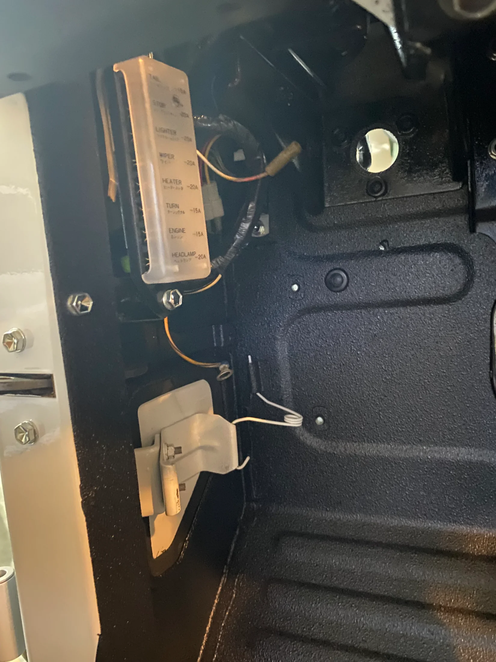

The Topnault tub lacked mounting tabs for the fuse box, it was kinda a pain in the neck to mount the tabs but doable. Chalk it up to another thing I missed on the mock up.
Here's a pic of the fuse panel in place, and of the new flasher relay.

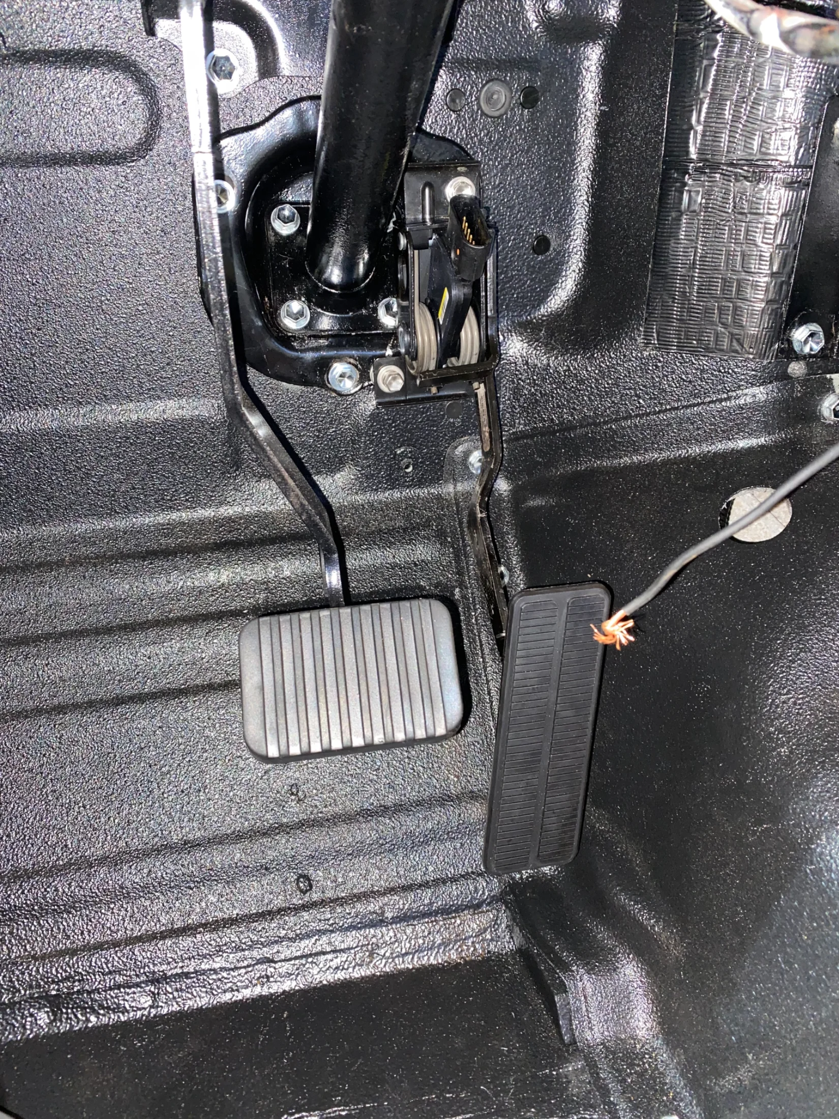

Last but not least is the throttle pedal install. I am making a spacer bracket before this is finalized.

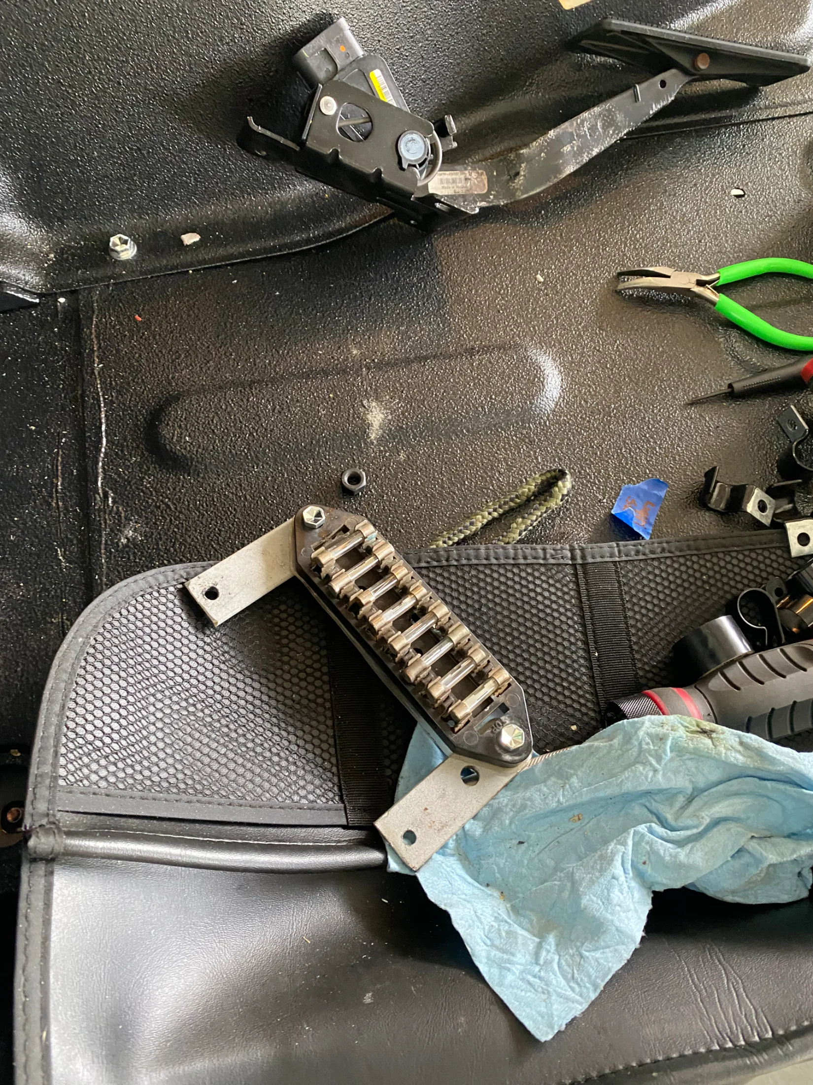

And of course, everyone's favorite chore.....dash wiring. As this is an LS Swap I will be working through what will be used and what wont. I taped the alternator wires as they aren't needed anymore.

What DBW pedal are you using?

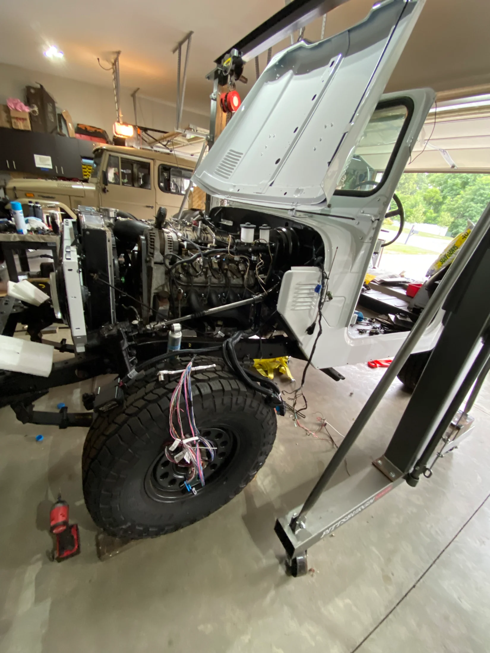

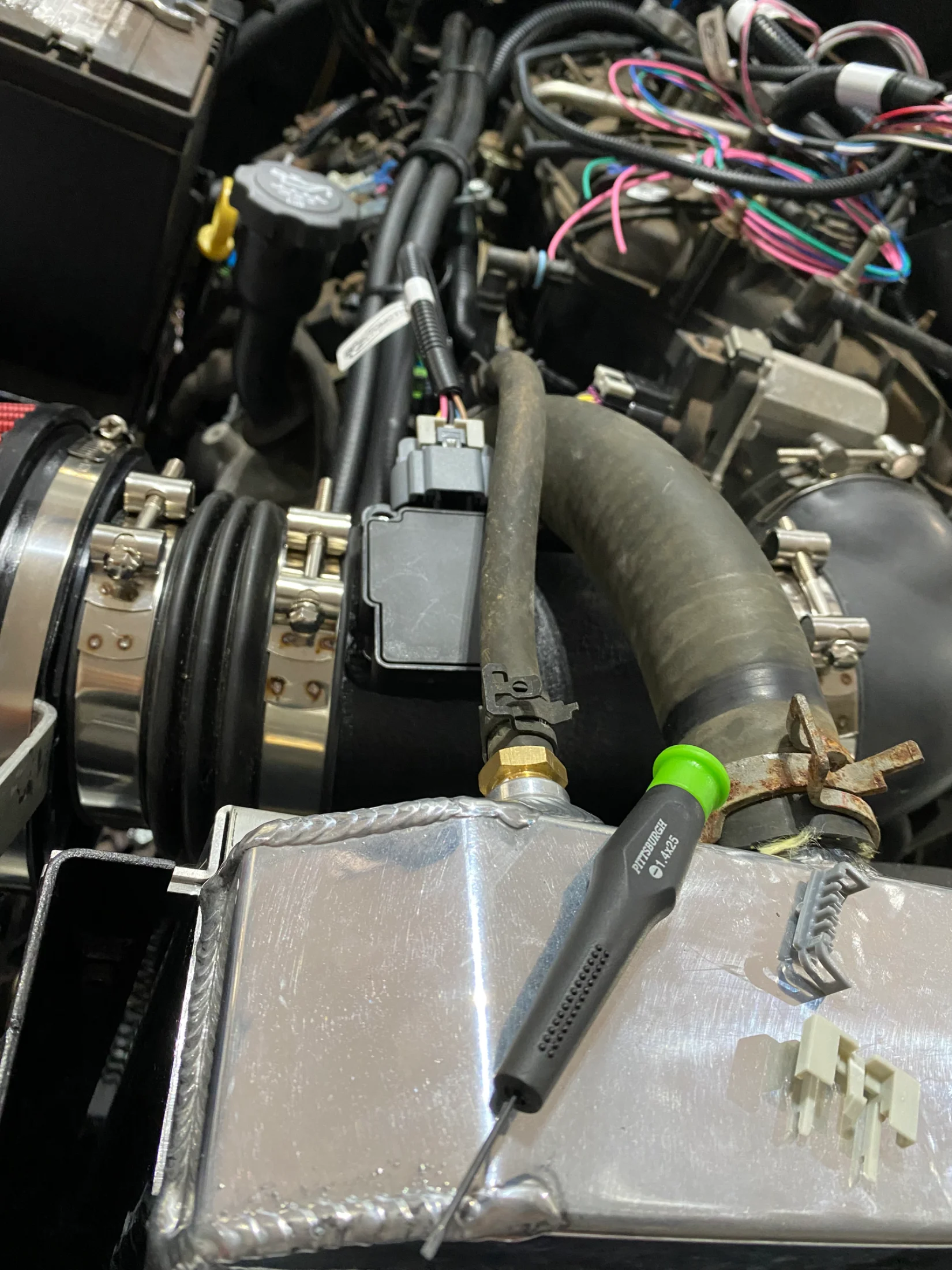

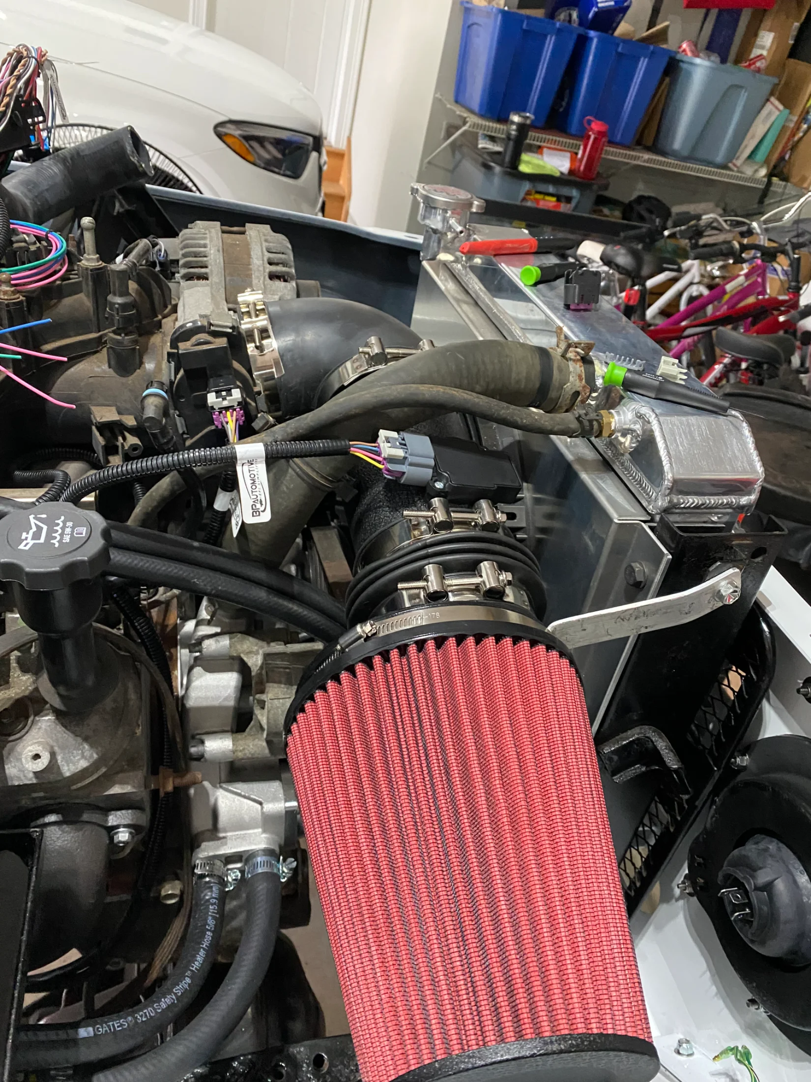

Test fit the air intake, thought I was doing well with my fab mojo until I realized I installed the pipe backwards resulting in the MAF sensor plug in the wrong orientation. I was able to reuse the original upper heater hose after cutting it down. I had to swap the MAP sensor plug, such a joy. The last couple of pics show the completed work.

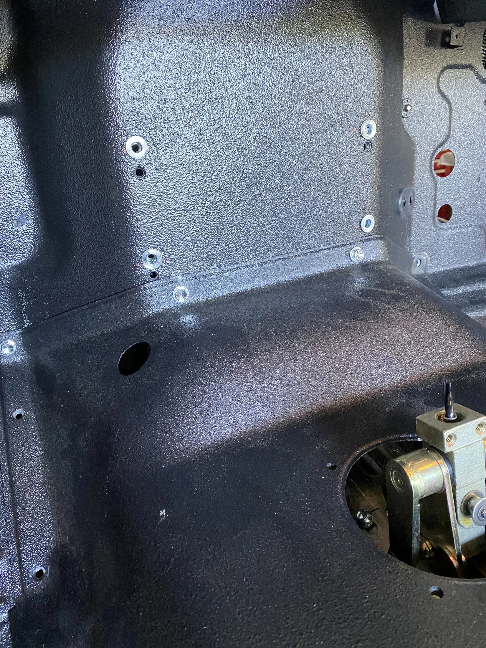

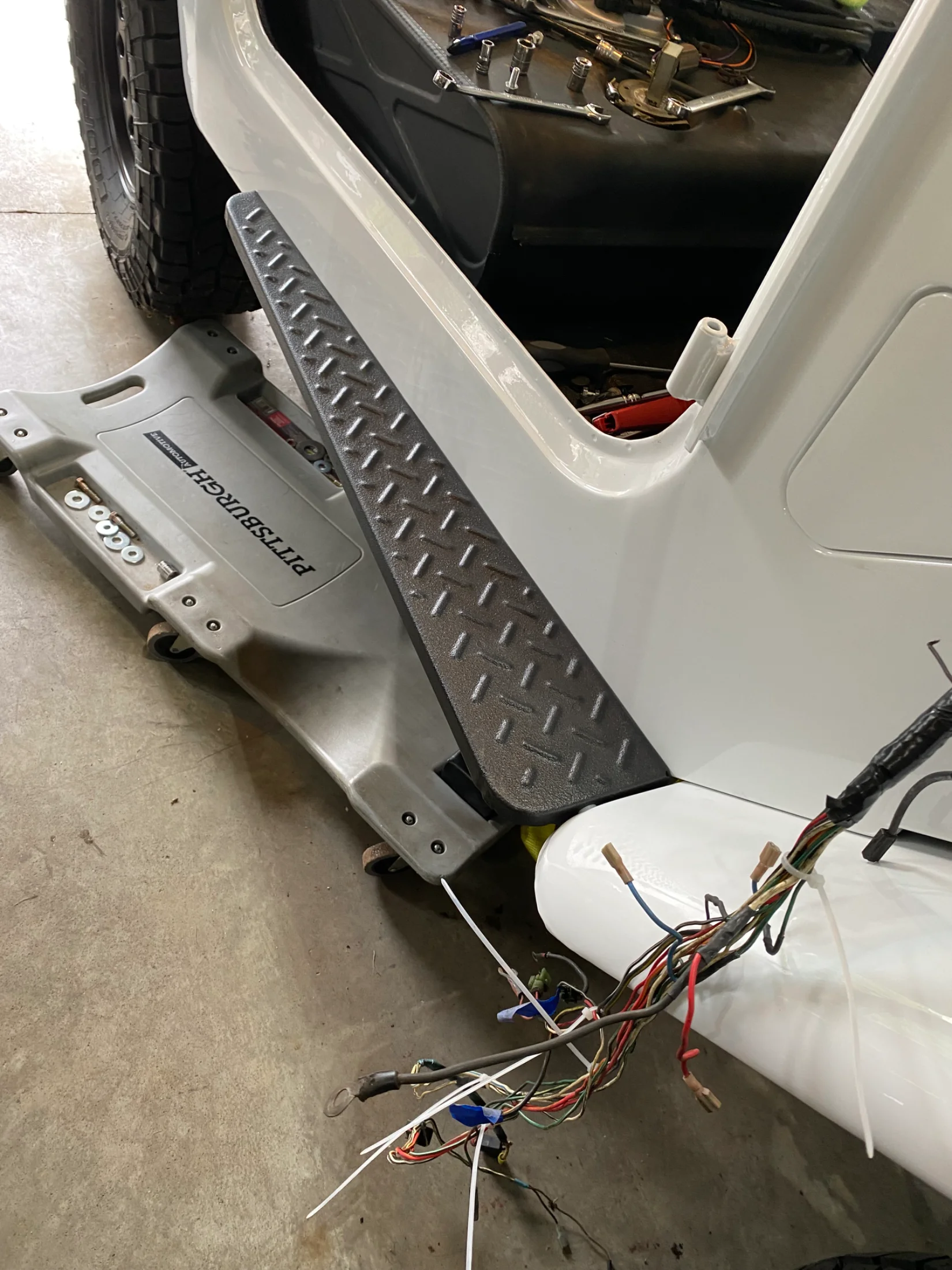

Passenger side step installed, only two holes lined up so I had to drill new ones. I also attached it to the fender. Now the fender is almost where it should be but now the hood over hangs some. I will need to do a lot of adjustments to finish.

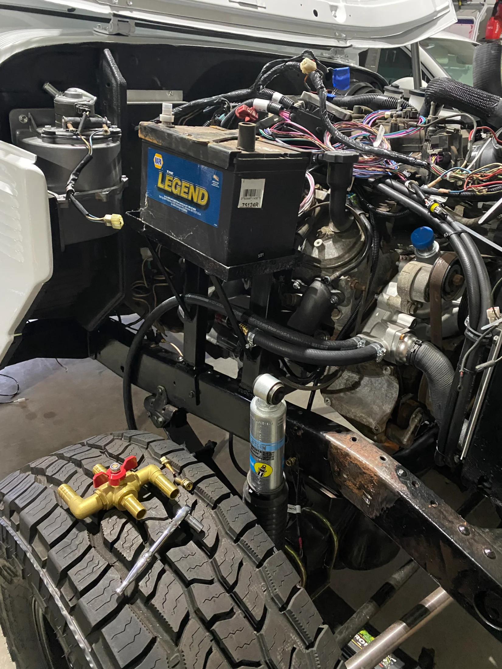

I also removed the driver side fender, need to install the computer on the drivers side and finish routing the BP automotive harness. I need to install a PS cooler, bleed the master and reconfigure the brake lines and mount the PCM/TCM and fuse box as well. One step closer.
