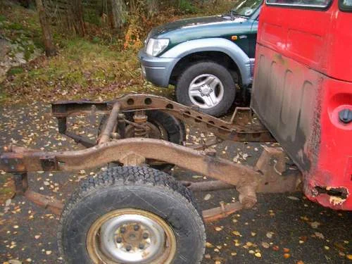

The coil springs are modified for the equipment that was there before. It was quiet heavy stuff as u can see.
Now i have done a little work.
I have removed the roof......, but I will do more as soon as possible.
As you can see its a little rust underneath the frame, but its easy to fix.
I have got in touch with a man in Sweden about a new roof, and I will pick it up during the summer.
More will come later.
