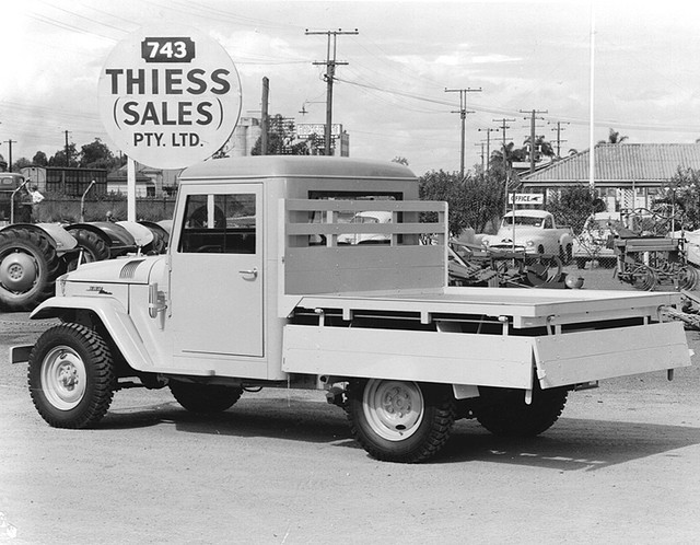

Would build such a tray on your gift ;)
Not so expensive and the look of this 1958 fixed hardtop sold in Australia
is awesome... just my 2 pence

Yep, the bed definitely has to go!!! I had planned on building a flat bed. I'm a blacksmith by trade and own a metal fabrication business. I really like the folding side idea, Thanks A.greenspan:clap:!!!
