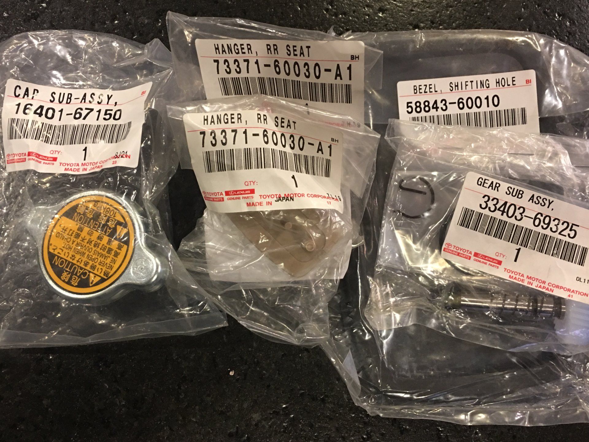

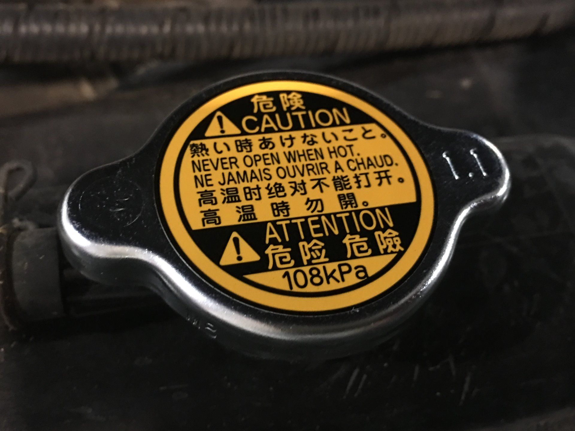

Picked up some more parts. Seat belt clips, radiator cap as the other one was seeping, gear shifter trim (going for black as the chrome ones seem to separate) and solved the part number for the 33 tooth speedometer gear.
Interesting how a properly working radiator cap causes the system to bleed air and reservoir to go up and down when hot or cold.

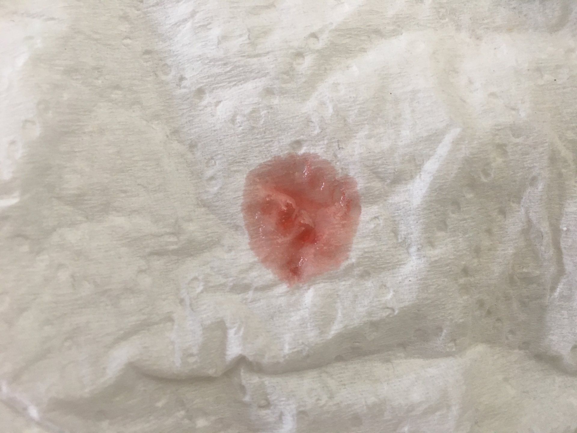

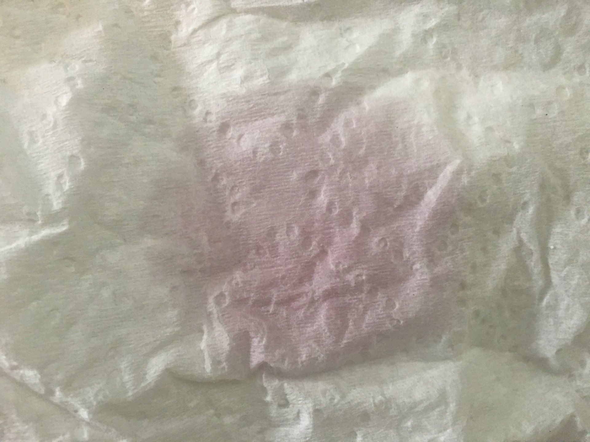

Saw a thread somewhere about doing a tranny fluid test to look for contaminated fluid on a white napkin by checking for a ring around the edge of the drop. Fluid looks great. If anyone has that link, please post.
