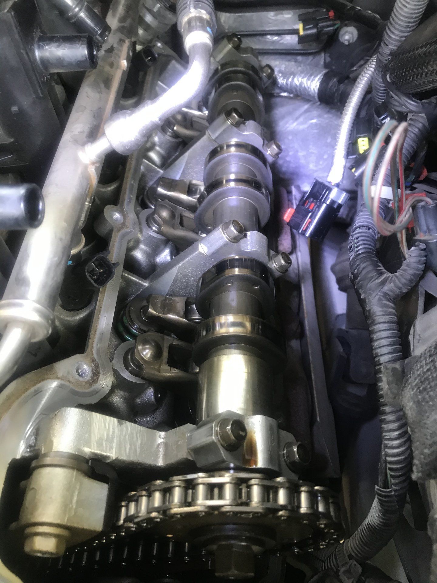

Sweet build, just finished fixing a broken valve spring on a 10 commander. Anyone else get stuck doing this let me know I’ve got a 3D printed valve spring compressor. I was able to rig a compression tester up and keep air in the cylinder to keep the valve from falling. Worked like a charm. 150k on the engine with Mobil 1 oil. Not sure why the spring broke. Changed the lifters while I was in there.
