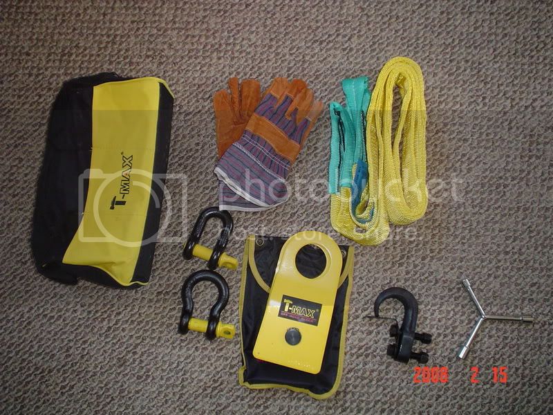

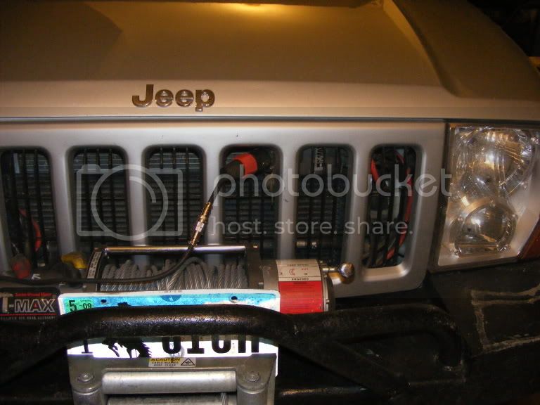

T-MAX EW-90000W winch
T-Max Winch Recovery Kit

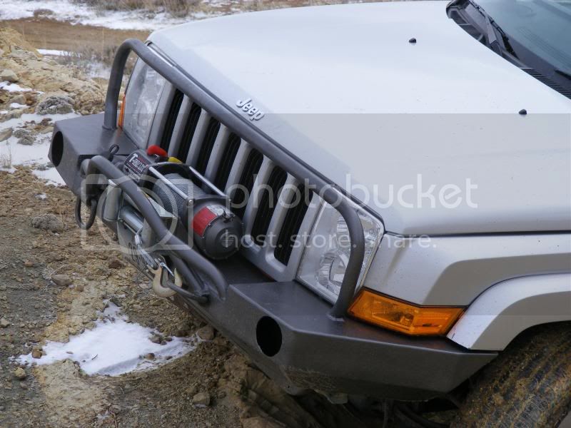

Custom Front Bumper and Skid Plate

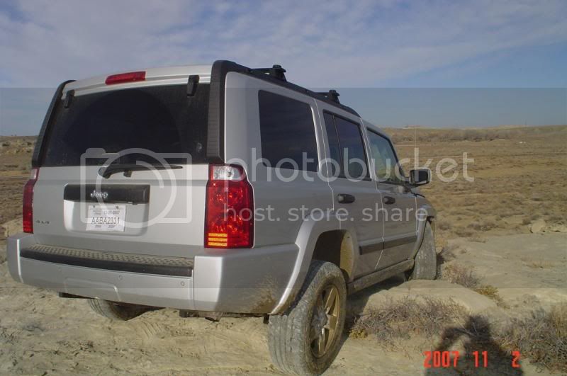

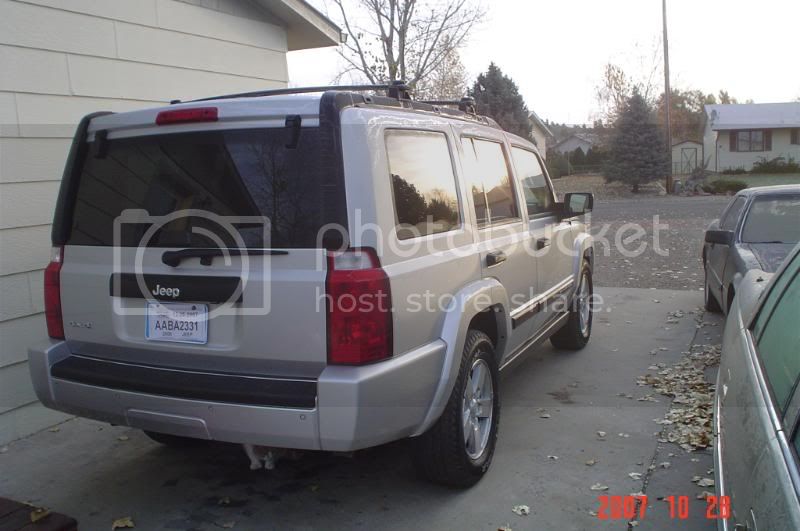

We bought our commander in 2007 used with 21K miles. We have almost had it 2 years now. It will be paid off in 3 more years! Whoo Hooo!

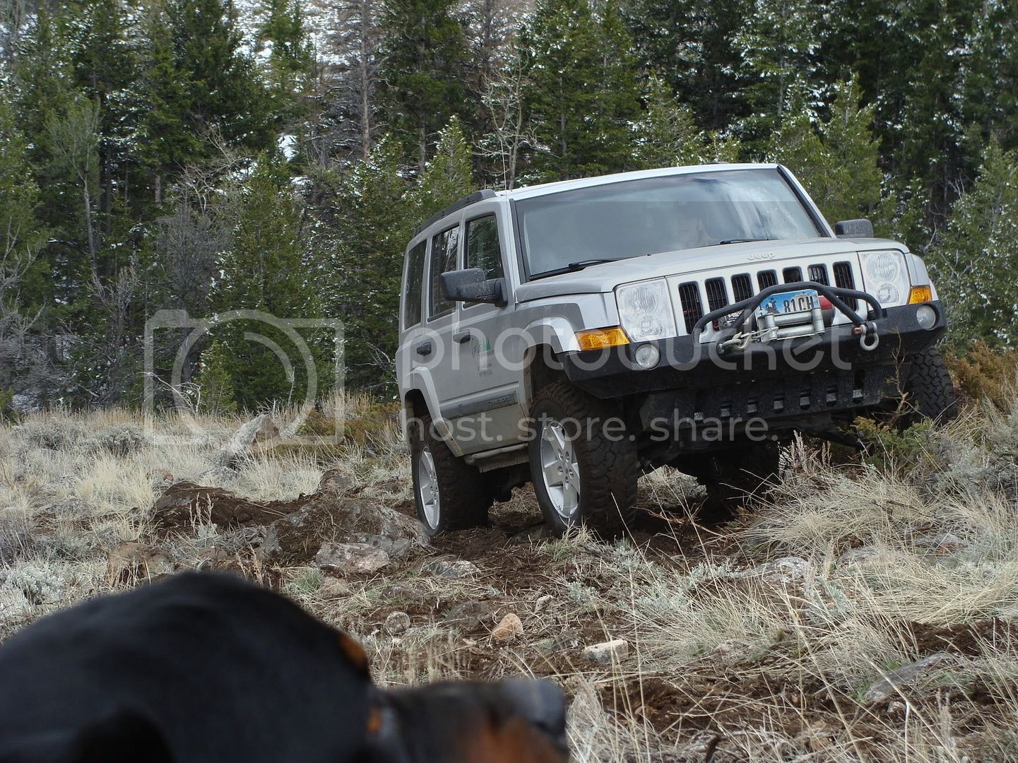

Here it is after we got it!

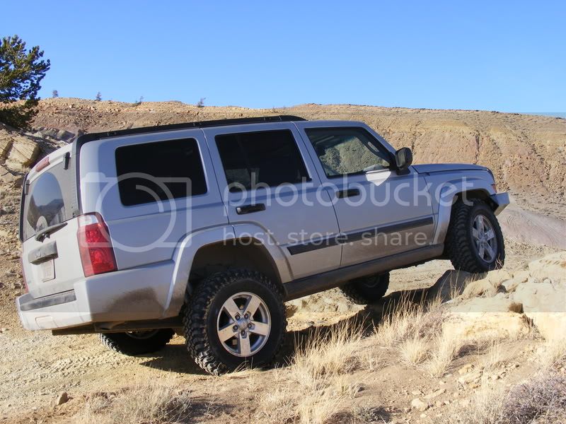

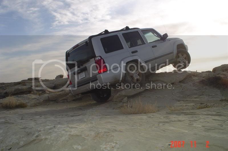

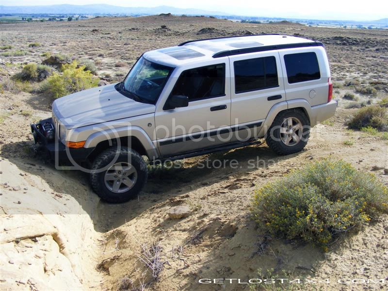

I have been trying out several different suspension set-ups trying to get the commander to handle the way i want to.

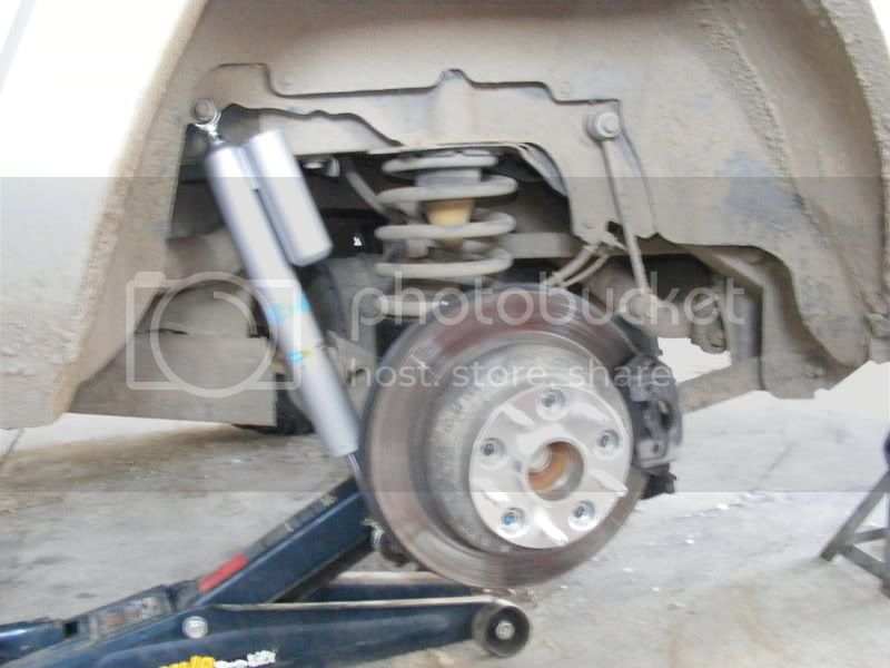

Stage 1: Spacer lift + bilstien 5150 12" shocks + Stock Wheels 1.5" wheel spacers.
it worked alright, but the stock springs did not appreciate the extra weight of a bumper and camping equipment.
Stage2:

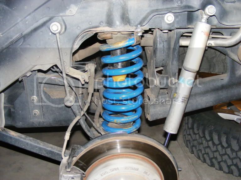

OME springs up front + Remove rear Sway Bar
Better suspension flex, the front end rides great off-road. The rear end was still sagging.
We also tried to leave the front spacers in. but the angle on the CV joints was not good.

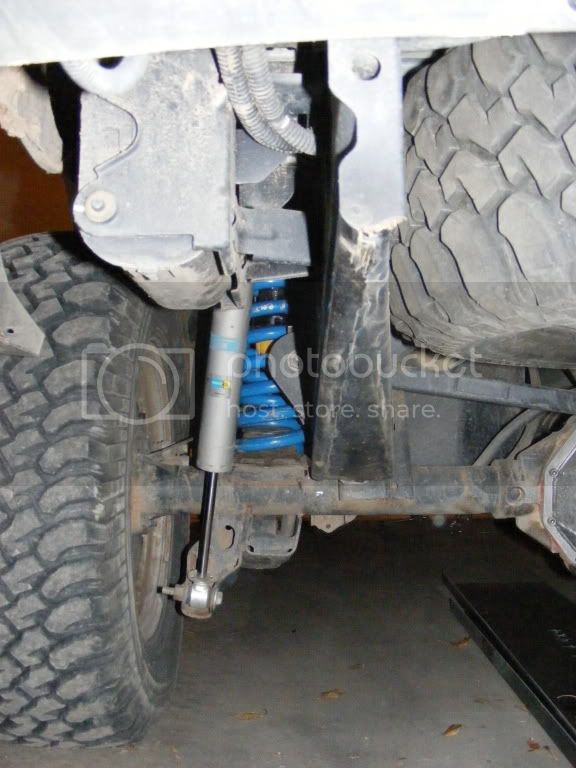

Stage 3:

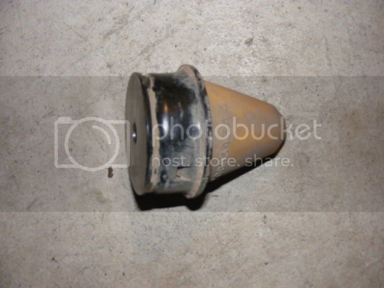

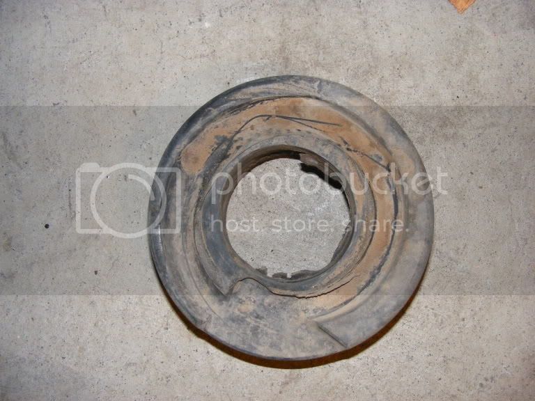

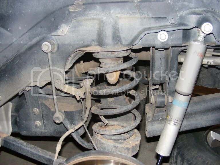

Now it was time to do something about the rear. The stock springs just were not cutting it. When we were loaded down with camping and 4 wheeling equipment the rear springs just could not handle it. Not only would the rear springs fall out if the suspension flexed enough, but the bump stops were also too short. So we did a little fabrication to correct the problem.
These were the stock springs we were using with the suspension spacer lift.

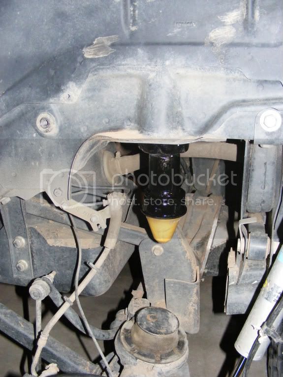

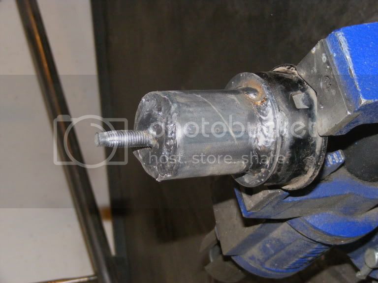

This is the stock rear bump stop. Its pretty short and let the springs fall out all the time.
We modified it by lengthening it with some round tubing.

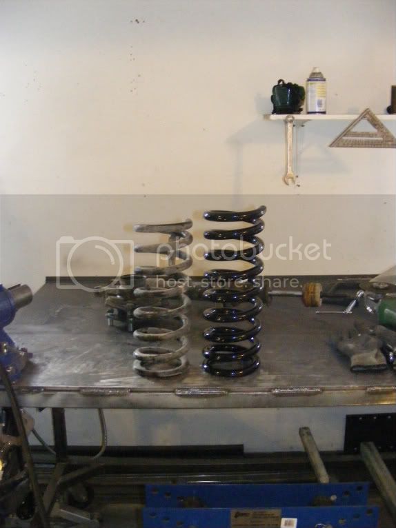

I had been out to the junkyard and picked up a set of Ford F150 lift coils. I think they are made by Fabtech, but I am not sure. They ride pretty good. I cut them down to size and installed them with the new bump-stop.

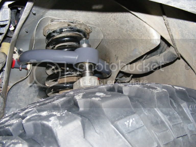

Stage 4:

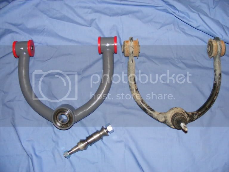

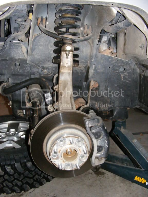

HD Front Upper Contol Arms w/ 1" Uniballs, 1/2" lift spacer, Sway Bar Removed
I will not be doing anything else to the front stock IFS. When it breaks its going in the garbage to be replaced with a JK D44 with locker. I will keep the rear 8.25" full floater rear axle and upgrade the gears to 4.10 and an ARB air locker.

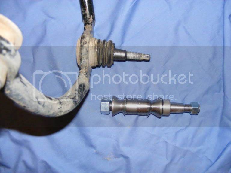

Here is the old stuff. When i pulled them out the ball joint almost fell out. Perfect timing as far as replacement goes.
some pictures showing the difference between the old ones and the new ones.
New HD UCA's Installed
These arms work pretty good. they are much stronger then stock, but they do make a lot of noise. the front end is pretty much dead anyway. i'd like to add some beef and better suspension travel.

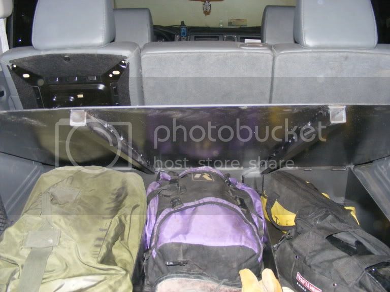

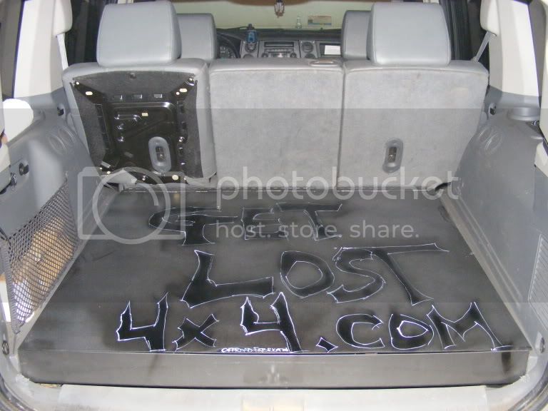

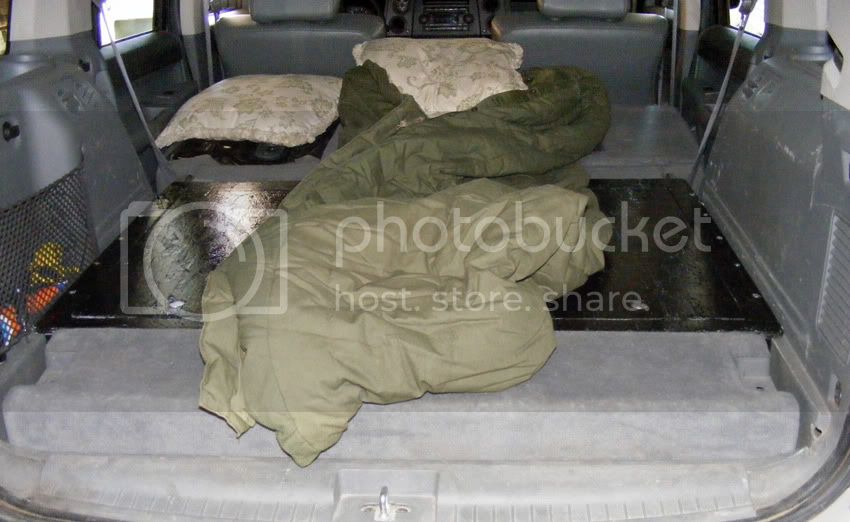

The next project included storage compartmets. The commander doesn't really have any good places to keep your stuff from flying around. There was a worthless 3rd row of seats in the back. The only good they did while they were still in the vehicle was to keep the sleeping area flat. We removed the seats (about 150 lbs worth) and put them in storage should we decide we ever will need to use them again.
here it is with the seats folded down
seats up
a look inside, it holds a ton of stuff.

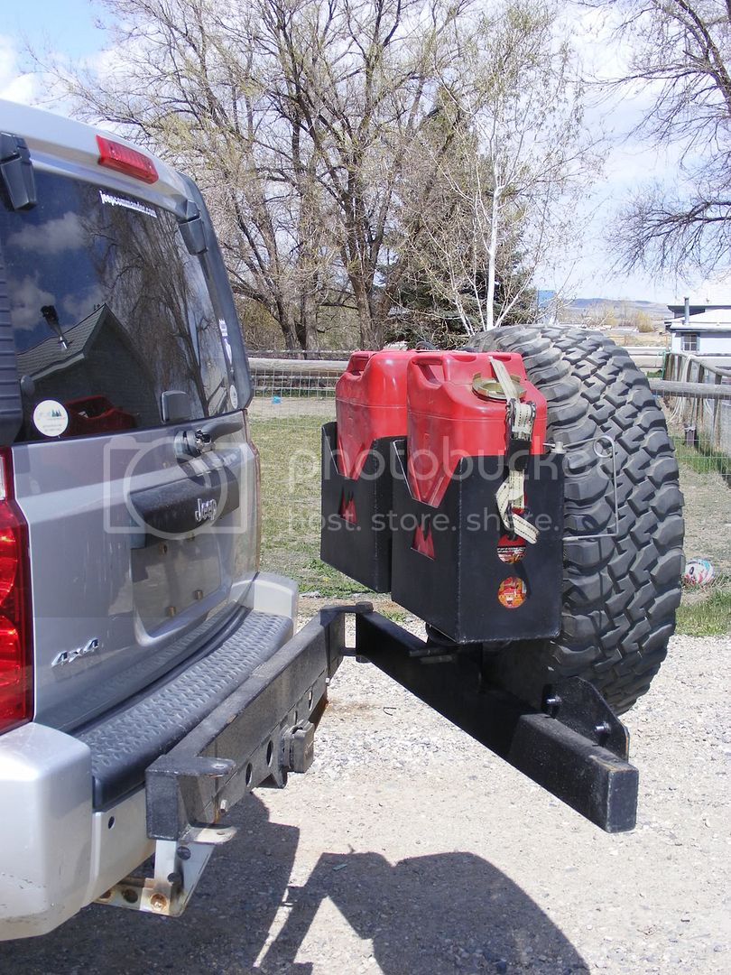

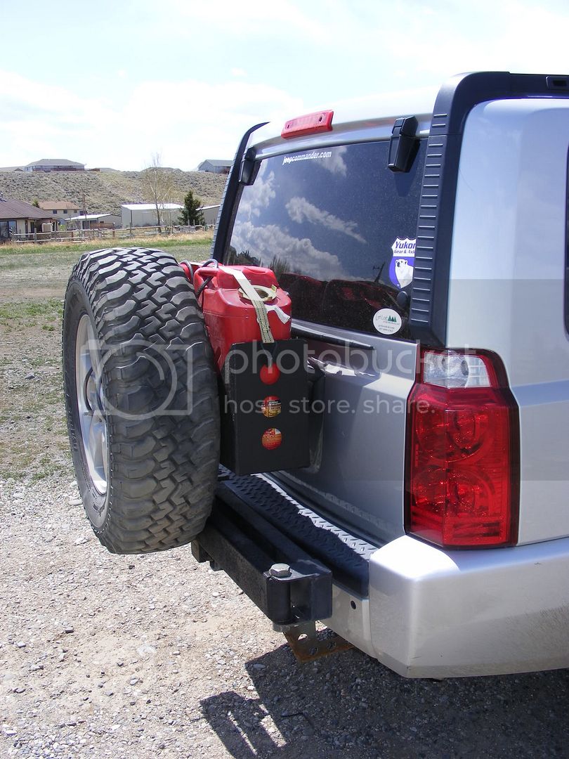

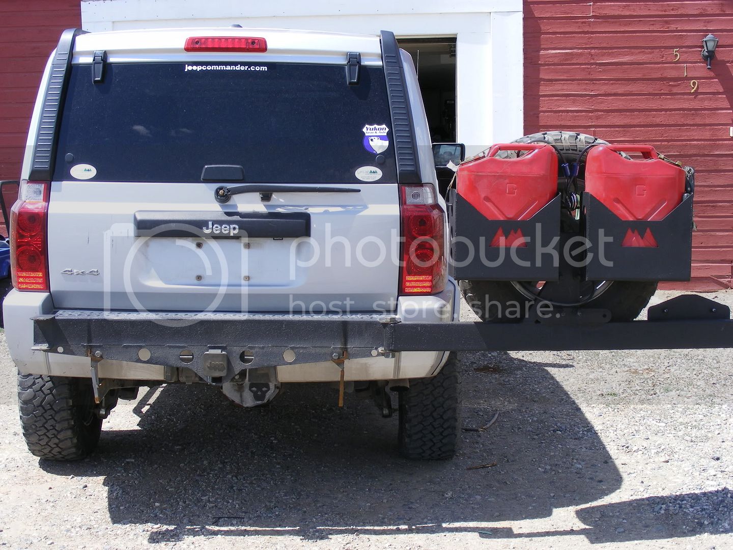

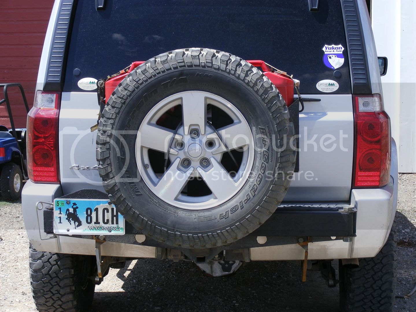

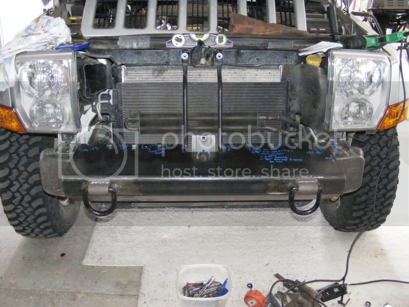

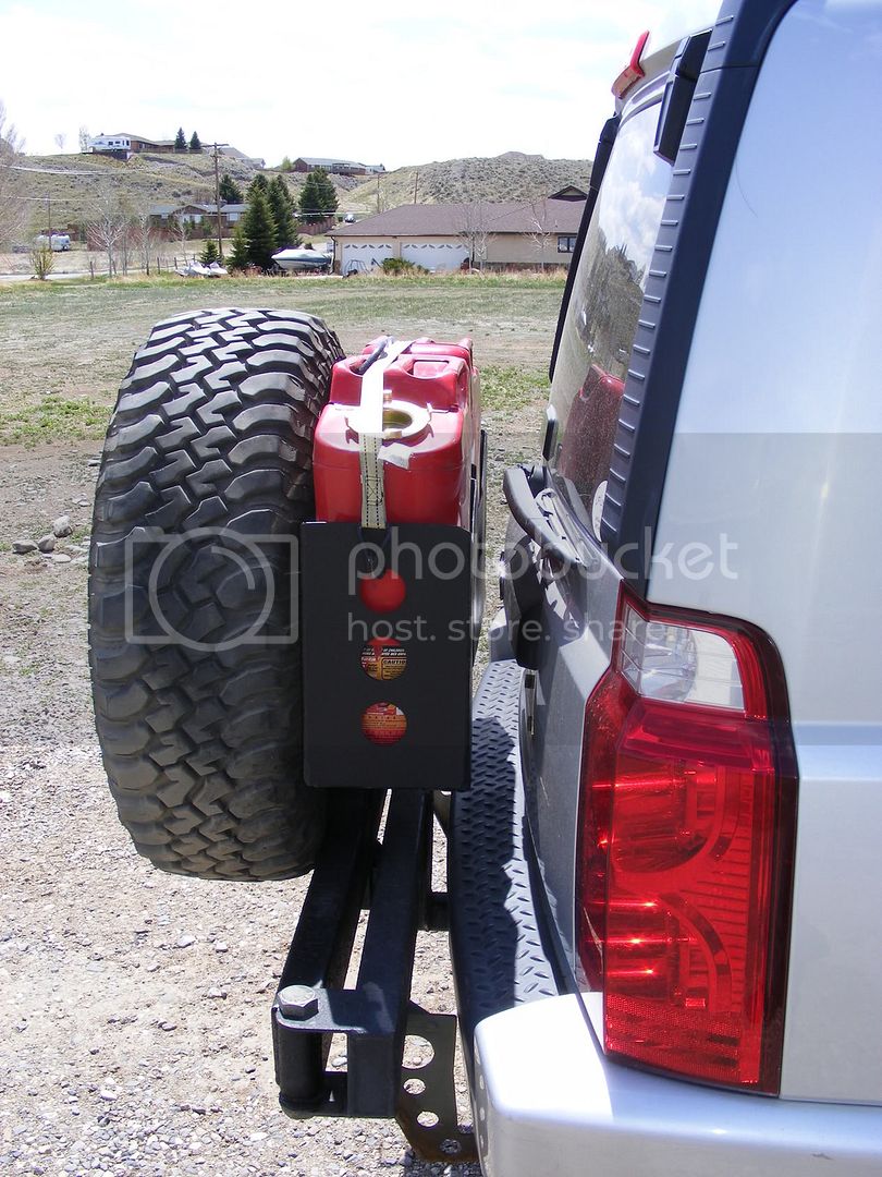

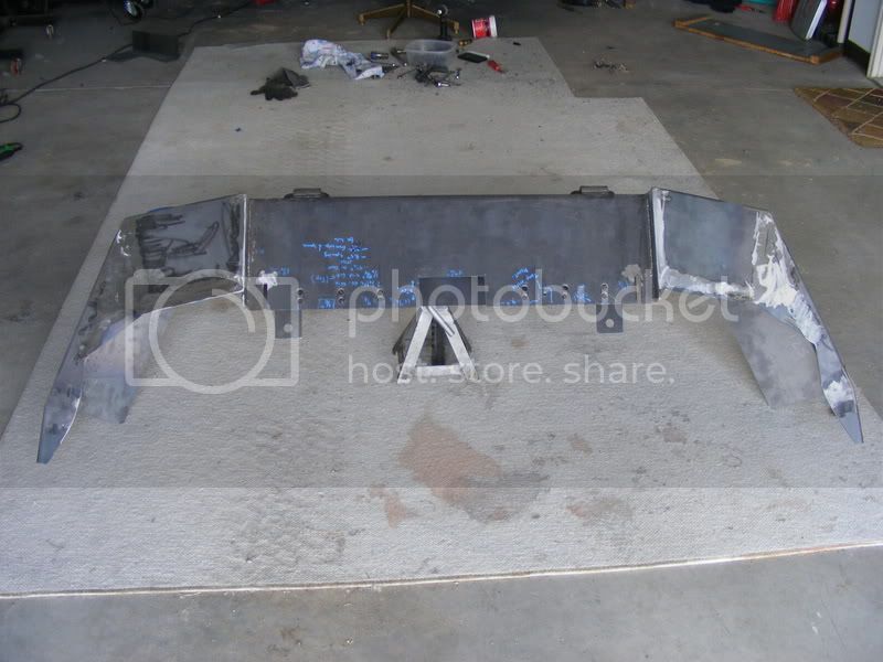

Next up was figuring out how to carry a full sized spare tire. I added weight of a bumper was not really desired. and trying to get something that would hide all the emissions junk behind the stock bumper was not going to be easy. so i took some measurements and started working with those in AutoCAD. It came out pretty nice, i can carry 10 gallons of fuel on the back, a full sized spare, highlift jack, and shovel.

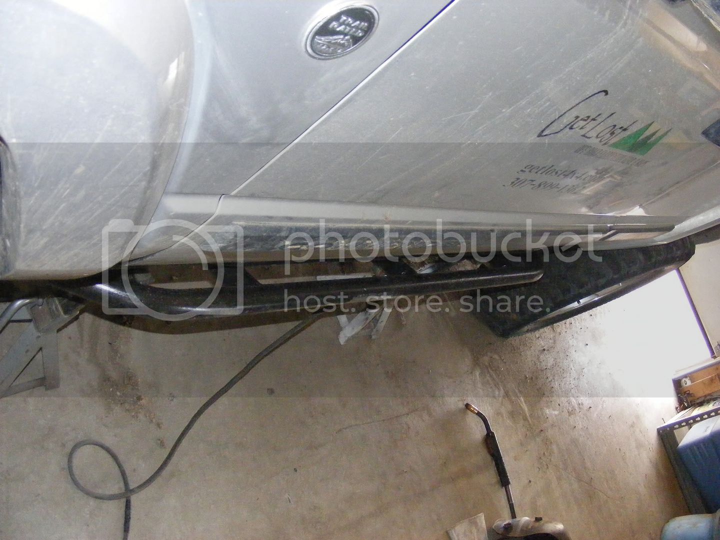

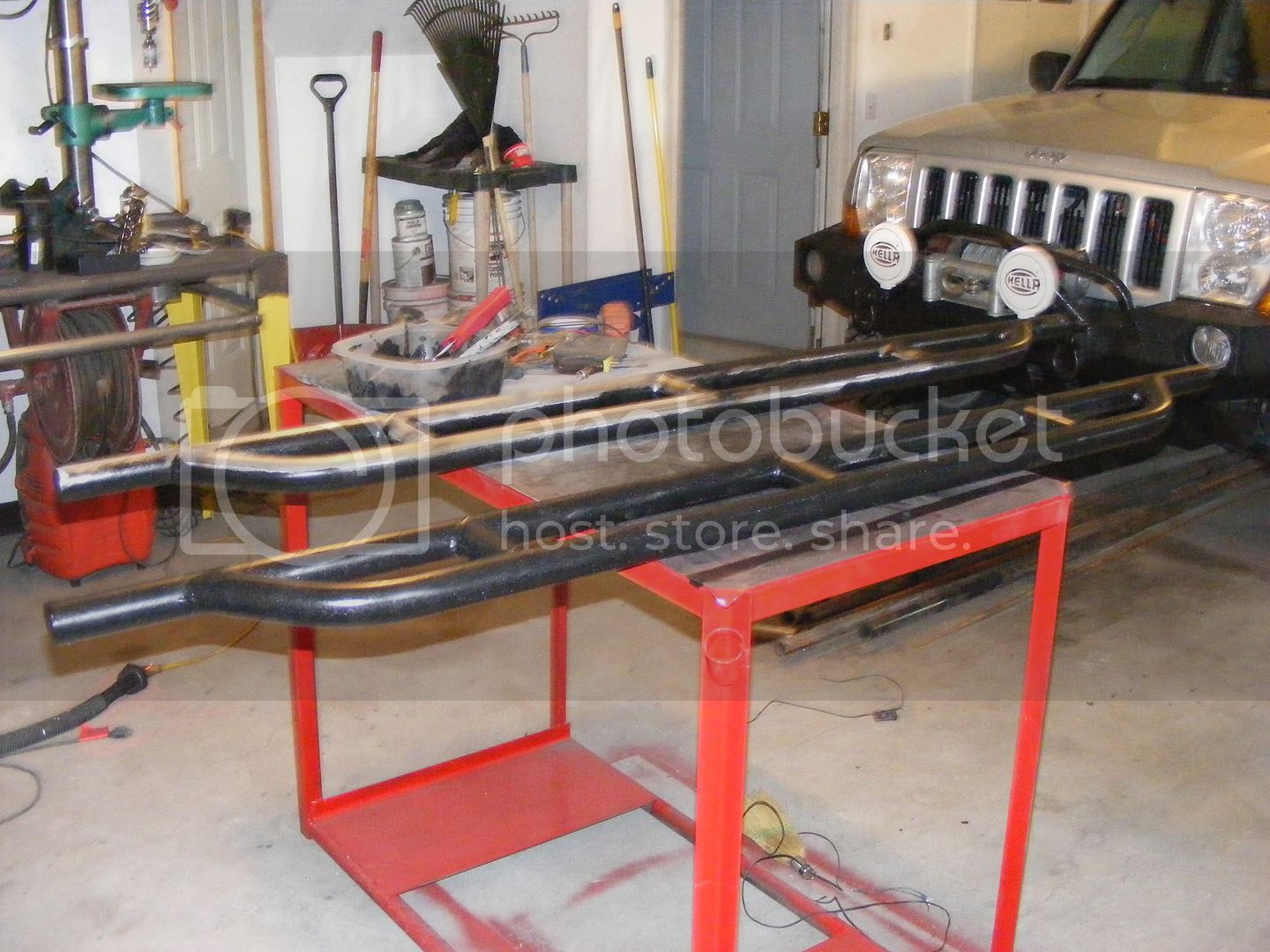

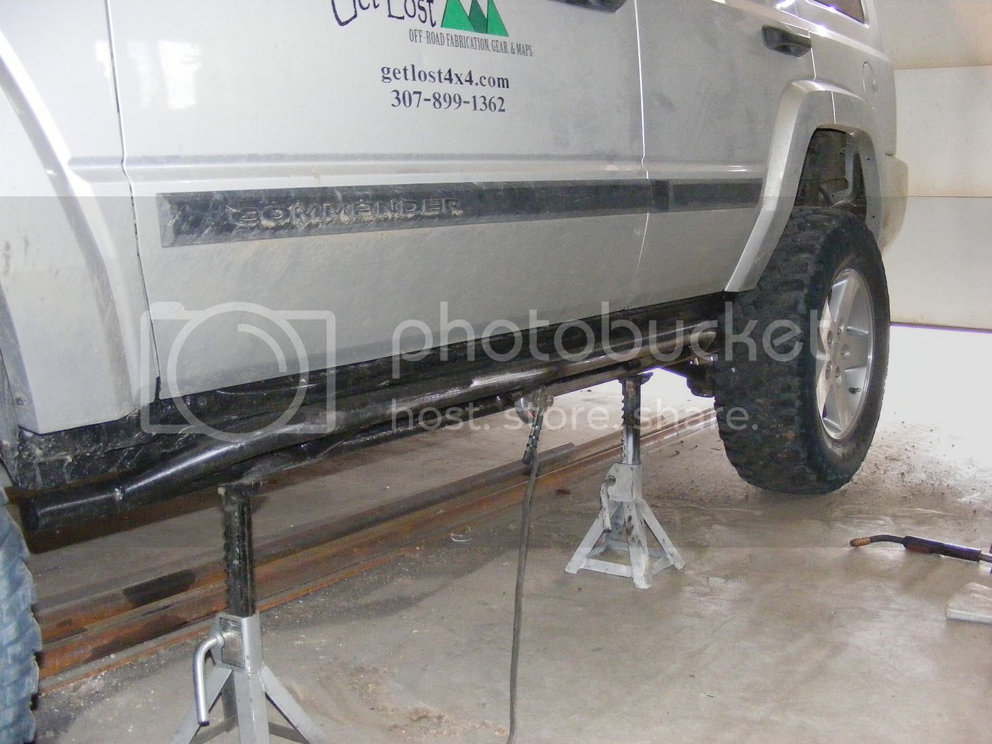

I wanted some rocker protection, i didn't like what was on the market, and i have a tube bender and notcher. I built a simple design and welded them into the "frame rails". I used 1.75" x.120 round tubing, i sleeved the tubes coming off the frame with 1.5"x.120 so they are effectively .25" wall thickness on the tubes. The rockers weigh about 50 lbs total. I also plated the frame with .25" where the rockers attach to help strengthen the frame and keep the rocker guards from being ripped off.
Finally getting around to redoing and posting the results of rebuilding the storage compartments.
i got rid of the 100 lbs metal box and replaced it with this new storage compartment built out of MDF. it only weighs 15 lbs. it also provides easier access to stuff in the box because there are 3 compartments. i can now just move crap on top to one side to get stuff out of a compartment. before i had to empty the whole back of the jeep to get anything out.
Read more here:
http://getlost4x4.com/?p=401
Commander Storage Solutions! Part??? – Get Lost 4x4
makes a great sleeping platform.
